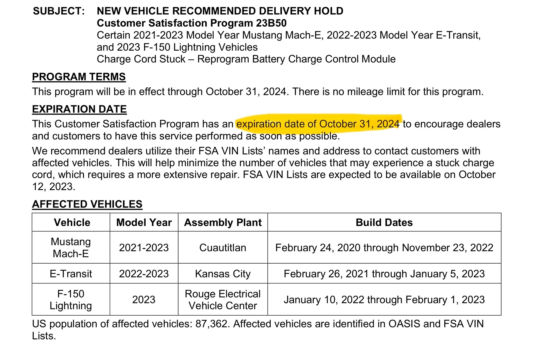

Yes, I just checked my VIN on the official Ford website, and it shows that there is no active CSP for my vehicle.
The other thing about CSPs is that they expire. This one expired in October 2024 so it won’t show up any more. They did list a range of manufacturing dates so if yours falls in that range it may still have the bad version.

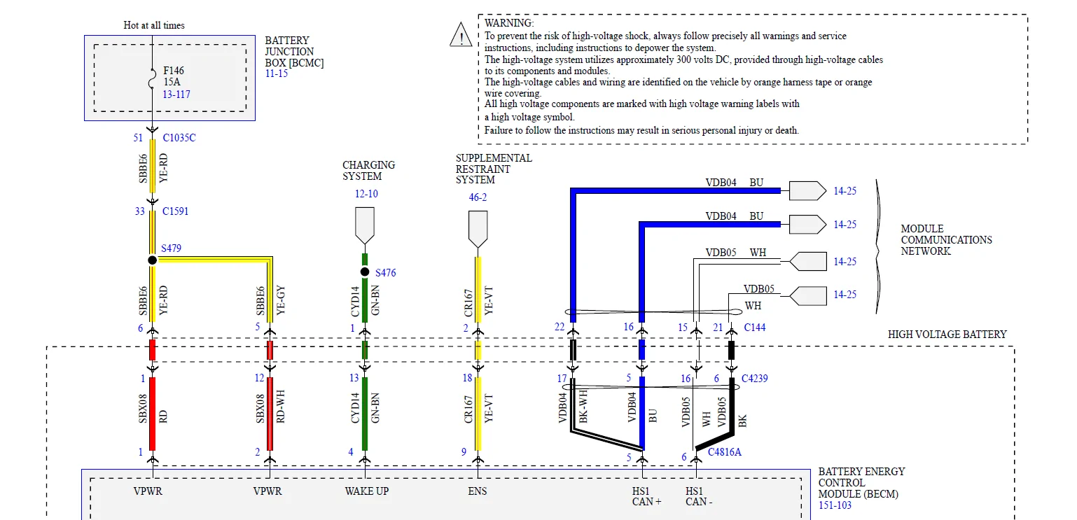

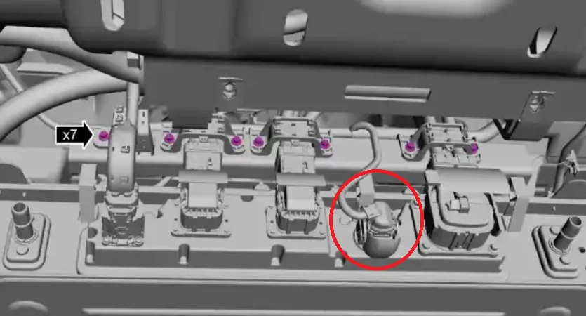

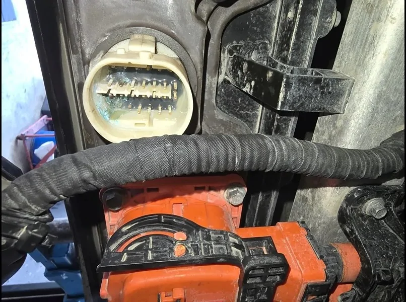

OK, You're original post said "U019B – Lost Communication With Battery Charger Control Module (BCCM)" now you are saying "U0111 – Lost Communication With Battery Energy Control Module (BECM)"
These are two completely different things. but may have a weird relationship. The HV Battery (which contains the BECM and is (for all intents and purposes) the BECM) has a weird CAN connection in which they have 2 CAN connections that are made within the housing of the BECM. This means that when you unplug the HV battery low voltage connector you are essentially splitting/disconnecting the CAN bus.
Ford F-150 Lightning F150 LIGHTNING 2022 LARIAT /CODE U019B Fixed post #45 1765238518761-bq
This is done to eliminate star topology in the CAN bus, but also done strategically in some cases to keep things on either side from communicating if the connector is unplugged. Unfortunately this doubles the failure statistics of that connector.
Ford F-150 Lightning F150 LIGHTNING 2022 LARIAT /CODE U019B Fixed post #45 1765238282747-r0
What you need to do is get a good can of electrical contact cleaner from your local auto parts store. CRC brand is my fav, but any will do. Power washer works good too if you have that available, or want to remove the Battery Connection Protection Armor Plate and drive to a car wash. Clean the heck out of this connector on the front of the battery before you unplug it,, then Unplug it, and clean both sides again with the contact cleaner.
Visually inspect both the socket and connector sides for any obvious issues.
Pay particular attention to the twisted pair blue and white CAN wires. You can remove the wire loom protectant and inspect back a few inches of the wire harness.
Once everything is clean and good, lubricate the gasket mating surfaces with WD-40 or any other non-conductive lubricant and re-seat the connector.
Clear all DTC's and I bet you'll find that you're good to go. Let us know.

Thank you very much for pointing me in the right direction and helping me identify where the problem could be. You were absolutely right — water had entered this connector and caused carbonization on two of the pins.
Unfortunately, the issue had to be repaired rather than replaced, as there is no official Lightning service available here in Europe. With the help of several experienced EV specialists, the connector was carefully repaired, modified, and fully sealed with 100% waterproof insulation.
I’m happy to say that the truck is now running perfectly with no issues at all.
Thank you again to everyone for the support and guidance
