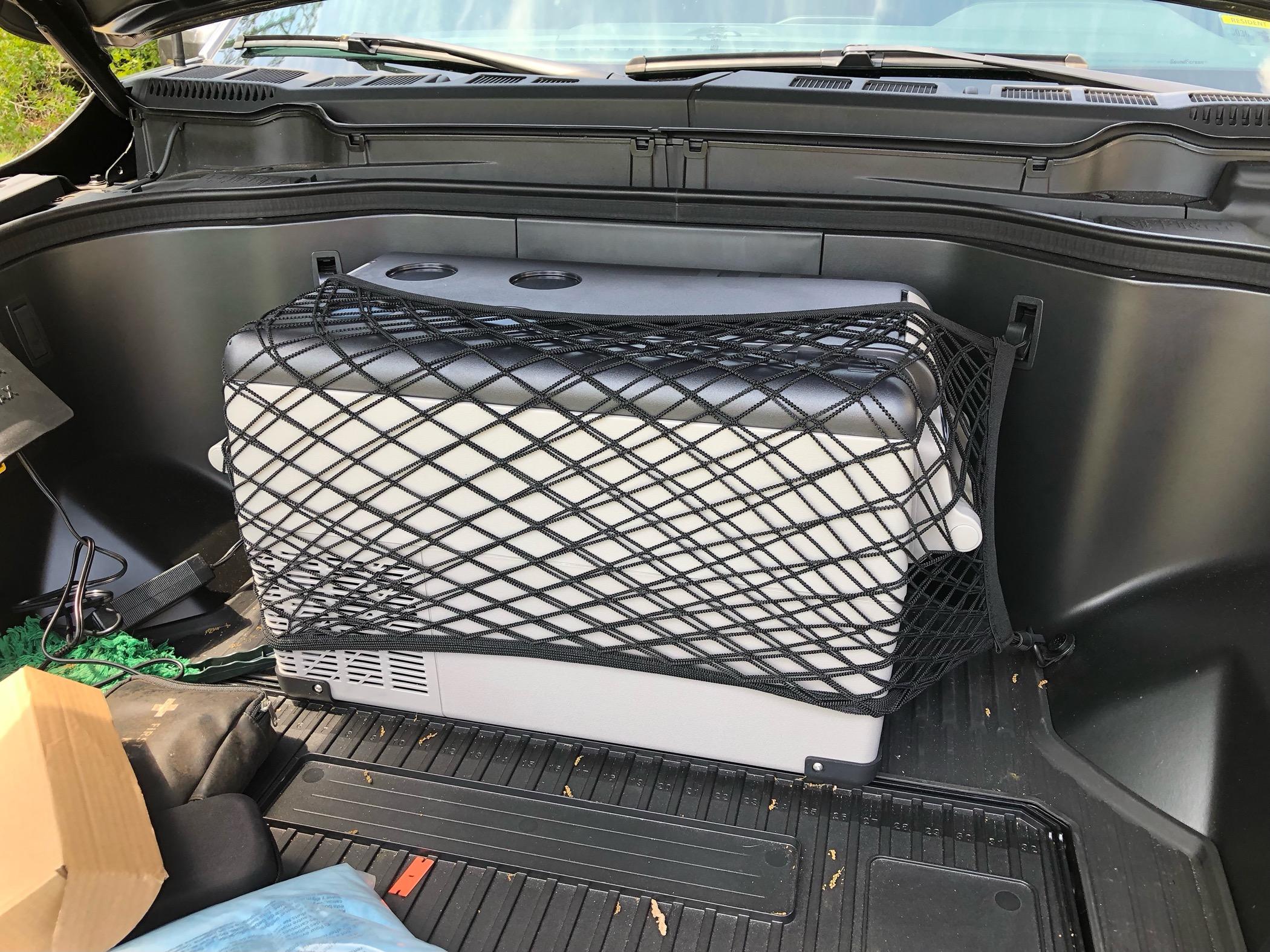

Do the outlets in the frunk work while driving? About to take a long trip and thought about plugging in a small cooler.

Yes, but they are limited to 400w.

The frunk outlets on my Lightning note maximum load 20 amps/2.4 kW.

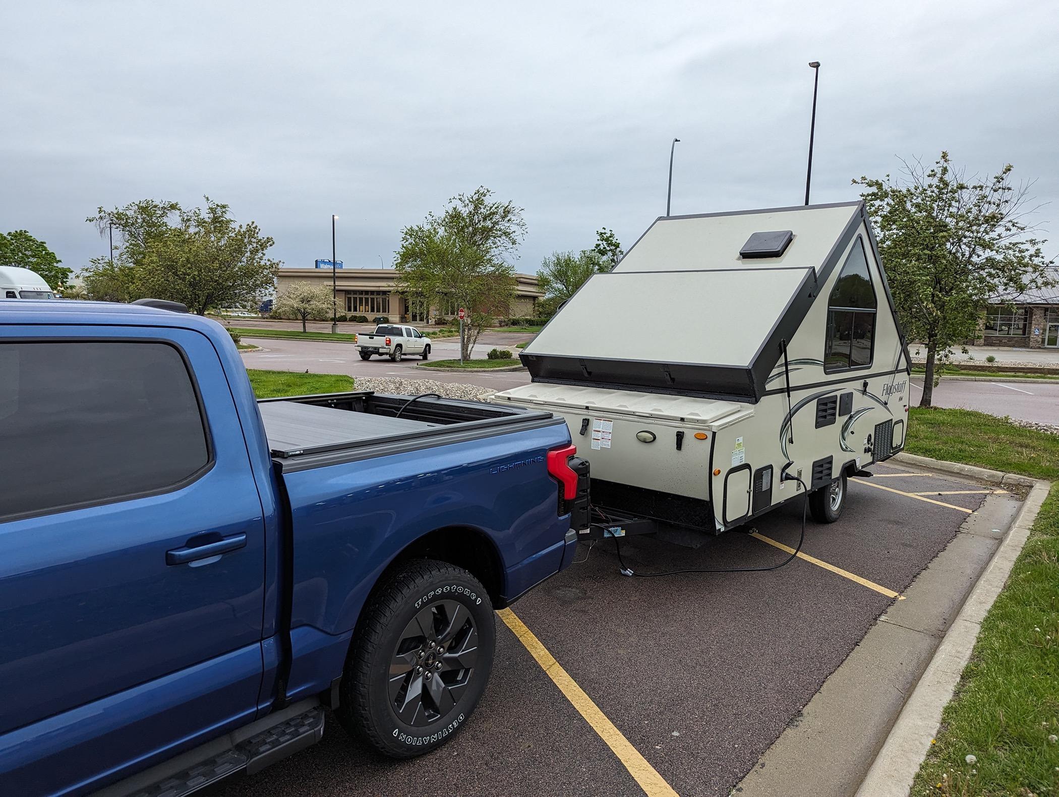

no, only the Frunk outlets are limited... I tow my camper and POWER it from the bed while traveling, with no issues, even if needing to run the roof air conditioner, fridge, water heater, fans, etc... if you have the optional 9.6kw ProPower output, all those rear bed outlets are 30amp output each, or 4 @ 120v and 1@ 240v... up to 7.2kw combined(60 amps @ 120v equivalent)...

...I tow my camper and POWER it from the bed while traveling, with no issues, even if needing to run the roof air conditioner, fridge, water heater, fans, etc...

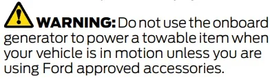

Do you know anything about this warning from page 186 of the 2024 Ford F-150 Lightning Owners Manual?

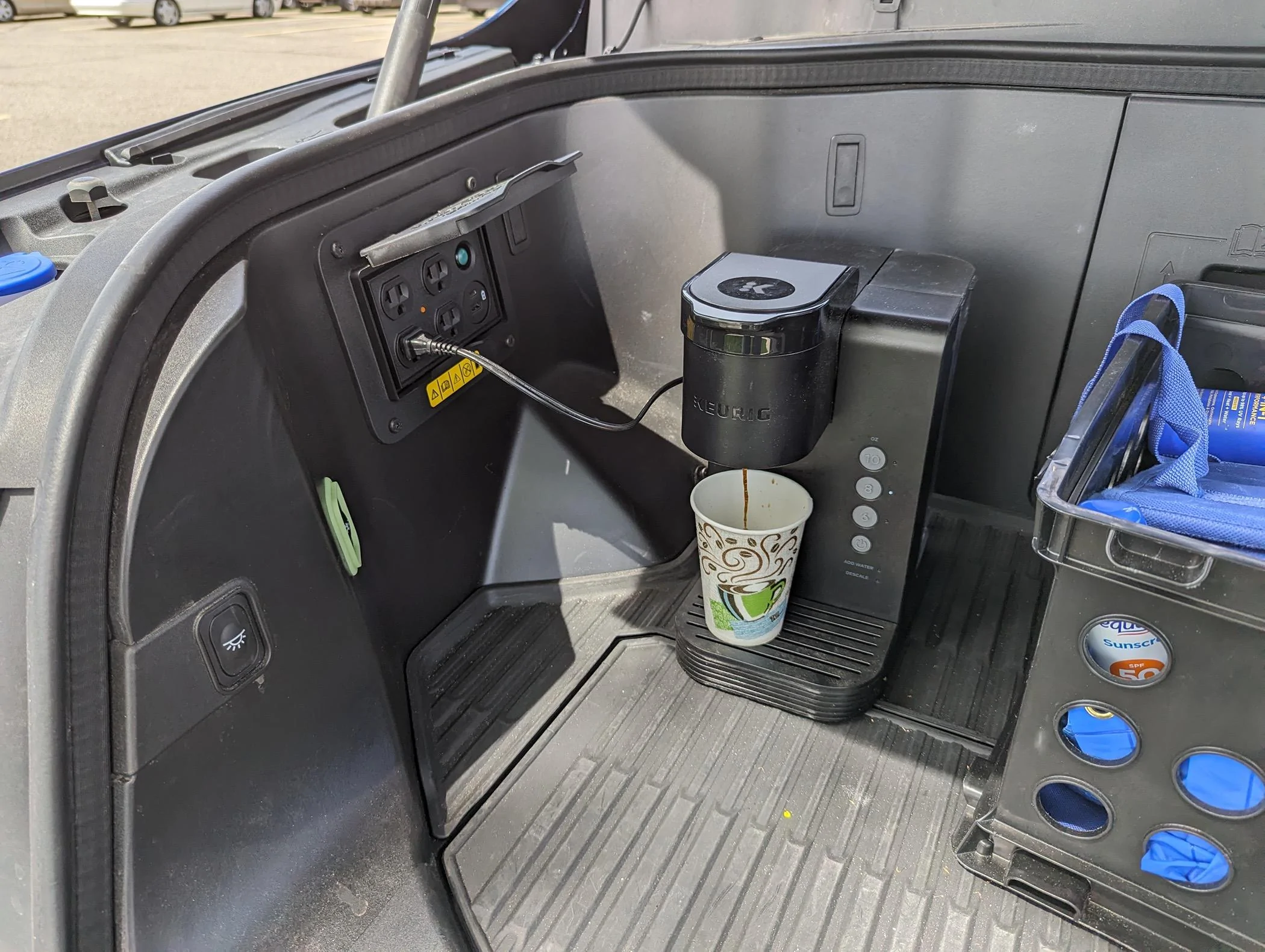

PPO is great. I use it to power the coffee maker in the frunk, internet in the bed, and camper sitting behind the truck. It’s powering the connection I’m using to post this from North Platte, NE. I wish I didn’t have to keep the truck running, but it’s a heckuva lot quieter and easier than running a generator.
The frunk outlets are good to power a cooler while driving, but I’d suggest getting a decent 12v unit if you’re doing this often. I wish there were a way to keep the 120v outlets hot all the time
