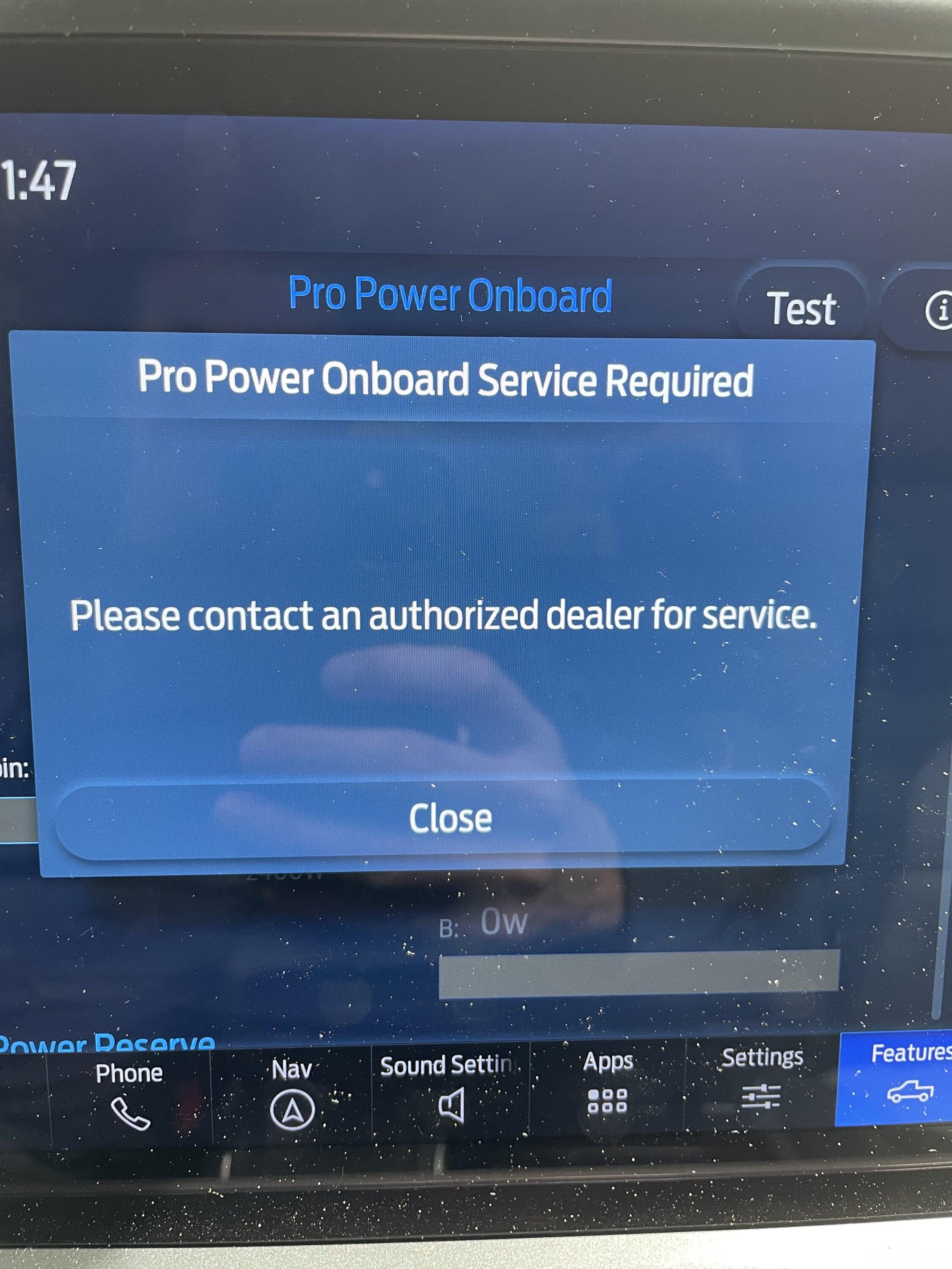

Great. Owned the truck less than 24hrs. Never even tried to use it yet. Couldn’t reset it and it never got wet.

Curious to know what they will repair/replace to fix this issue.
Hey there! Can you please send me a DM with your VIN and dealer name/location so I can look into this Pro Power error message for you? I'd be happy to see what I can do to assist!

Thank you!! The truck is in the shop today. I’ll let you know what they find out if that was the cause. Thank you so much.

To do that they have to unplug all the connections in the bed and I bet they didn't get something fully seated. That's the source of your fault
Dealer just called and that was the problem. It got unplugged during the bed liner install.
