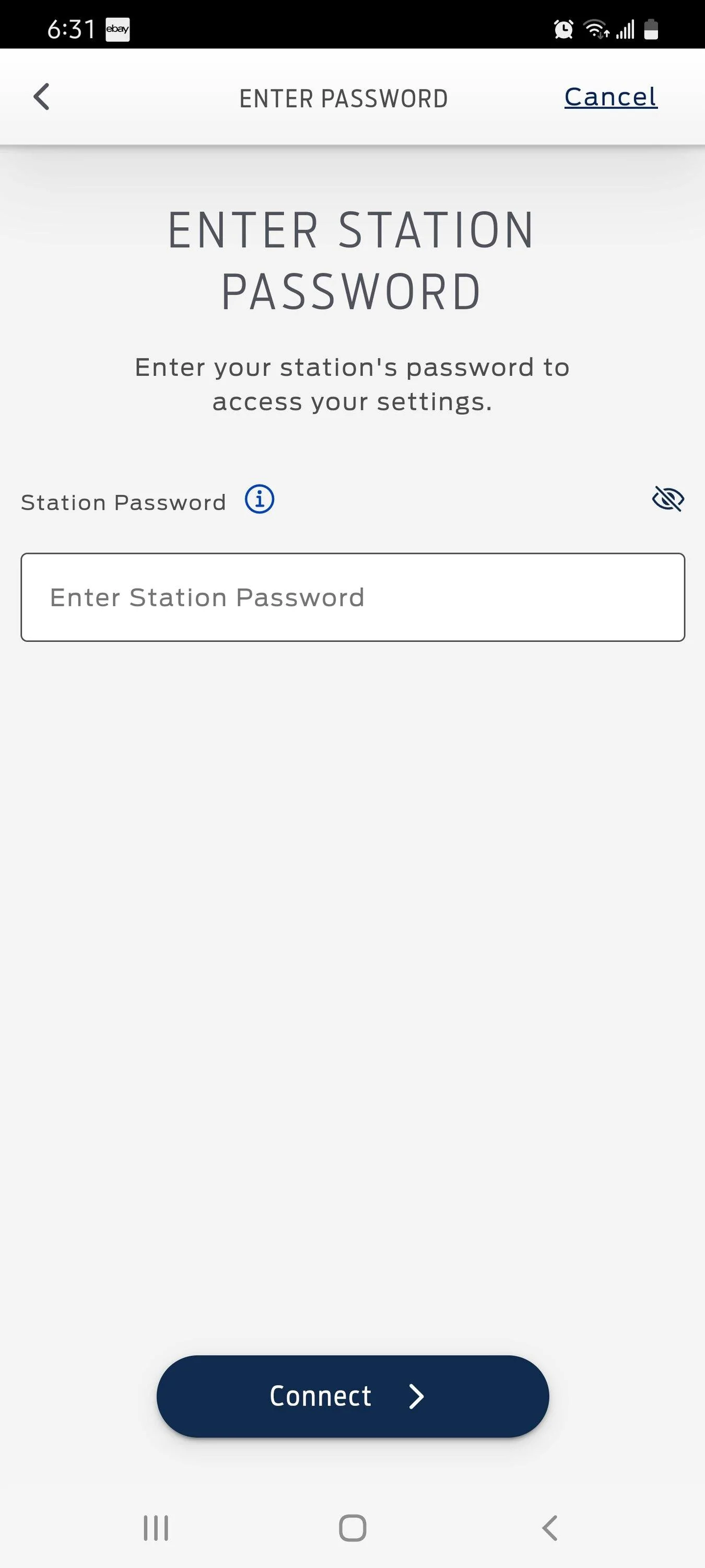

The "access code" is your password. In addition, the font used isn't very good, so the letter "capital I" looks like the letter "lowercase L" looks like the numeral one. Likewise you have to be able to tell the difference between the fatter "capital O" and the numeral zero.
If you are getting the ChargePoint not found error, you need to go back and do a factory reset. But instead of linking to FordPass immediately after using the setup app like the setup app wants you to, you must wait 5 minutes.
If you mash the button too many times and get put into the 15-minute penalty box for trying too much, then the charge station will not register with Siemens' VersiCharger cloud and you'll have to do it all over again.

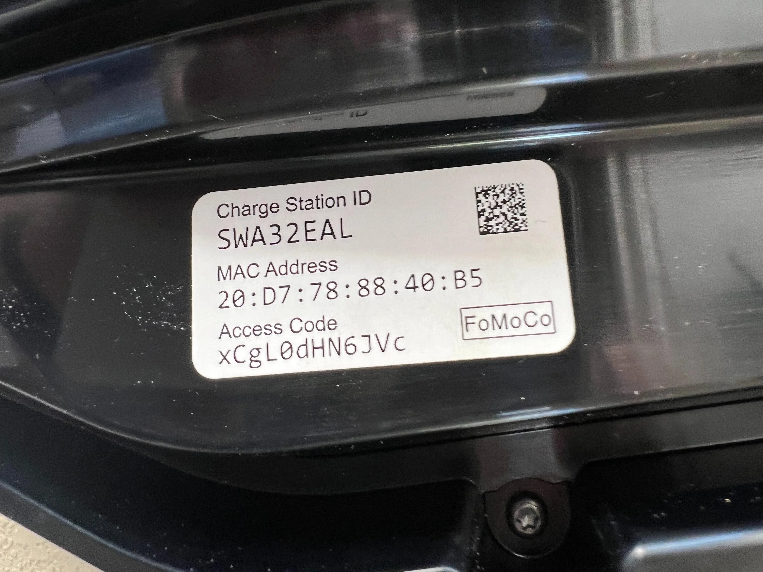

So I bought my Lightning used and the previous owner had installed the wall charger. When I picked up the truck months ago I didn’t get any passwords and the box + installation instructions were long gone. Don’t know if it was ever reset. Will I be able to use it at all without the connection to the Ford Pass app? Is there a separate app for the charger?

Take the cover off. IIRC, the password is on the label inside.
If you take off the gray cover, you should see all the information SSID, Password, Mac address, etc. Below is what mine looks like inside the cover.
