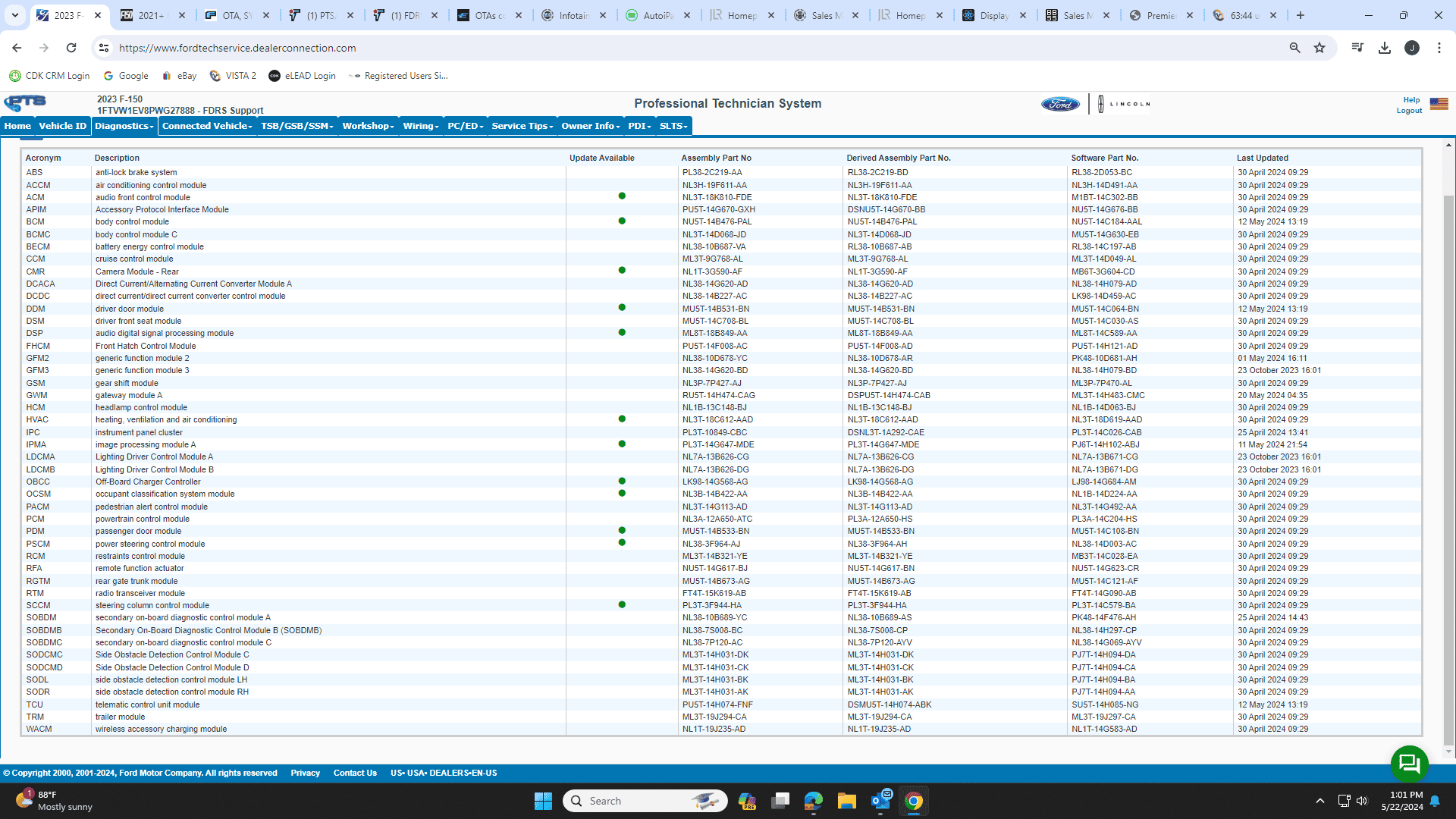

I have been lurking but just make this account. Im sorry for asking this is for a new truck 1FTVW1EV8PWG27888
I was hoping I can use the tesla super chargers but it appears I might not be able to until I am updated?
Can anyone let me know if its possible with my current software to use the superchargers?
Thanks in advance

You can use the superchargers (version 3&4 only) if you use the Tesla app to activate the charging station until you get the plug and charge update. (You will also need a NACS to CCS DC charging adapter as well).

List below shows most of the modules on your truck that have pending updates. The OBCC is the update you are looking for and it is showing for you.

PTS shows the modem was properly activated when you bought the truck about 2 weeks ago and no updates have been sent yet. Your are on Sync 23159 which is one version behind the latest available. Modules pending updates are below, buy you also have APIM, GWM, TCU and an IPC update available that is not showing below.

Besides buying FDRS and doing myself do I just have to wait for OTA for all these modules to update?
Also if you know, what Sync version does the battery percentage on the main dash come? Guessing the one I don’t have?

That come with IPC update 6.8.0. It is virtually impossible to tell where you are in the OTA roll-out process based on just looking at that list, but if I had to guess, you're still on the 4.x.x updates and a long ways away from the OTA process getting you what you're looking for.

Sorry for my ignorance. Does that mean only way is FDRS or dealer installed? How would that work if the image you showed doesn't even list an update for that module? Or am I just end a waiting-only game?

No, it just means that PTS not showing module updates for certain. They will come in via OTA as well. I only disclose that to make people aware that that list does not show everything that is missing to be fully up to date.
