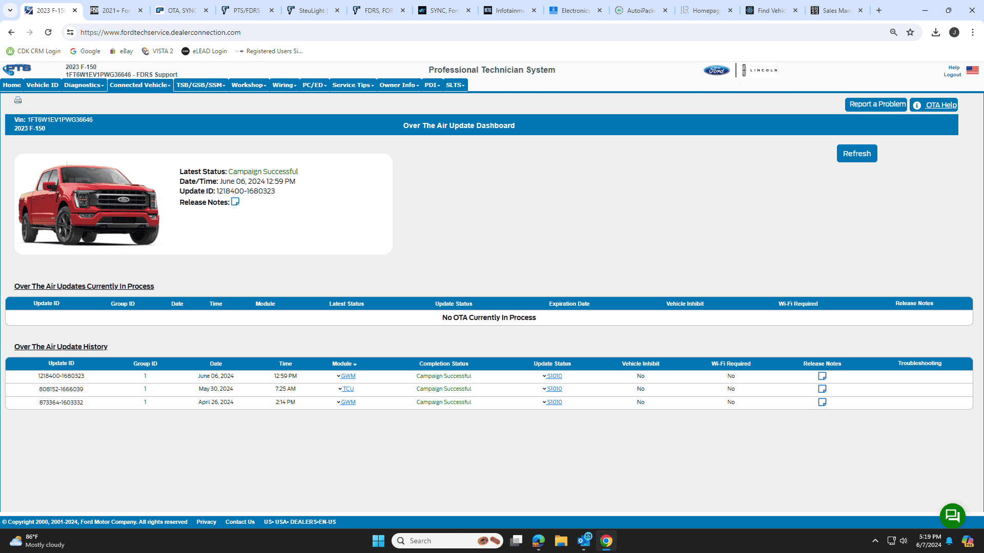

Could you run mine again? I received updates directly after the last check and have stalled for quite a while.
OTA history is below. Nothing has been sent to you since late April. Nothing to worry about; that is just how these things work.

Forgive my ignorance, but what's the relationship between the models that need updating and the OTA updates we get occasionally? For example, I just got 4.2.3.1 and I assume that contained one or more of the modules from the list you provided me earlier. However, in the list of modules awaiting update, none of them had anything that looked like 4.2.3.1. Is there a listing somewhere of what modules are contained in any given OTA update?
I hope that makes sense.
rugedraw
rugedraw
Javier
Dec 14, 2021
1,920
2,364
Miami
Auto Sales
The update you got yesterday was for the GWM. While the OTA's do corollate directly to whatever modules you have pending, the details you see on the screen after an update do not tell you which module it updated I can see which module it updated with the access I have.
Unfortunately, there is no up to date listing for the Lightnings. I blame myself as I have been too lazy to do it.
