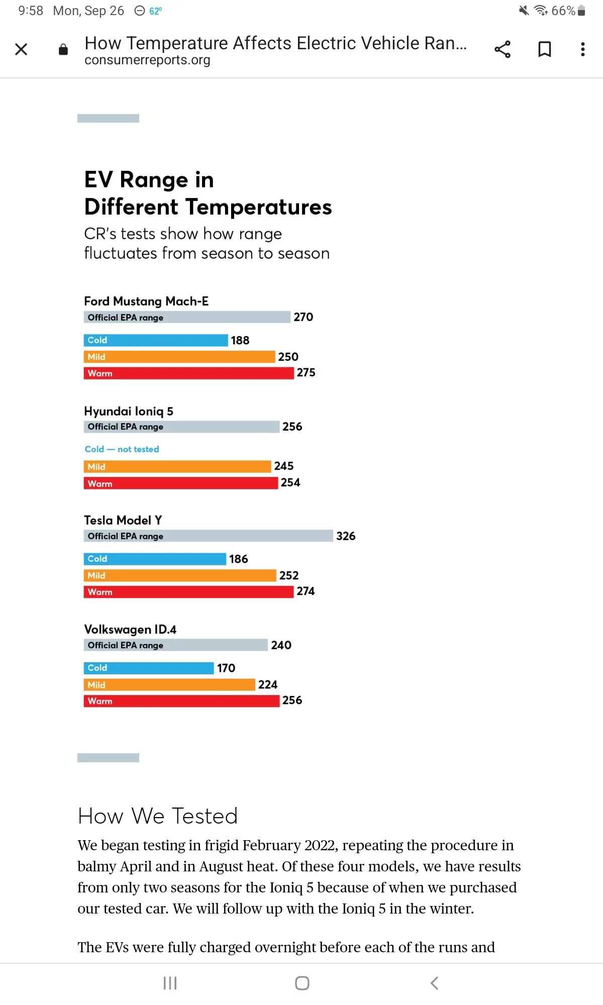

Facts, not hyperbole. Full article at CR, which you should be able to access via your library's website.
Ford F-150 Lightning Read before you order! Expect 50% range loss in winter in Northern states. Screenshot_20220926-215836_Chrom
Exactly this, testing is not showing the benefits of heat pumps working out in the real world for cars.
