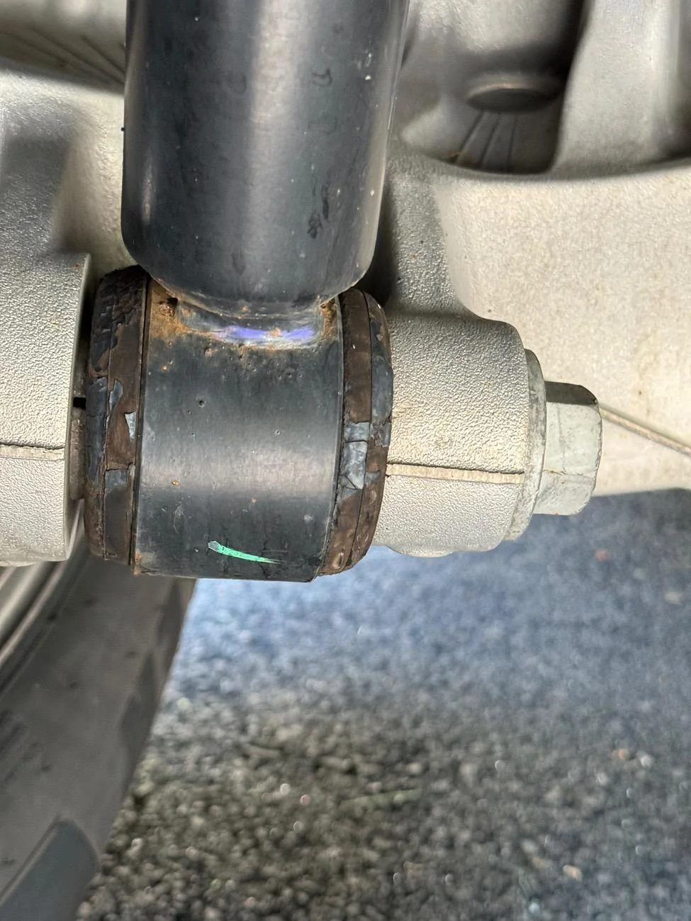

I had to replace the AT Hankook tires because the exterior side of the tires was completely worn out. This was at 24k miles. I asked to complete an alignment after replacing the tires and check the suspension components. This was at a ford dealership.
When I got home, I decided to check if they had made any adjustments, and there were no signs that any adjustments were made. (Mark on tie rod and bolts were still intact)
So I decided to check the rest of the suspension components, and the majority of bushings are peeling out.
But the rear shock seems to be in the worst condition. It looks like it is not even centered on the bolt/bracket. Should this be fixed?

The shock alignment is perfectly normal. That sleeve can slide in and out to allow the shock to come out and go back in. If you ever have to remove and replace the shock you will understand.
I do not believe that to be correct. The force on the lower bolt will increase if there is a shift to the right or to the left.
