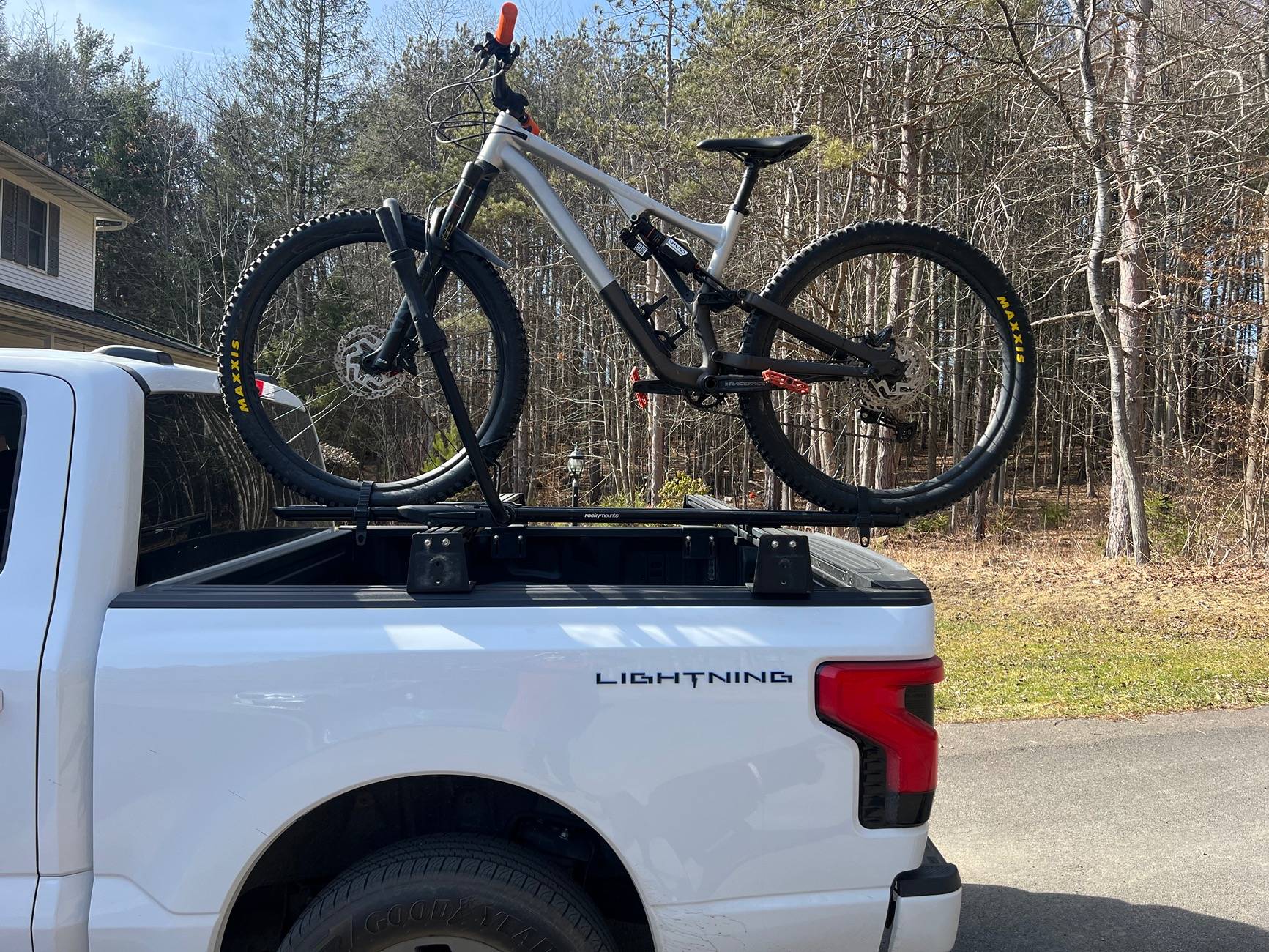

The cross bars are made by Billie Bars. The bike rack mounted to them is a Brass-knuckles bike.
