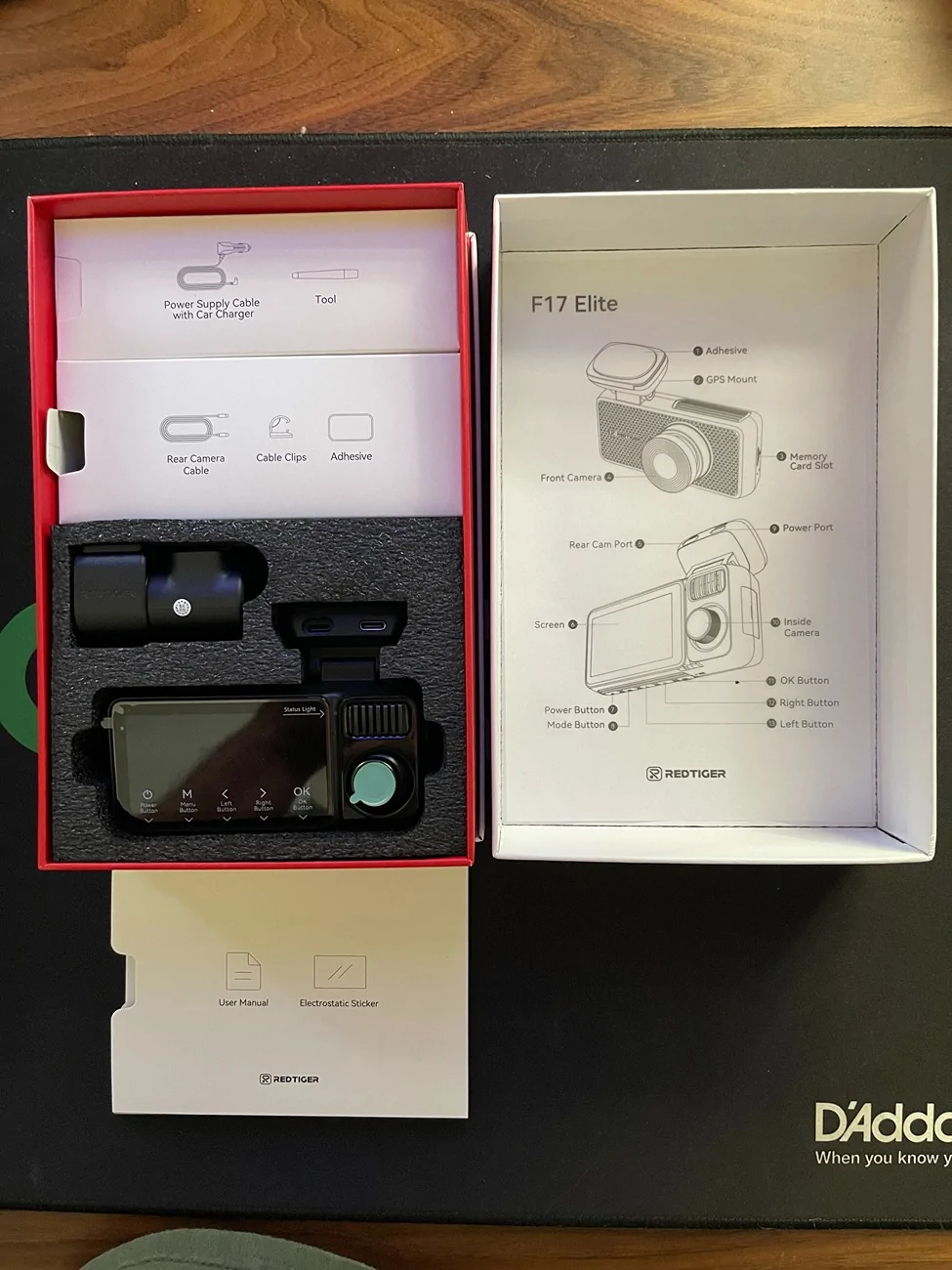

The F17 Elite arrived via U.S. Postal Services a few days before the expected date. The dashcam and hardwire kit were enclosed in a light-gray plastic shipping bag. After opening I saw that the dashcam box had a small dent in one corner, but there were no issues with any of the contents.
The dashcam was in a box, and the hardwire kit was in a separate bag.

The F17 Elite box is well organized and provides a great "unboxing" presentation. You're first visual is a vellum-like transparent diagram of the F17 Elite dashcam. Lifting that out you're presented with the hardware on the bottom and the instructions and accessories, in three separate boxes, on the top.
Ford F-150 Lightning Redtiger F17 Elite - Installation and Review 012
The instruction box contains: F17 Elite User Manual, APP Quick Book, and four electrostatic stickers used for mounting the front and rear dashcams.
The other two boxes contain:
- Power supply cable with car charger and trim push/pry tool
- Rear camera cable, cable clips, and adhesive

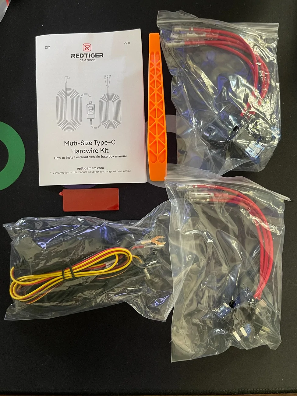

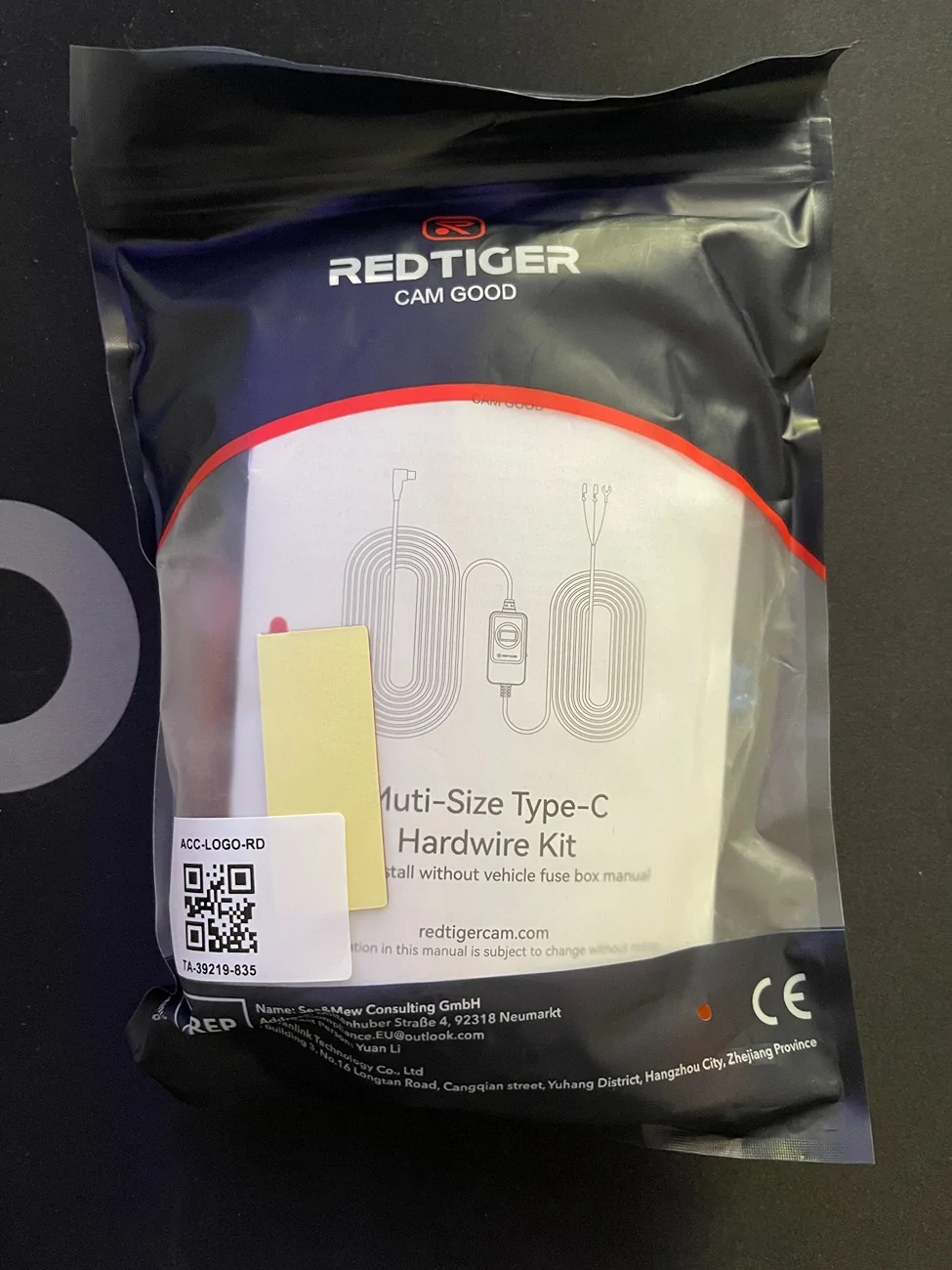

I opened up the hardwire kit and quickly read that manual. The hardwire kit includes a voltage sensor, with display, that you can set to automatically turn off the camera in undervoltage situations. I set this to 12.4V. This is handy if you use the "parking mode" and will keep the dashcam from depleting/draining your battery. This kit also includes eight different size fuse taps, a trim tool, and a piece of adhesive that you could use to mount the voltage sensor box.

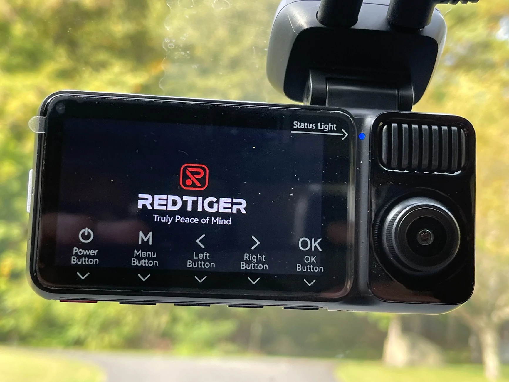

I mounted the front/cabin dashcam in the center of the windshield, just below the mirror. I may go back at some point and move it even a little bit further down; I can see 85-90% of the camera unit, but the bottom of the mirror obscures the top edge.

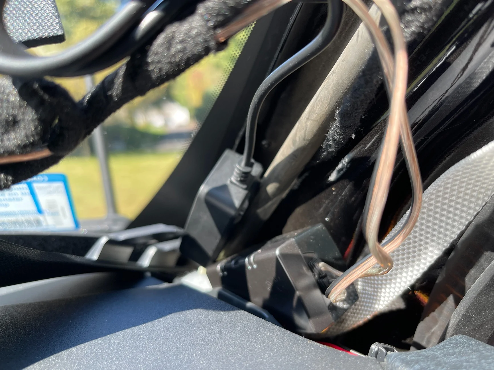

The power cable from the hardware kit was plugged into the camera and then tucked into the plastic of the overhead/mirror unit. From there it went into the headline to the passenger side A pillar.

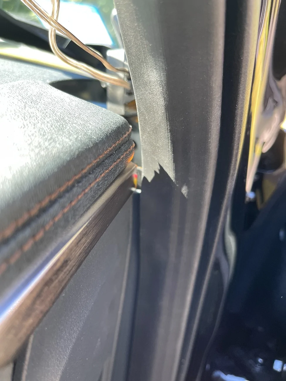

Taking off the A pillar was easy for me as I'd already done it to install new tweeters when I upgraded to Alpine speakers. You just take a small pry tool, insert it into the hole at the bottom of the grab rail, and gently pull the plastic insert out. Do it carefully so you don't scratch the trim piece. Once you start to get it out you can just pull it the rest of the way out -- be careful as the top part is connected with a little piece so it will hang in place. One you remove the insert you get access to two 10mm bolts. When those are taken out you can just pull down on the grab rail, and the A pillar trim will pop off/out. NOTE: Don't pull it too hard as the tweeter is connected and you may break the wiring. If needed, you can disconnect the tweeter wire and set the trim piece aside. I just stuck it on the dashboard while I continued.

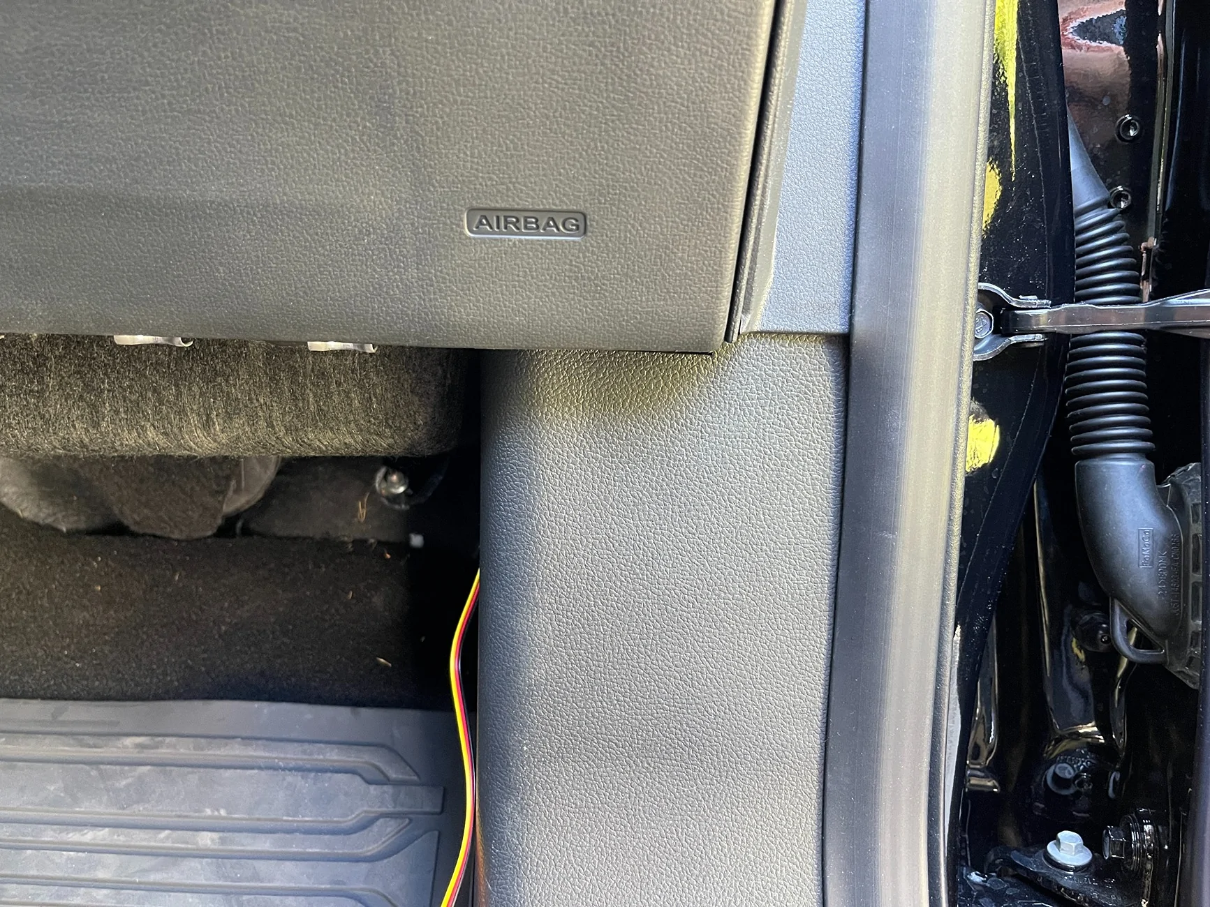

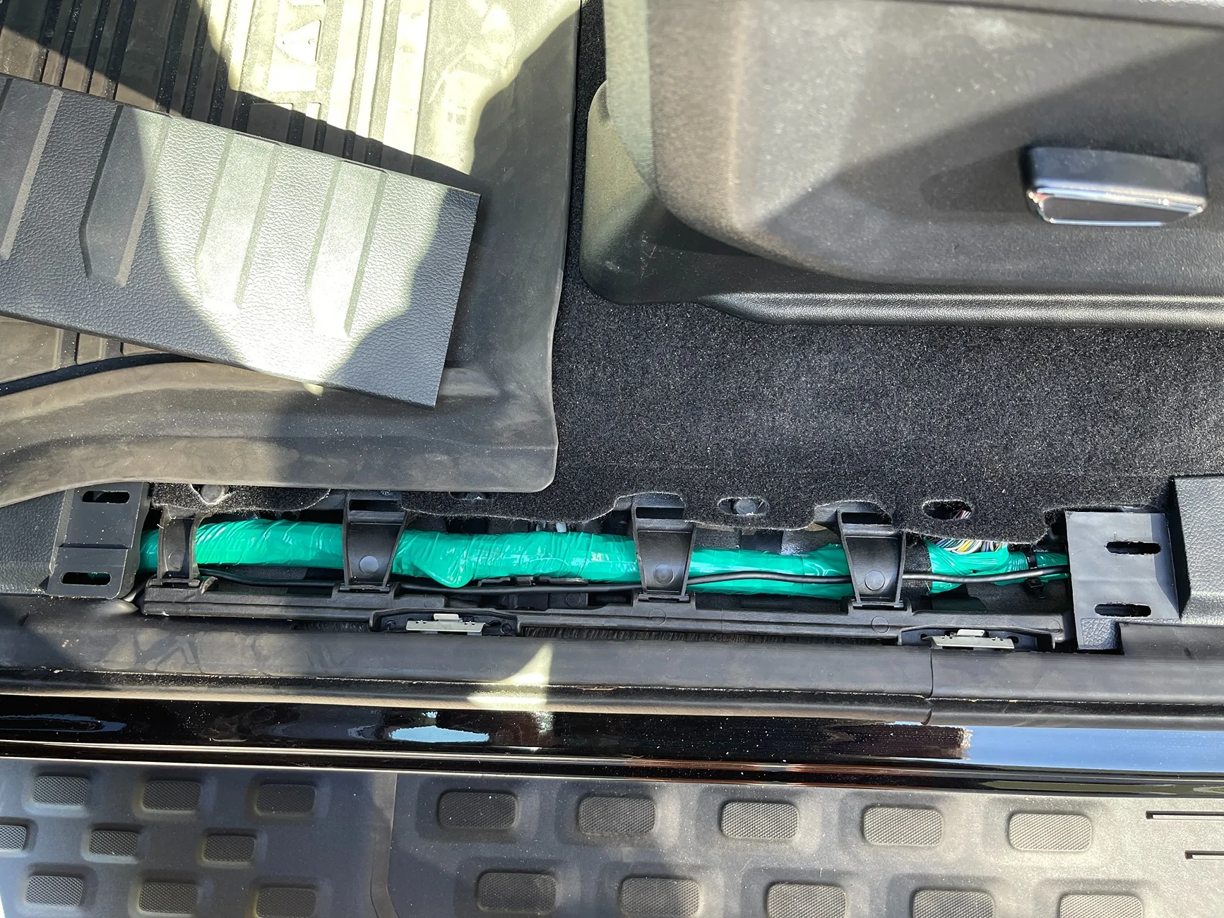

I continued by running the hardwire kit power supply wire down the A pillar, behind the metal airbag supports, where I tucked the voltage sensor alongside the Alpine crossover circuit box. It was a tight fit, but both fit. If you don't have a crossover there, you'll have plenty of room. I did NOT use the adhesive on the voltage sensor.
The wire then continues down behind the weather stripping to the passenger footwell. I used the trim tool to push the bottom panel seam so I could get the wire into the fuse box area.

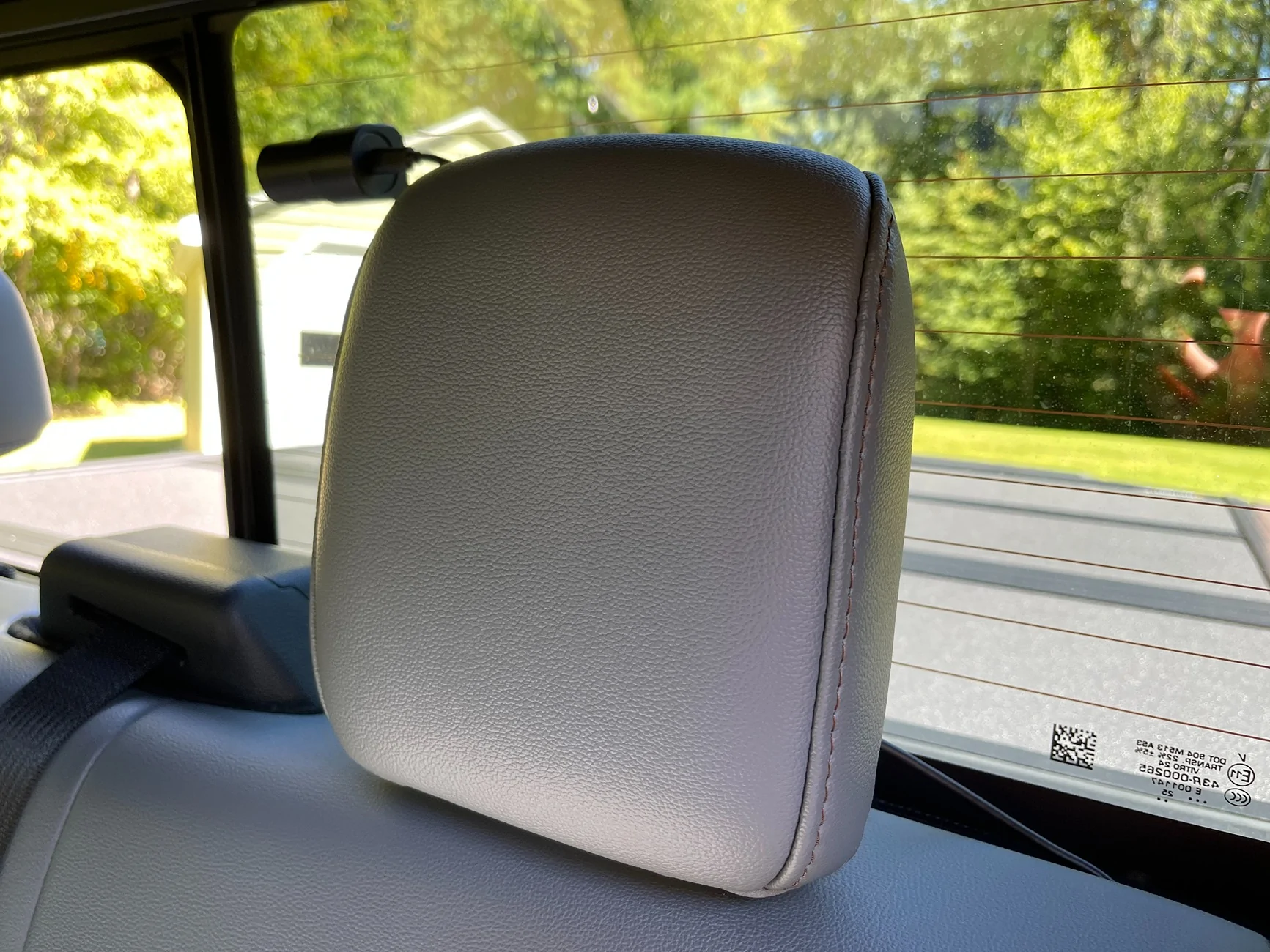

To wire in the rear camera I ran the cable up into the overhead/mirror trim; there's an empty hole there that makes getting the initial bit of wire in easier. Then across the headliner to the Driver's A pillar, down to the floor, through the kick trim channel, and to the back of the truck. There wasn't enough wire to go all the way up to the rear window headliner, so the cable comes out about halfway up and then angles to where I have the camera.
If I ever decide to move the main unit (as noted above) I might re-route the read camera cable and just go headliner all the way back.

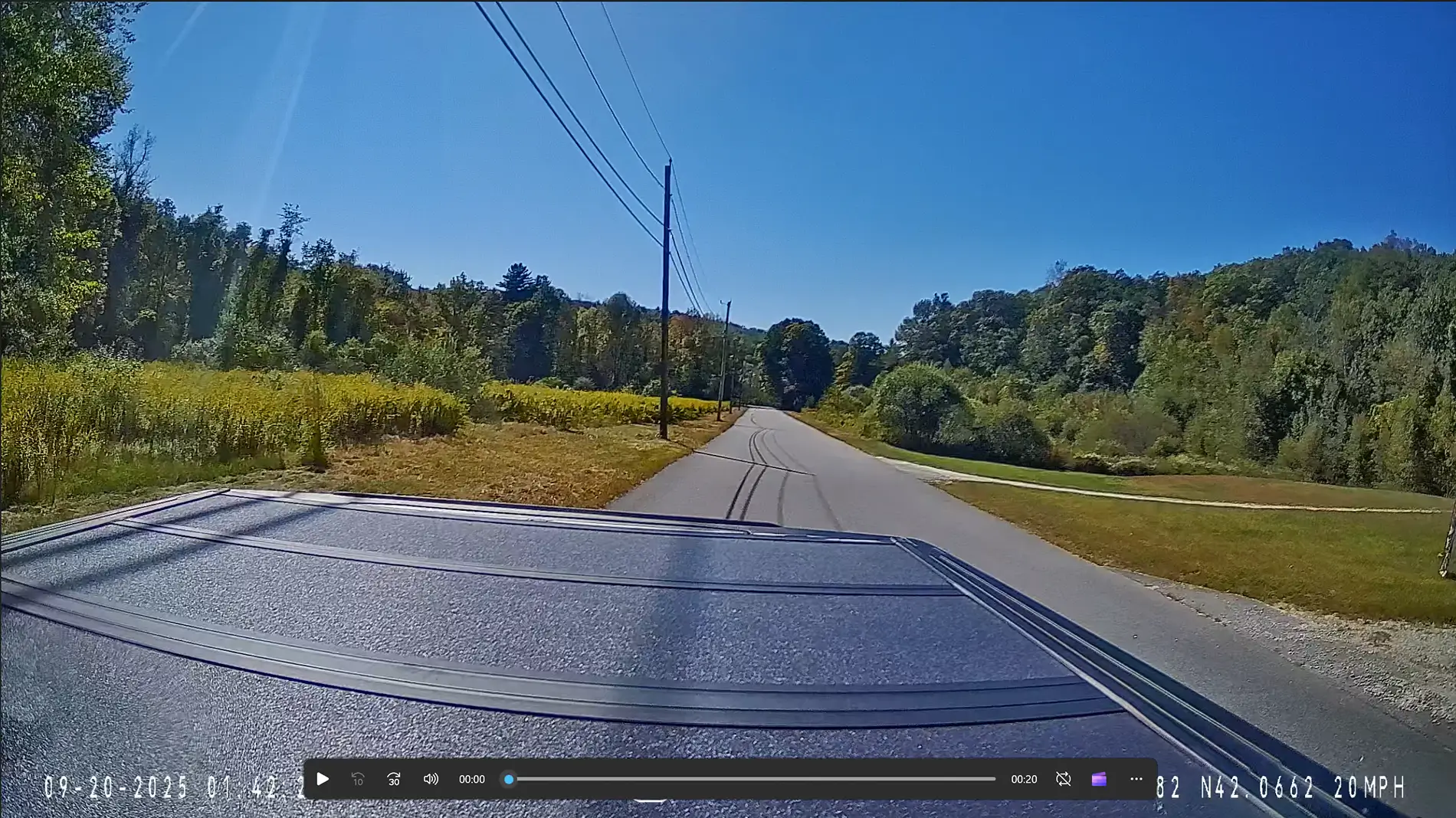

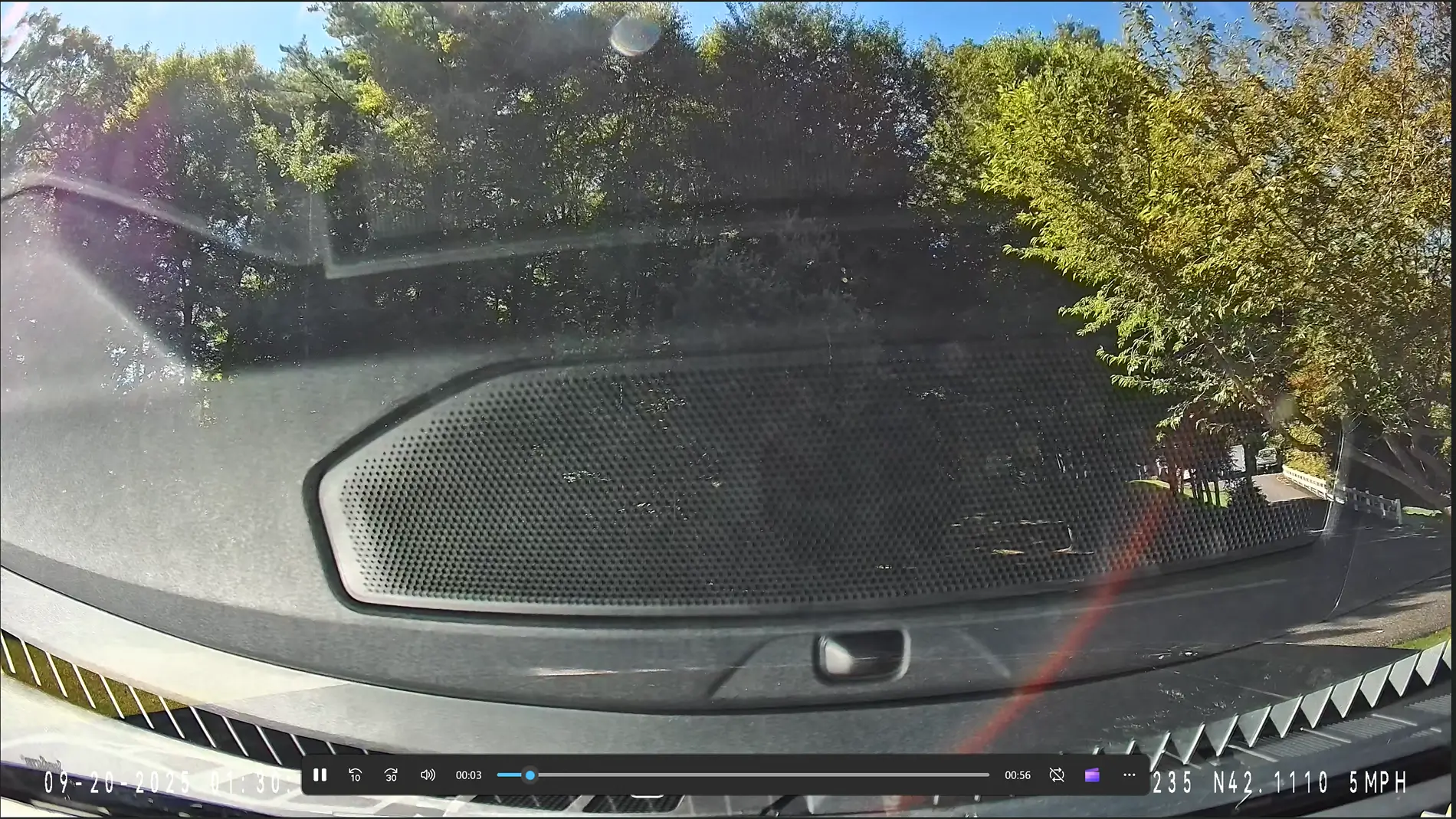

The first video I got was pulling out of the driveway. There was a lot of glare picked up from the windshield and sun.
Ford F-150 Lightning Redtiger F17 Elite - Installation and Review 1758940290452-4

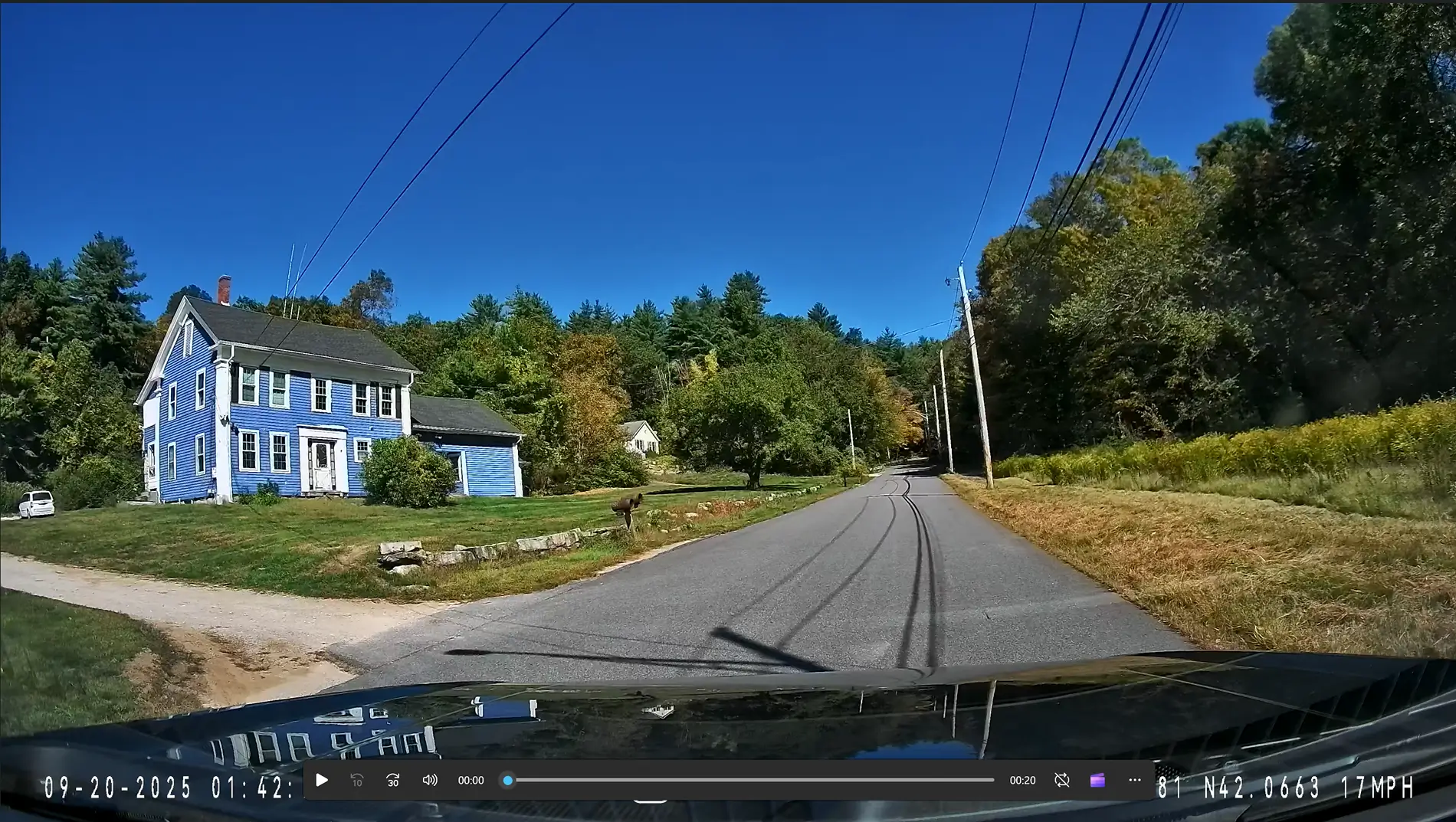

When there's no glare the front camera is very impressive:

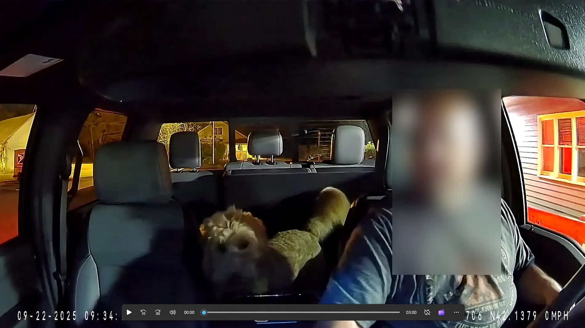

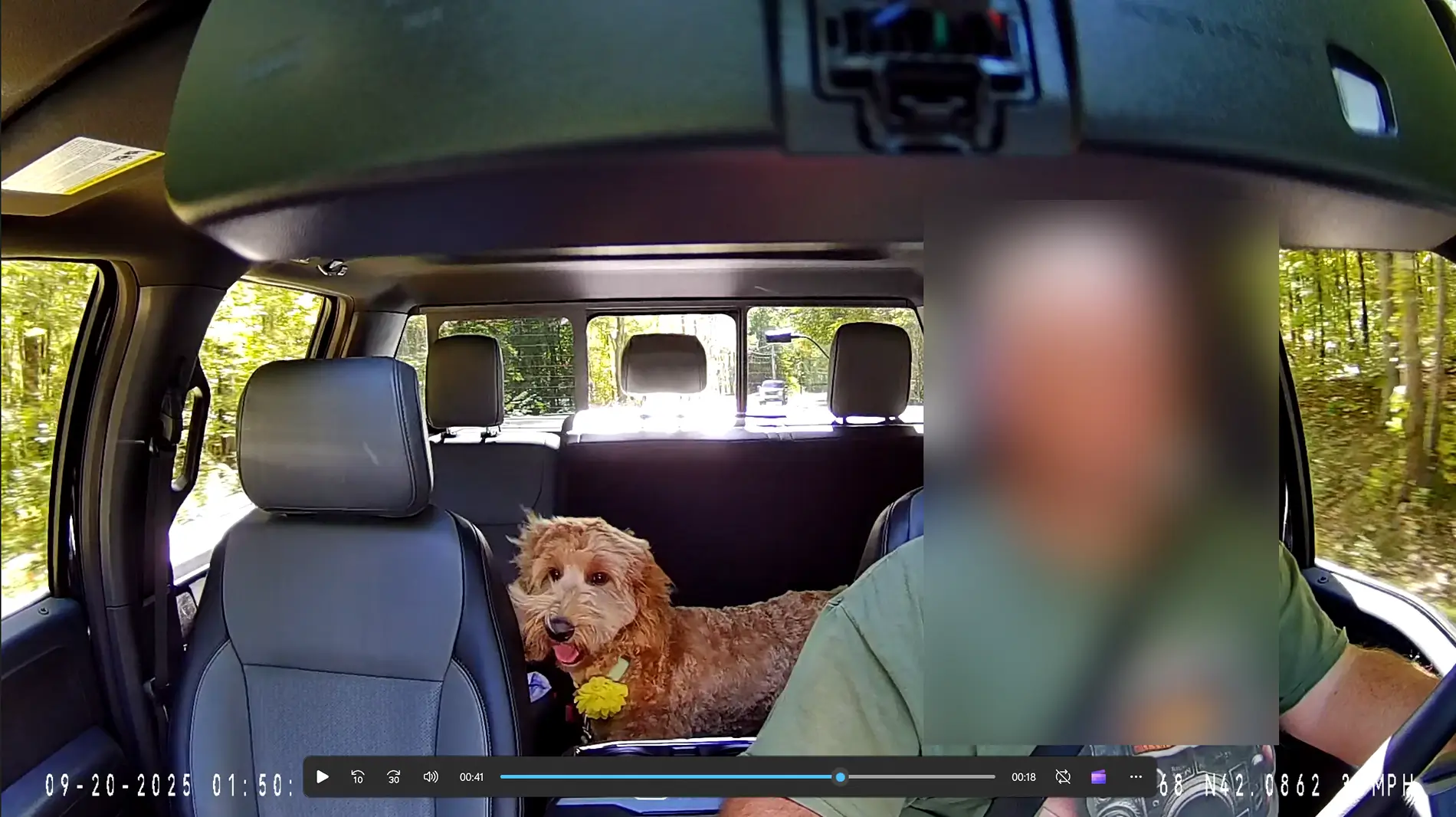

The internal cabin and rear cameras are quite good as well:
Ford F-150 Lightning Redtiger F17 Elite - Installation and Review 1758940769976-s1
Ford F-150 Lightning Redtiger F17 Elite - Installation and Review 1758940683040-1j

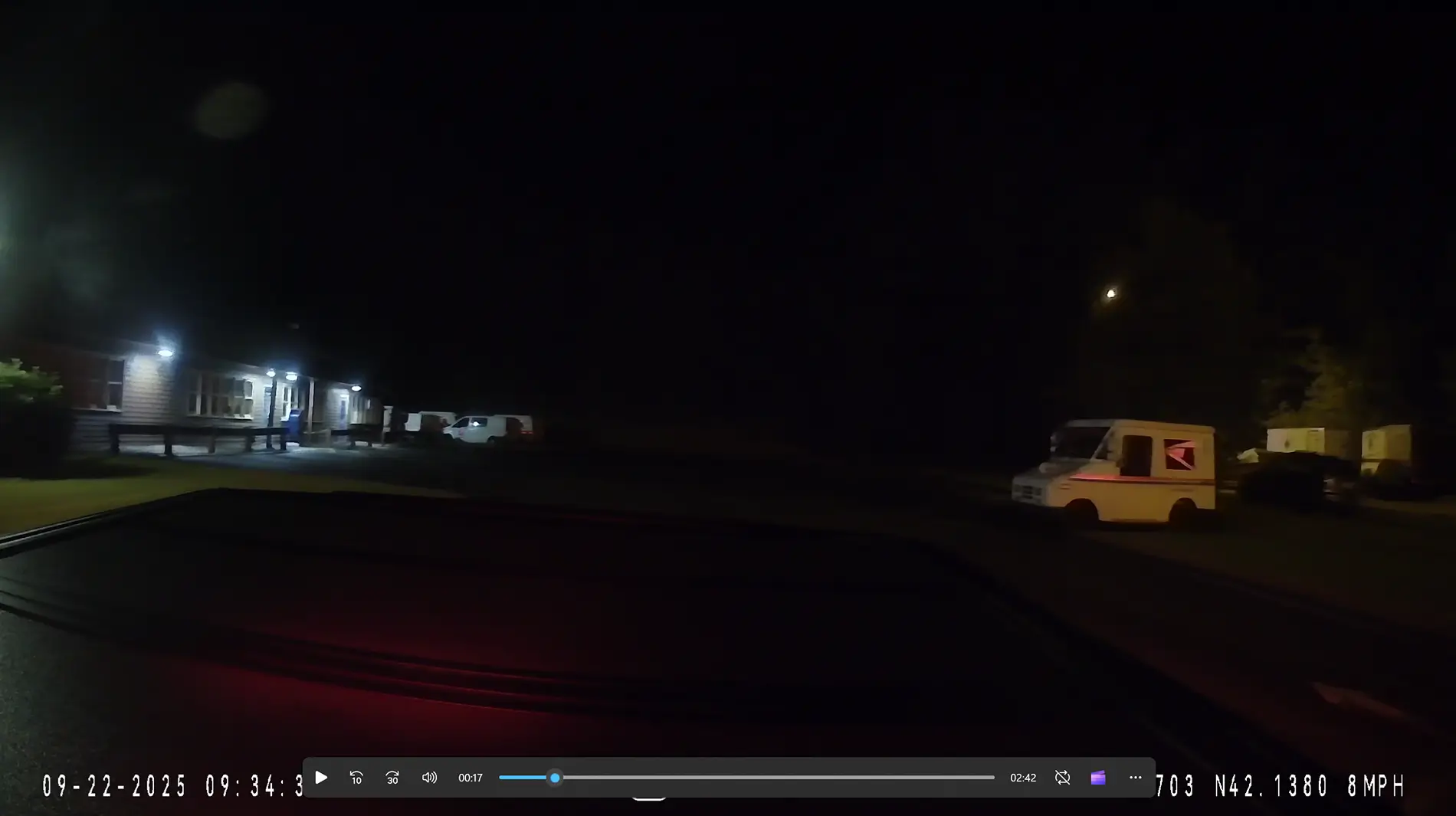

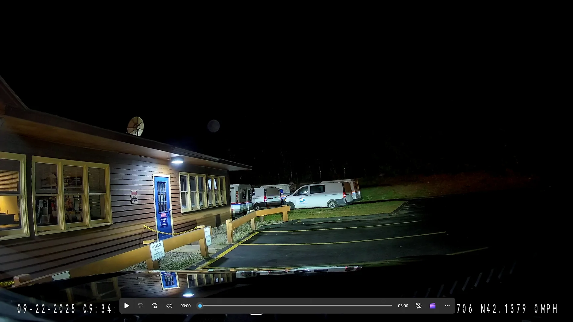

Some low-light/night views:
Ford F-150 Lightning Redtiger F17 Elite - Installation and Review 1758941058261-9v
Ford F-150 Lightning Redtiger F17 Elite - Installation and Review 1758941164322-9h
Ford F-150 Lightning Redtiger F17 Elite - Installation and Review 1758941241281-qa

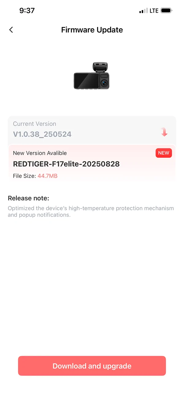

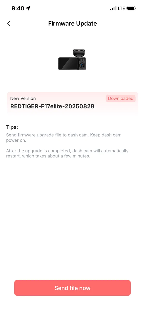

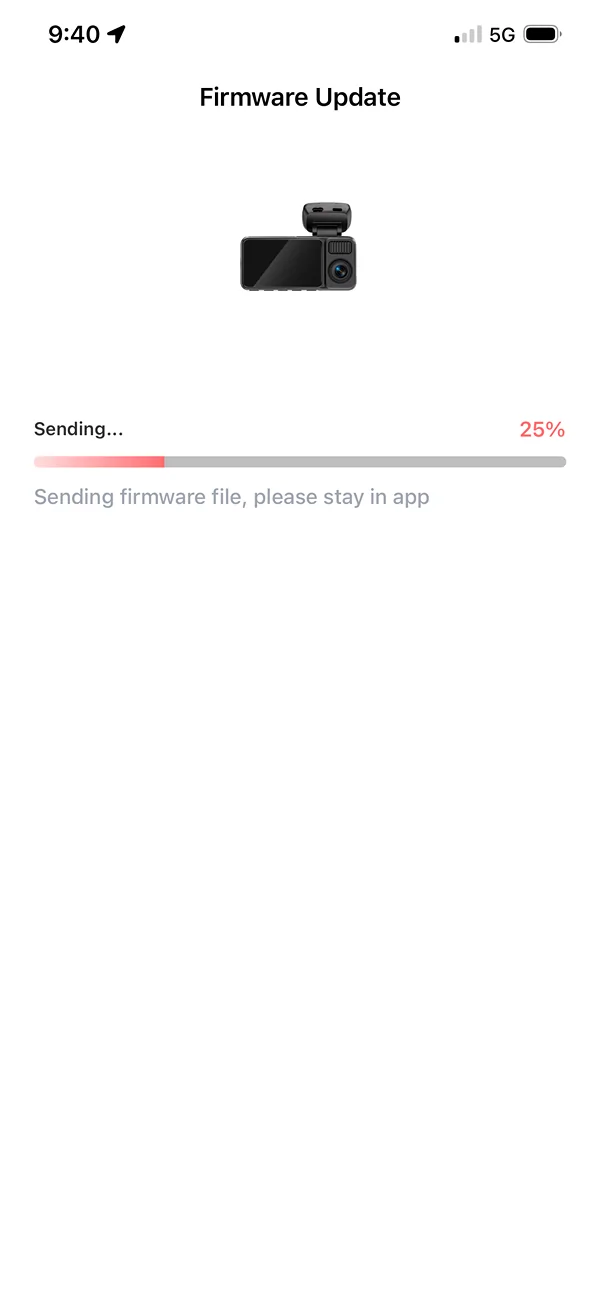

My Redtiger contact emailed me the other night and let me know there was a firmware update available for the F17 Elite dashcam. This morning I some had time so I installed it.
I took some screenshots from my iPhone and a couple pictures of the dashcam to document the process.

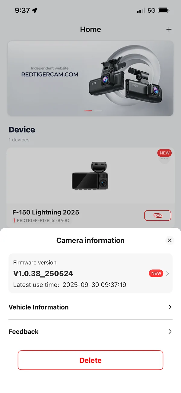

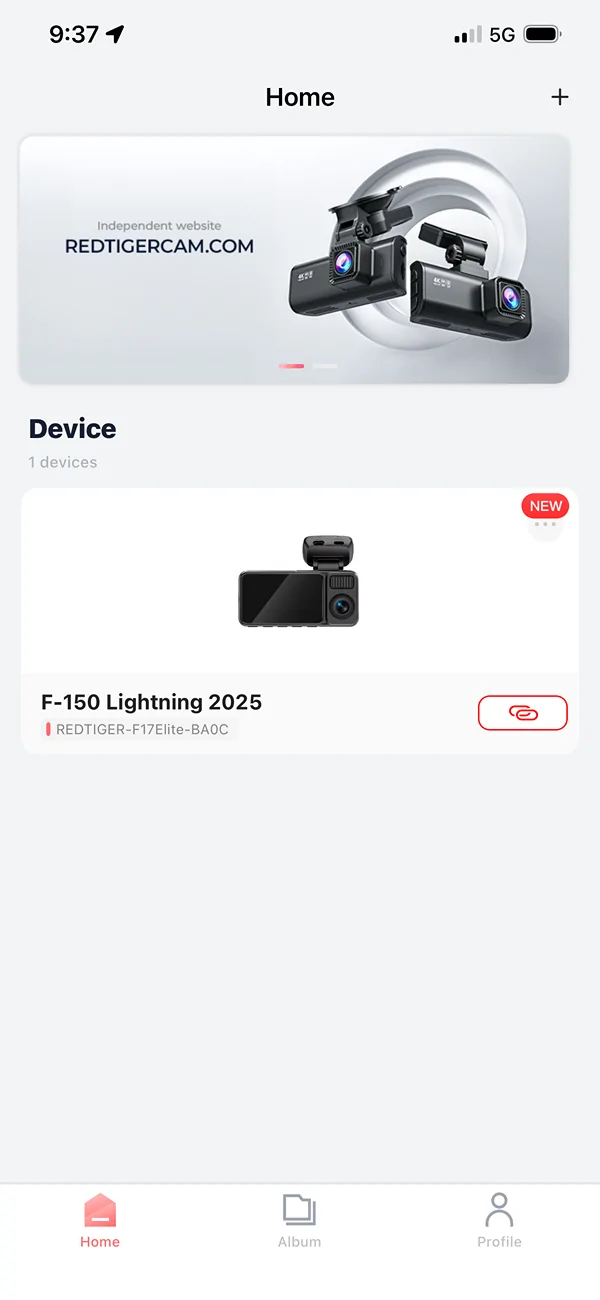

First, I connected my iPhone to the dashcam's WiFi. On the dashcam I activated the 2.4Ghz WiFi and then connected to it through the Redtiger app.
I was presented with the "NEW" icon for the dashcam and could view the current version.
Ford F-150 Lightning Redtiger F17 Elite - Installation and Review 004
Ford F-150 Lightning Redtiger F17 Elite - Installation and Review 005
Clicking into the dashcam I was prompted to "Download and upgrade":
Ford F-150 Lightning Redtiger F17 Elite - Installation and Review 006

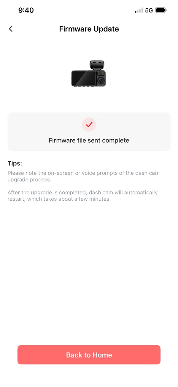

The firmware update took 2-3 minutes to download to the phone and then I was prompted to send it to the dashcam:
Ford F-150 Lightning Redtiger F17 Elite - Installation and Review 007
It took maybe a minute to send the firmware to the dashcam:
Ford F-150 Lightning Redtiger F17 Elite - Installation and Review 008
Ford F-150 Lightning Redtiger F17 Elite - Installation and Review 009

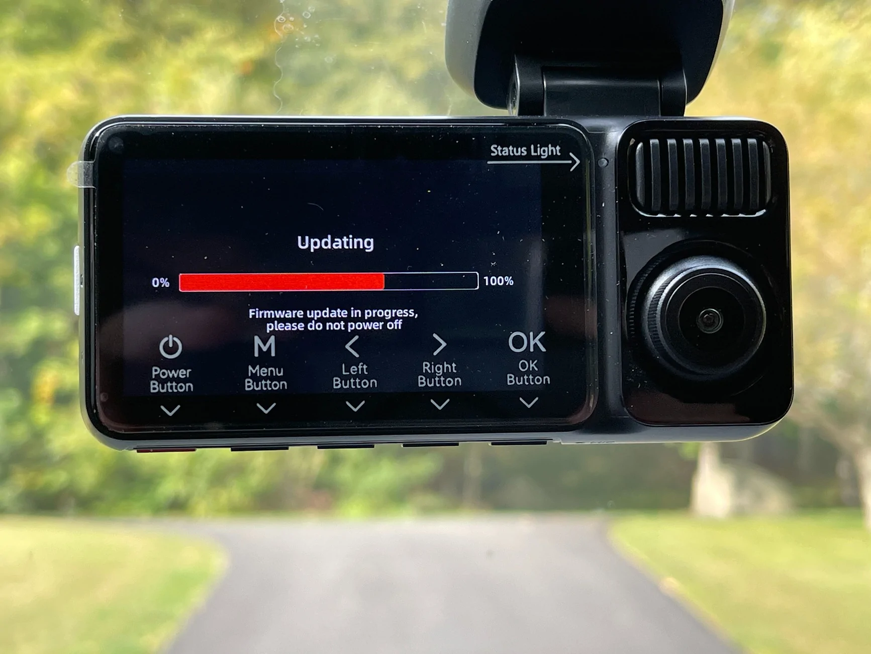

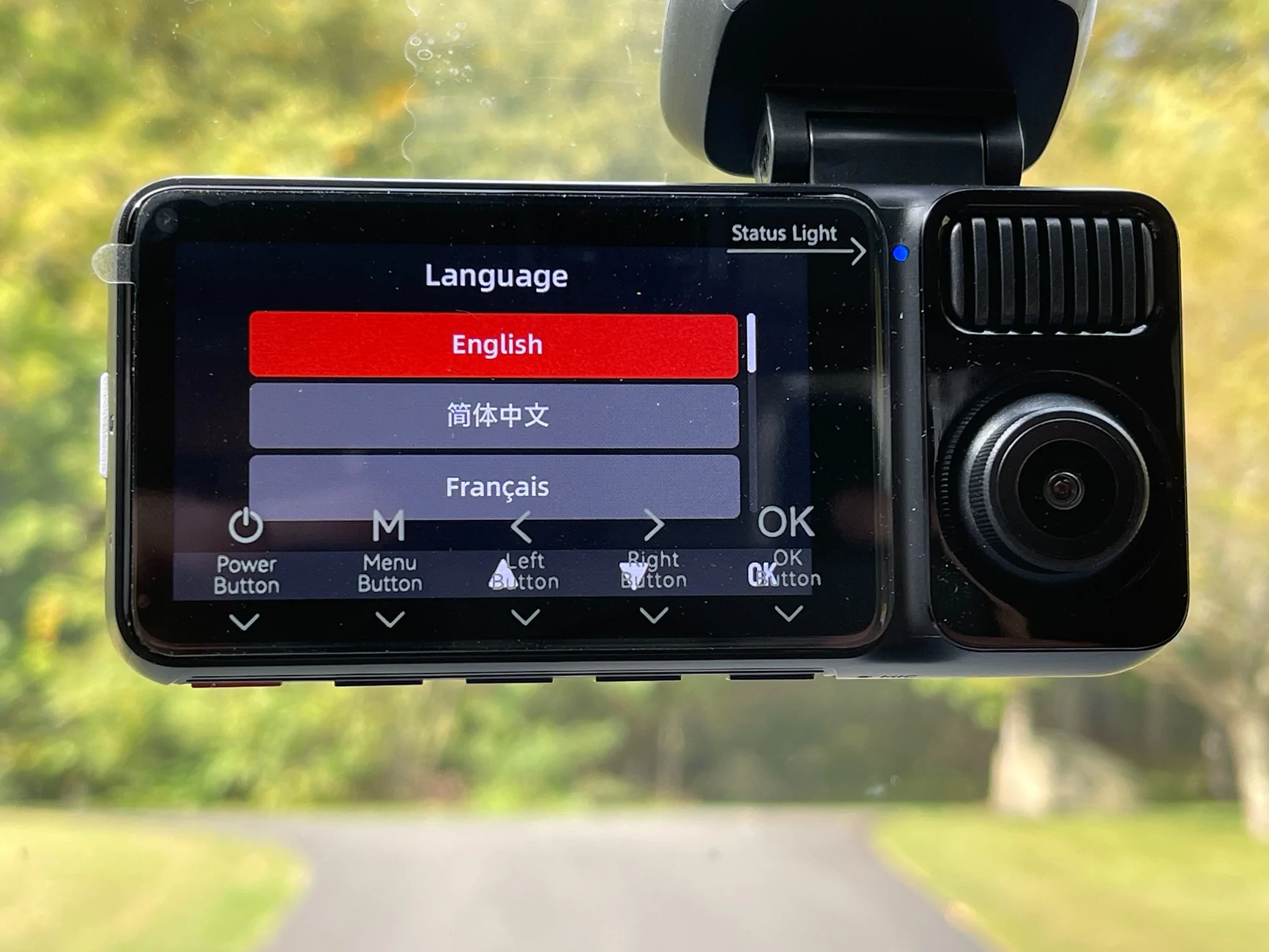

The dashcam had a message on it asking if I wanted to update (I wasn't able to get a picture before it went away) which was a little confusing. But once the firmware was pushed to the dashcam the update started automatically:
Ford F-150 Lightning Redtiger F17 Elite - Installation and Review 010
It took 1-2 minutes to complete and the dashcam restarted automatically.
Ford F-150 Lightning Redtiger F17 Elite - Installation and Review 011
Upon restart it looks like you lose your settings. I had to choose the language and then re-enable the DST setting to get the clock to be set properly. I'll have to look into it more to see if it actually saves/restores settings, or if you have to "start over".
If it doesn't save the settings, again I have to research/test some more, it would be nice if you could save/load them to the SD card to make it quicker.
Overall, the firmware update process was quick and easy.
