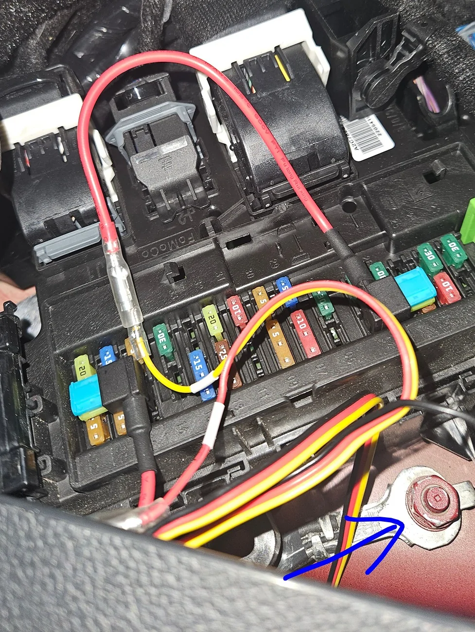

Checking the fuses was a real pain in neck, as I wanted to use a spare/open slot so as to have less chance of interfering with anything. Thankfully, the manual showed several unused and spare slots. What was annoying is that the unused slots where missing the metal connectors so I couldn't use them. And the spares at the bottom where these weird 3 prong fuses that I guess spanned 2 slots.
Long story short, I used the provided piggyback adapter thing and placed the ACC wire in slot 17 facing down and the battery wire in slot 4 facing up. (I think, it's getting late and will double check that tomorrow with a pic) I loosened a bolt nearby that gave good ground and put tightened it back with the ground wire sandwiched between the nut and the washer. I saw one a bit closer that was painted red but assumed that was a DO NOT TOUCH ground.
