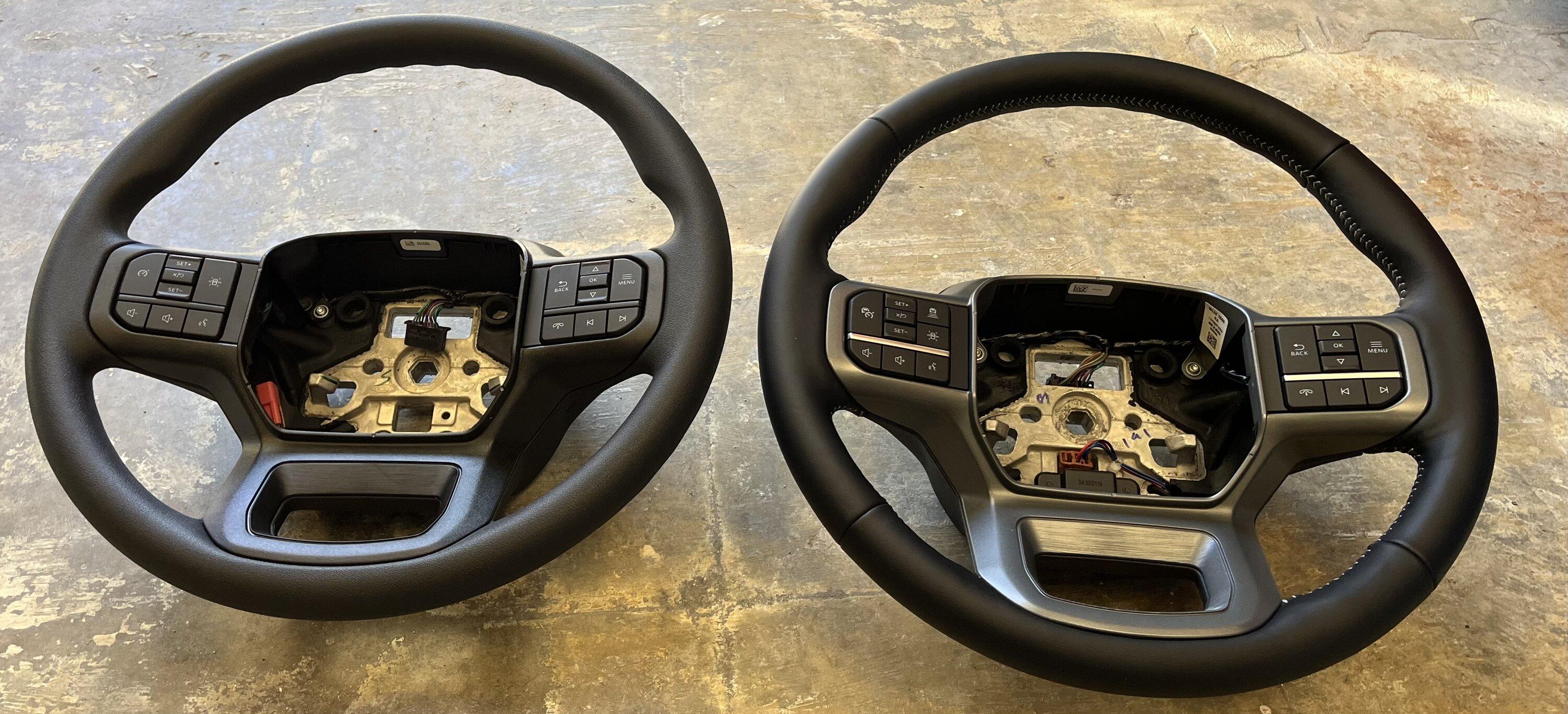

Hi all,
Just purchased a new wheel to complete the mod. I plan to add the SCCM for the heated steering wheel at a later time, but for now, I just want to get the new wheel installed.
As Jallen stated, the new wheel comes with different buttons. I plan on adding the adaptive cruise control as well, but not right now. Is there any harm in changing the forscan values for the new buttons if I don't have adaptive cruise control installed yet? If so, anyone know the values and process to do so?
Thanks!
