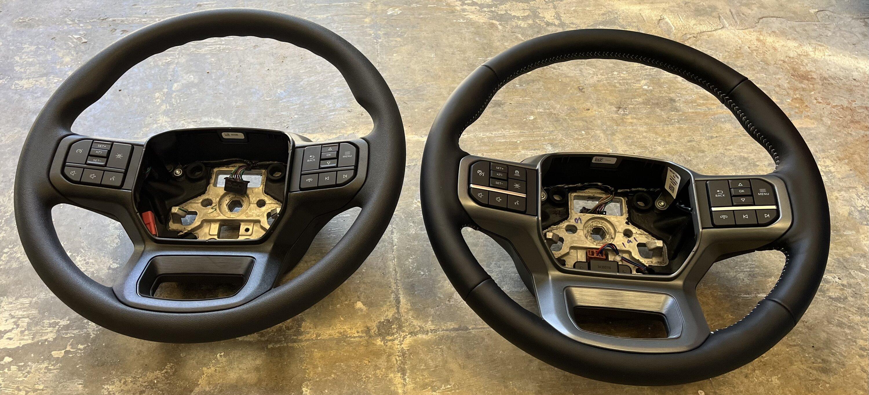

So, I completed the swap of a Lariat Leather Heated steering wheel onto my Pro. I’ve read about at least one other member on here doing it, but I can’t find the thread again!
Anyway, It all went well, but none of the buttons on the Left side of the new steering wheel work. As you can see, the buttons are slightly different, but I dont remember whoever did this mod before saying they lost functionality.
Am I missing anything? Really the only button I’m needing is cruise control. The others I never use.

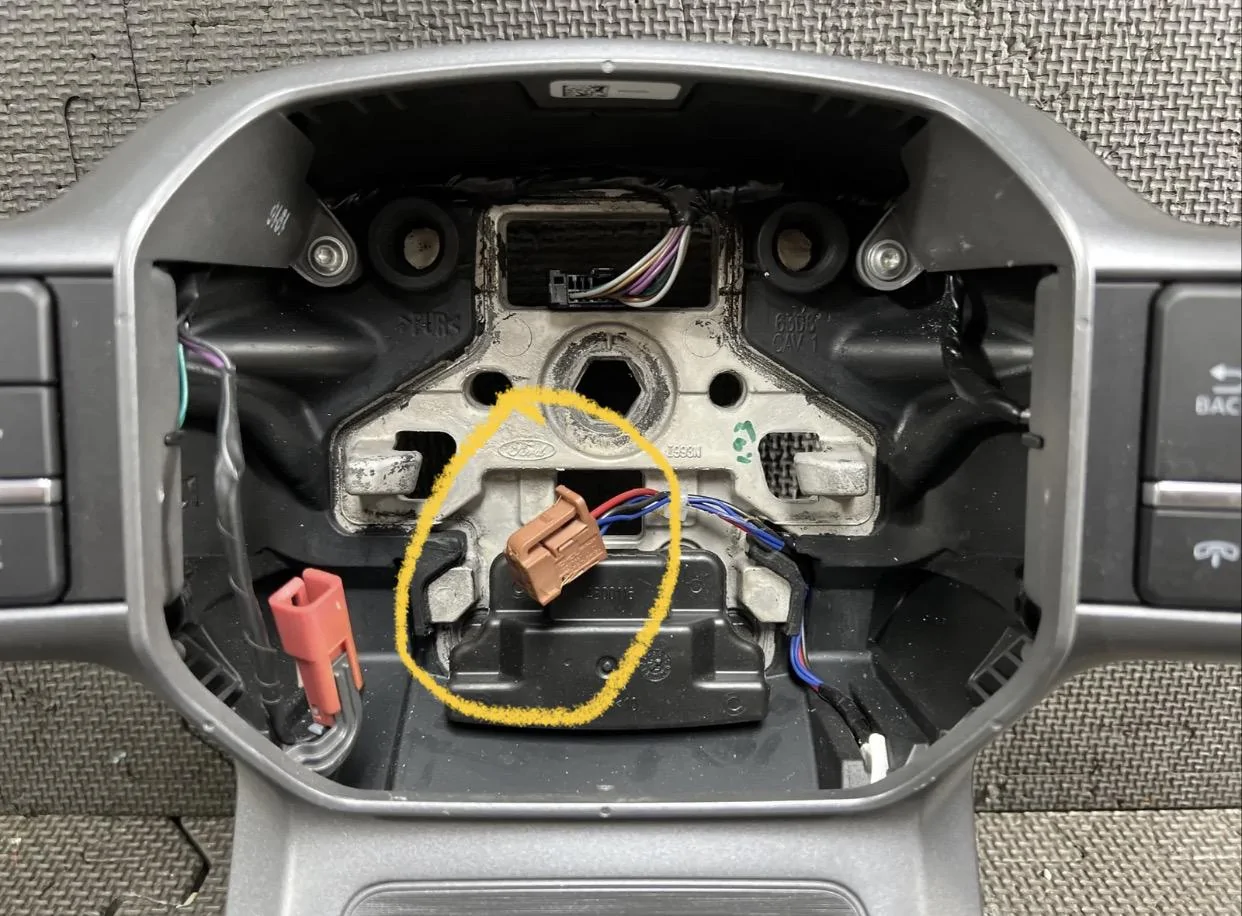

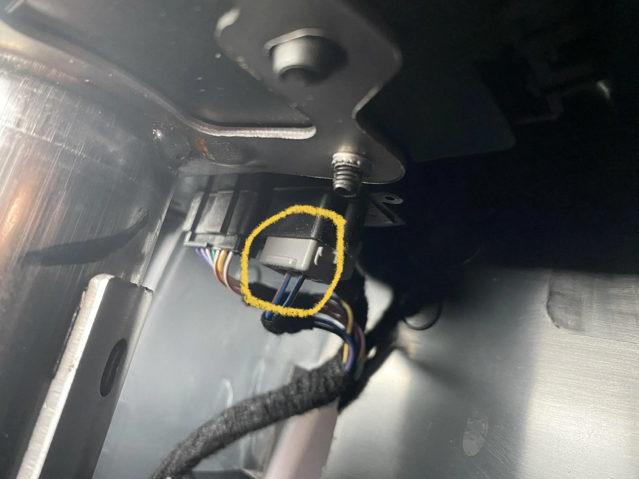

@jallen
Did you notice if our vehicles had these 2 wires? This affects whether or not we need a power harness for the Heated function...

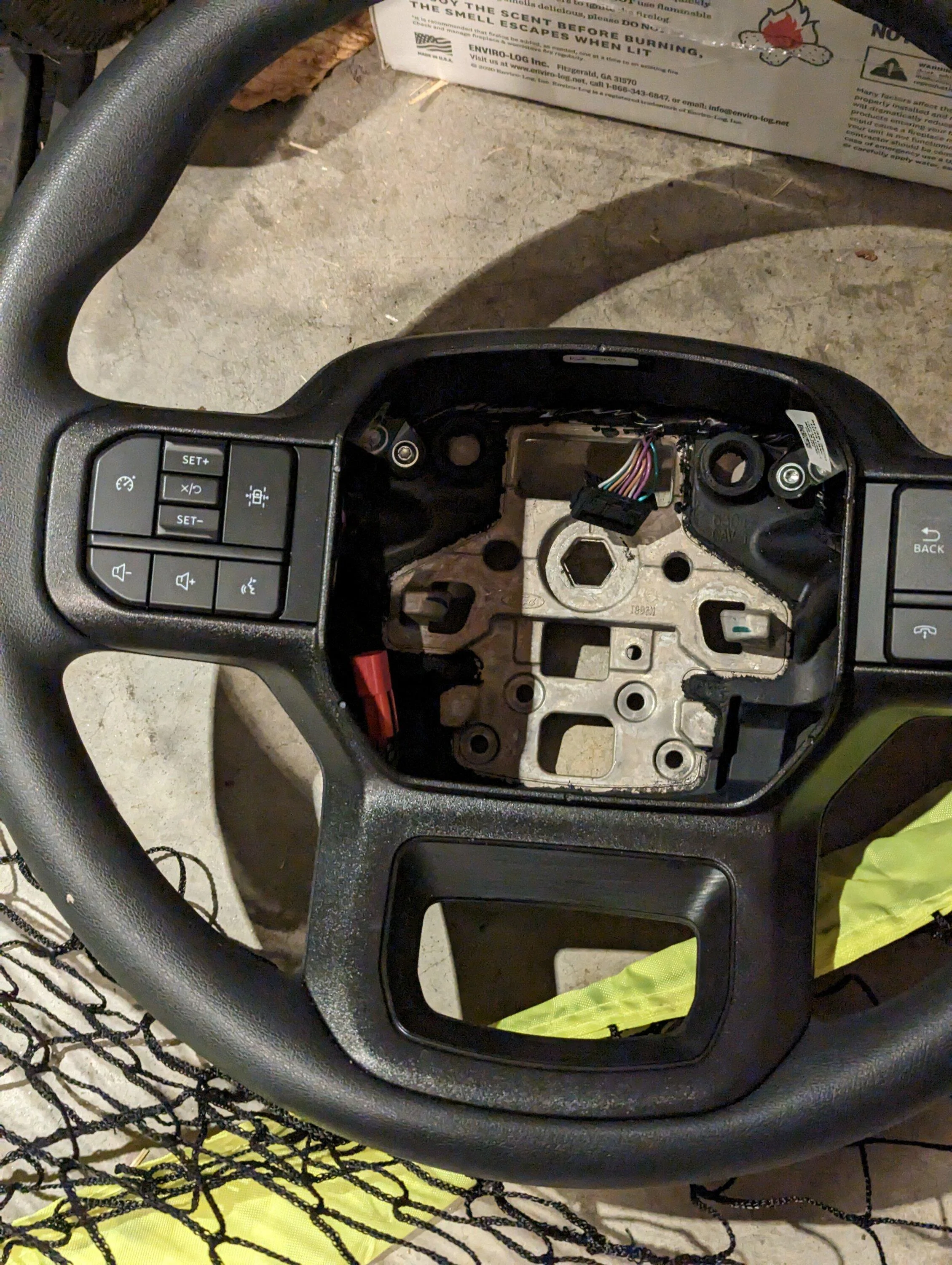

@jallen
the standard, poly Pro wheel doesnt have either of those, here is a pic of it, I just swapped for a leather wheel 2 weeks ago (non-heated, so the new one had the same connections). and the place where that 2nd connector would go is blank in the clockspring.

Well after some research, and chatting with folks on the ICE said I have some bad news.
It turns out it's not as simple as replacing the clockspring. The entire SCCM needs to be replaced. That part is $200+ (after shipping). With a new steering wheel, bolt, SCCM, and wiring Harness it's looking like it will be in the $450-$500 range.
At that price I might be passing on this mod.
