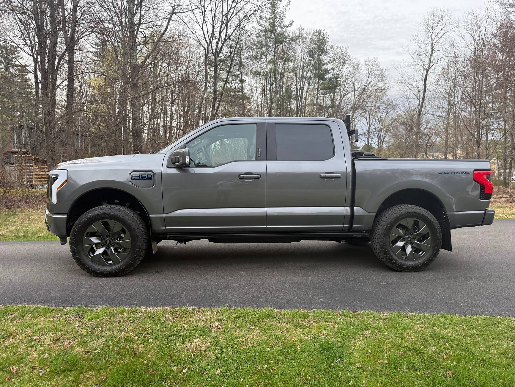

I think the issue with the OP’s truck is too much height. Spacing the factory strut units down for height generally works for a 1-2” leveling lift. The lower A arm may not have enough down travel to allow things to work smoothly. I don’t see any provisions for correcting the front sway bar angle after install, so it could be binding and making the ride harsh. I haven’t seen a response about the tires being E rated vs SL, but the 275/65R20 is available in both. E rated tires inflated to 60-80PSI would make the truck ride terribly.

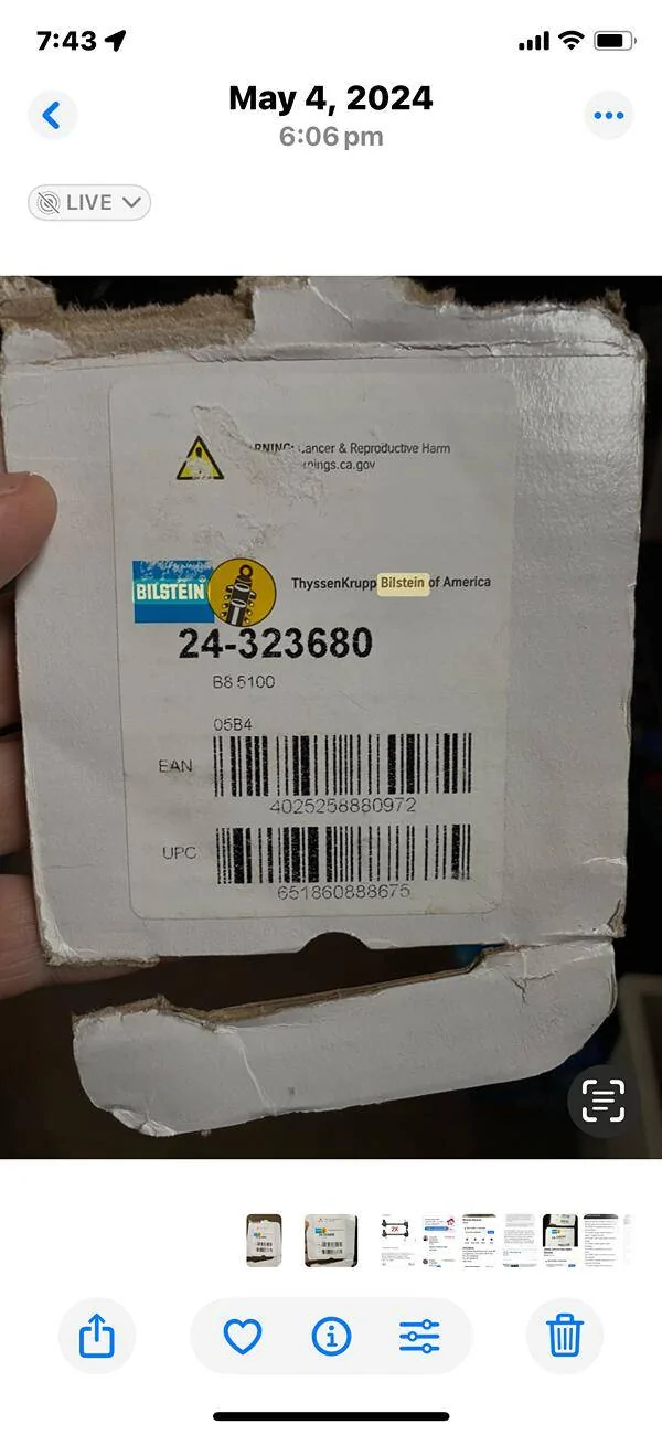

I did put Bilstein 5100 front shocks only with the stock springs and it levelled it and made the front end amazing. No dive in corners, no float And no noise. One day I will track day this truck, it handles that well.
I do not know others experience with doing this but for me it is a noticeable improvement / upgrade for under $400.00.

Do you have a more detailed breakdown including the part numbers please?

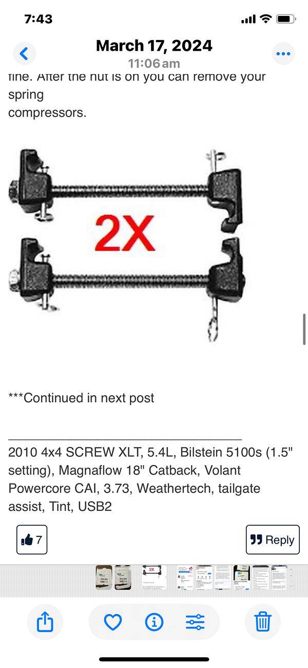

These are what I used. 125. Each and 75.00 per side at an independent service shop. Took 45 min and I had the spring compressors to do it myself but then found the shop that did what I would have done much faster. It was painless. 400 total dollars spent.
