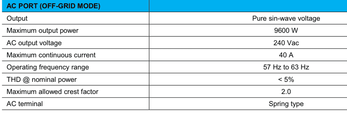

I think the AC pulling 35A may be testing the limits of the HIS, the inrush is probably a bit higher. The HIS is rated for 240V/40A max (9.6 KW), so the 70A rating from the Sunrun Rep must have been thinking about 120V circuits.
