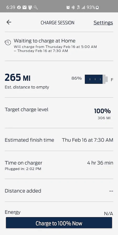

When I need a higher SOC than my routine, I adjust the home charging scheme the night before, in prior version we've noticed a bug where choosing the 100% SOC caused the EVSE to activate immediately, personally I have not worried about this overnight high SOC knowing would be burning it off on the upcoming road trip.
With FP version 4.24.2 they seem to have fixed that problem, I was able to demonstrate a change of my charging profile, only change was to go from 90% to 100%, saved it and the truck did not start pulling power immediately as was the case in the past.
Just make sure you provide a sufficient margin of time to complete the charge.
