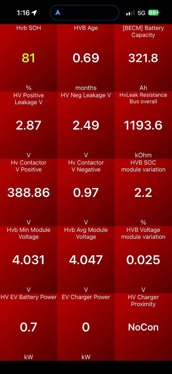

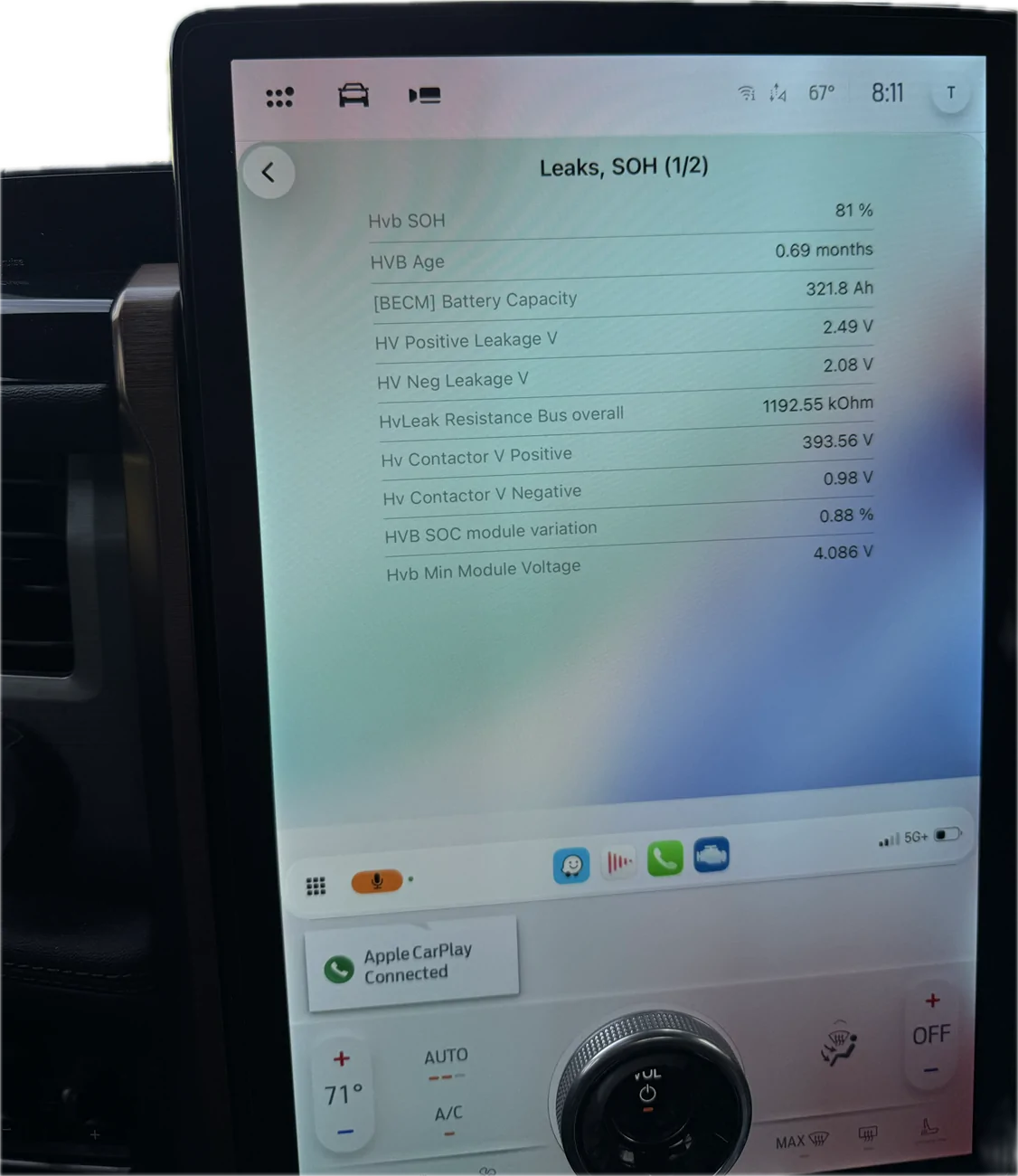

So i have charged it to 100% and discharged to 2%. Recharged it to 100%. No effect, prior to that exercise it went up to 81% from 79%.
so just be patient I guess.

what is your "Energy Remaining" at 100% SoC I'm curious if that lines up with 81% of what your batter should be?

Your battery age tells me that your BECM itself was replaced. Variations aren't too bad, I think you'll slowly get SOH back of the next couple of months as the new BECM learns the battery.
2,770
3,052
That caught my eye as well.
The truck thinks that battery is basically brand new, less than a month old. Ford reps have mentioned here that it takes several weeks for the BMS and battery to get back fully in sync. I would give it a month or two and then see where things settle.
