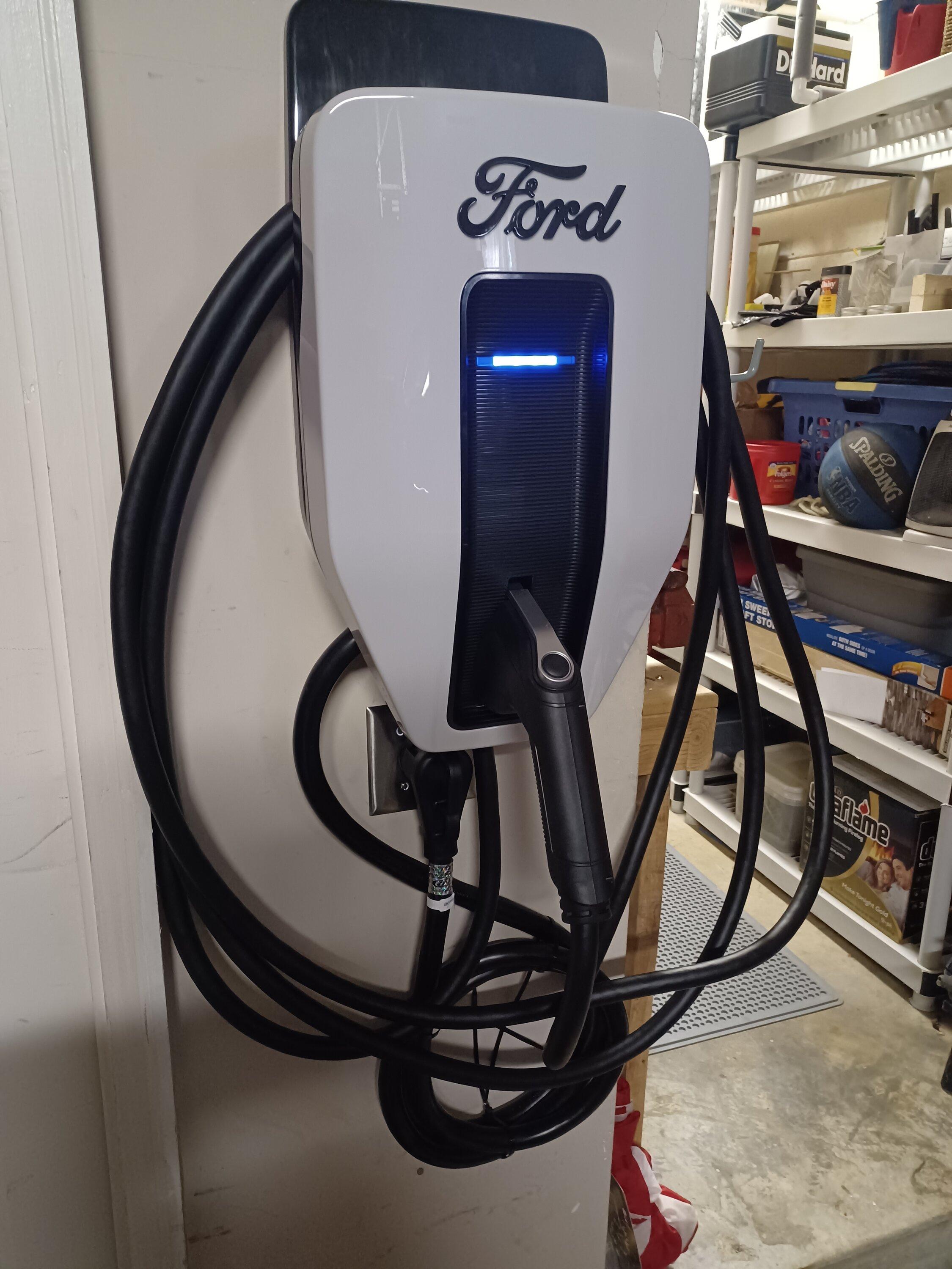

Upgrade depends on how long you plan to stay in the home to me. My panel could handle the full 80 Amp install, but it was over $5k. The portable ford charger worked for 31k mile with my Mach-e. I however set the pro charger to 40 Amp and added a 50 Amp cable to use the existing nemi outlet. Works great and only $27 for the cable.
