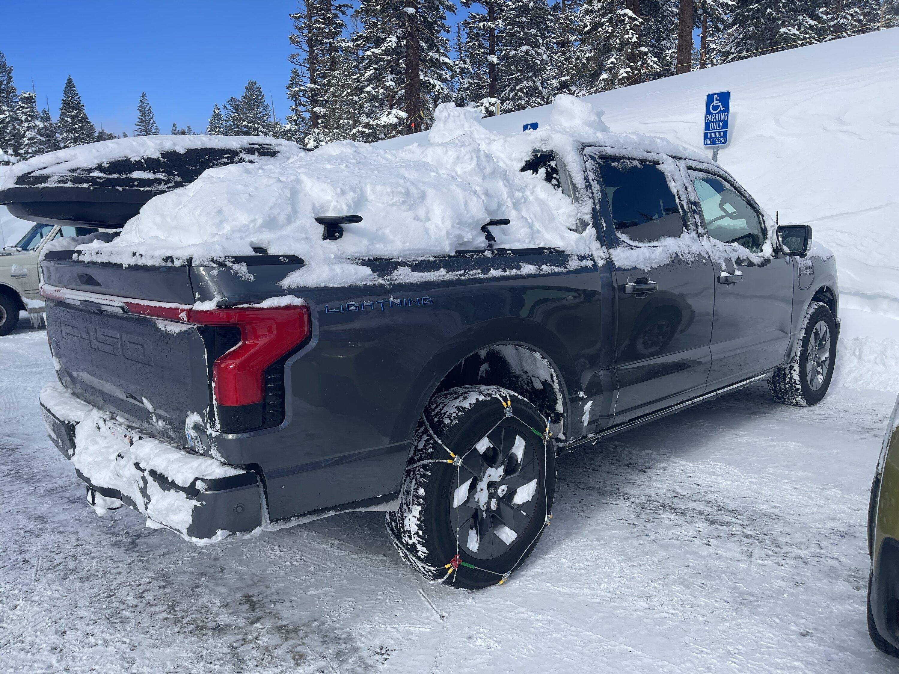

Bought a pair of Z cables and they were easier to install rather than standard chains used them on black ice around Lake Arrowhead area they work and the truck does well, just mind your charge levels in freezing temps.
Thanks, just picked these up. They seem the best value and are still class S, low clearance compatible.
Have to ignore the manual's statement not to put snow chains on the R20 wheels. After a 6 hour drive to get to the mountain, if they happen to have a chain restriction that enforces even 4x4 need snow chains, I'm clearly not going to turn around or pop in to a local shop and buy 4 new wheels!
Anyway, the manual states "chains" and these are "cables". ;)

Any update on this? Did you have to use the "cables"?
