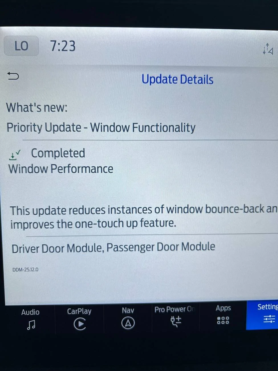

This is the last update I got and it was months ago it seems like. I also have a 23 standard range and don’t have the fancy charge rate in my dash either hoping it comes to me soon. I’m also having the audio issue being choppy with CarPlay makes me remember the portable cd player that would skip. Ford needs to fix these issues with the updates and sync
Yes the BlueTooth streaming audio is a common problem it seems which is why I switched to either:
1) an SSD (or other memory device) formatted in exfat with my music on it plugged into the USB port or
2) an FM transmitter connected to the music player (iPod, Zune, XM Roady, etc.) and tune the radio to an unused FM channel.
