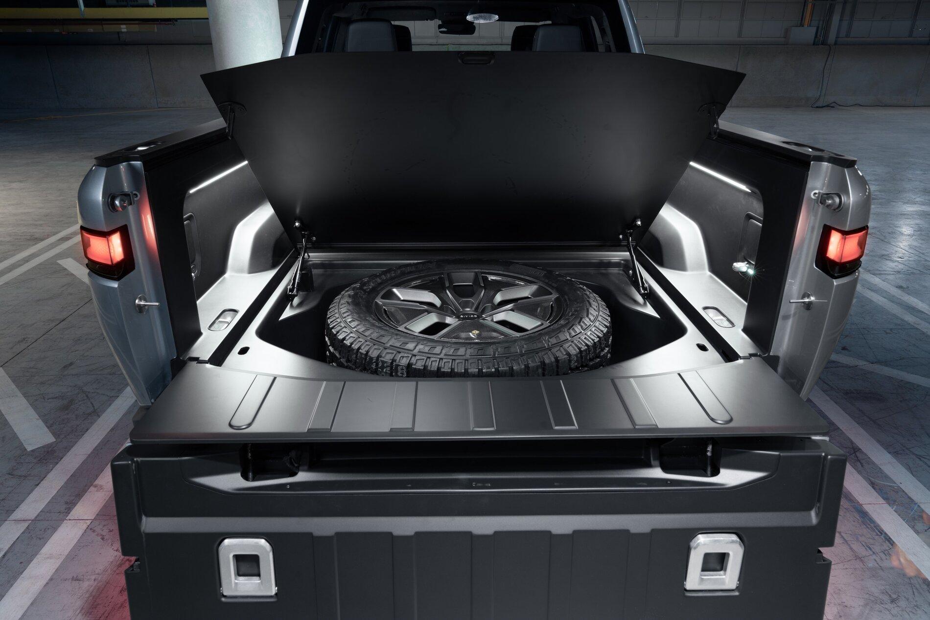

My question really came about when I saw the Rivian was embedding it in the bed, which has all the same hassles you described that could potentially come with the frunk. If someone is going to embed it in the bed, which would seem like a bigger pain to get it out than the front (more people store heavier bulkier stuff in the bed vs the frunk) why not look at the front for weight distribution purposes? Or even have it drop down in the front like Ford currently does with the spare in the rear?
Most consumer vehicles with spares store them in the trunk, which is basically the same as the frunk.
I'm attaching the Rivian placement...
Ford F-150 Lightning Spare Tire Placement Design Rivian-Spare-Tire-Compartment-RT1

I agree with @SteffanG - the F-150's spare location is known from the ICE version, is in a location that would otherwise be wasted space, and can be easily accessed even when there is a load in the frunk and the bed. Moving it to the frunk would eliminate all of those benefits and reduce frunk space to boot.
The way Rivian is doing it is a liability, IMHO. The Honda Ridgeline does it that way, too (or it did in the 1st gen version - not sure about the current model). If you're hauling something too heavy to move by hand while on the side of the road, you're completely out of luck.

Looks like the spare on the Rivian is in the worst possible place... unless you don't plan to carry a spare and get all of the space for other junk instead. Still useless if the truck is loaded.
The location on the Rivian was chosen because if you're off-road and there's a big rock or something in the way you may not be able to drop the spare.
Another thing on the placement on the Ford is that they can use all of the same mounting hardware. They already order a million tire hangers a year. Ford is using their scale to their advantage.
Interesting point. I hadn't thought of the "rock in the way" angle, but then I'm not an off-roader.
This illustrates the different markets for the vehicles, and how that influenced design. As an "adventure vehicle," the Rivian really is designed more for off-roading than for hauling, despite its impressive figures. The Ford is designed to be more of an "everyman's pickup" just like its ICE counterpart.
Interesting observation and helps explain why the Wrangler and Bronco mount the spare on the rear...
