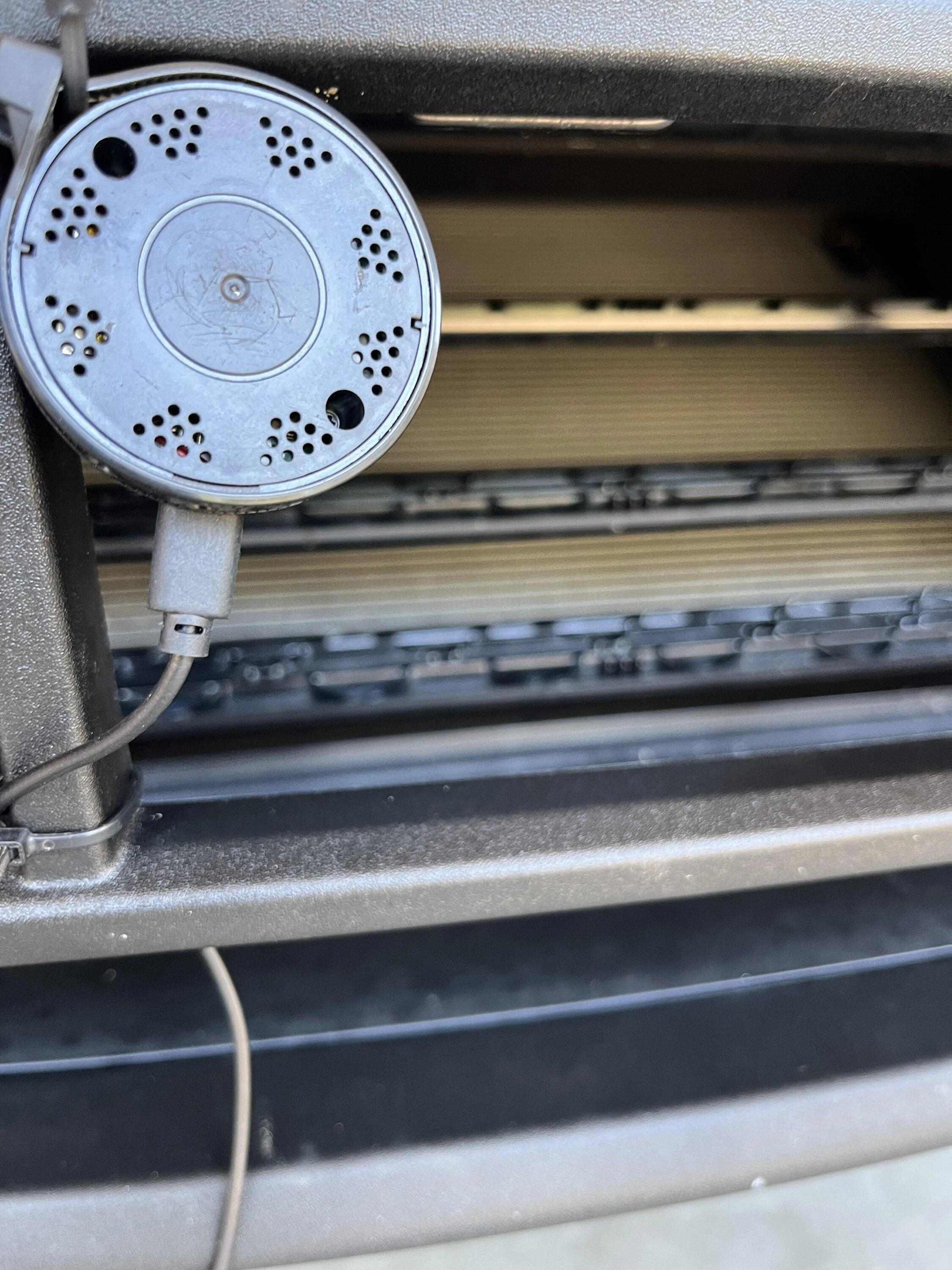

Here's the front lower Auto SHUTTERS, in action, OPEN and CLOSED, to provide standing cooling and air movement to the battery pack...
when the truck is parked and OFF, the Shutters automatically OPEN, and the fan/cooling runs when the truck is CHARGING, or the battery pack is at a certain temperature.
when the truck is ON and in GEAR, the Shutters will automatically CLOSE, to provide the best AERO while moving, and since the battery pack doesn't necessarily need cooling while air is already moving during travel.
my tiny camera is mounting temporarily to the front shutter opening...
the video shows the truck leaving the carport, and starting to close, then eventually closing totally when I got up to some speed, at about the 25 second mark of the video...(35 seconds on the video itself)... these also closed back when I returned to the carport...

I knew my 'new' tiny backup camera for my camper would come in handy!
Wifi and directly to my iPhone while towing, or filming... : )

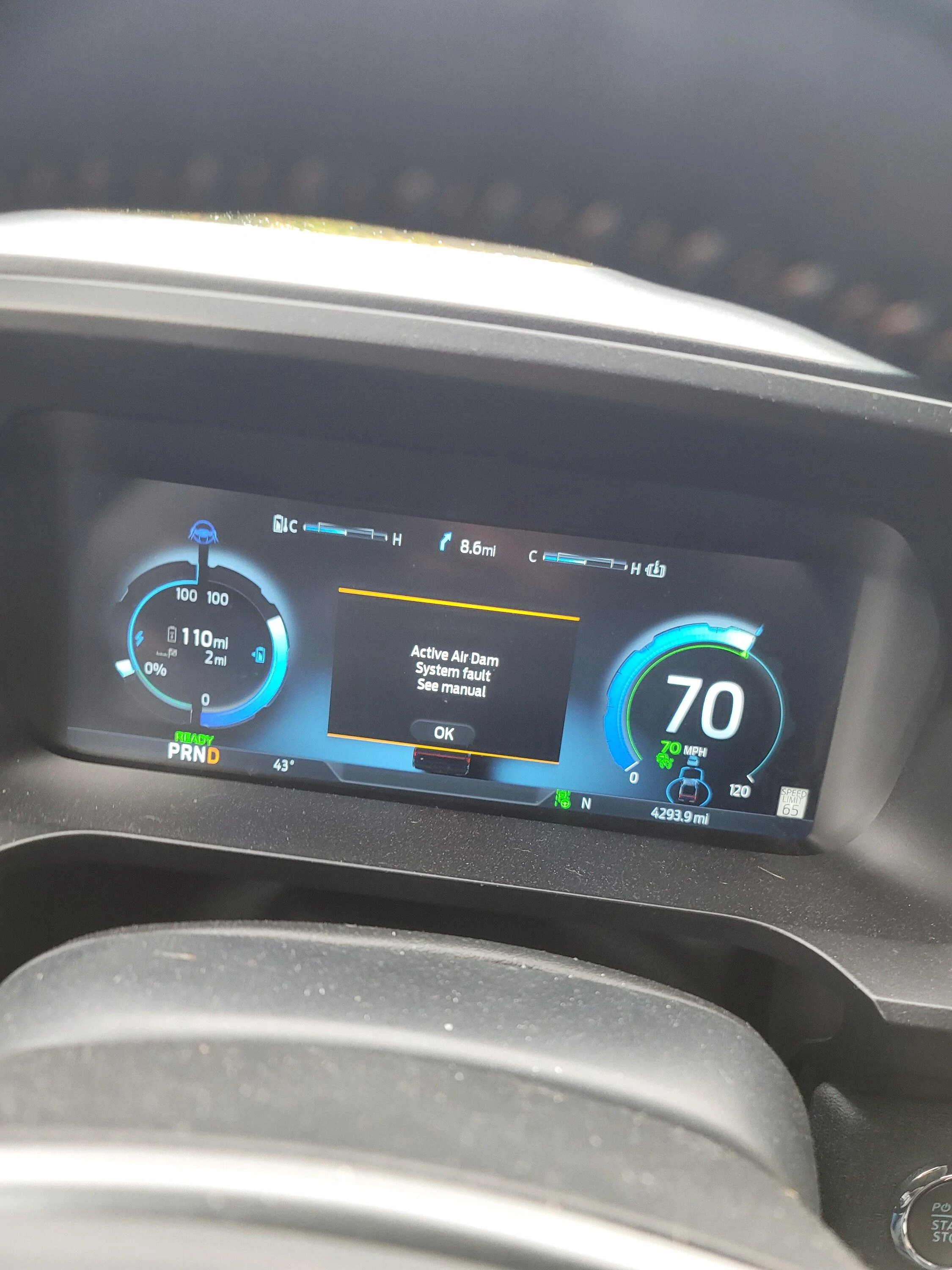

Very interesting info. I have had a few "Active Air Dam System Fault" messages pop up on my driver screen last weekend when I was at freeway speeds. So I have been researching this topic. Haven't snapped a pic of the error yet.

strange, but sounds like maybe a blockage of the ability for the unit to move down at speed...but, who knows.

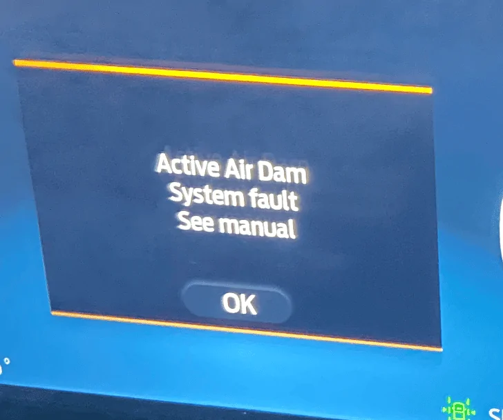

Yep, I've been getting that error as well, pic below. There are conversations about it in the ICE F150 forum, so not uncommon I guess for it to fail. I'll be having my dealer look at it first time I take it in for a checkup.

or a fault with the speed sensor
