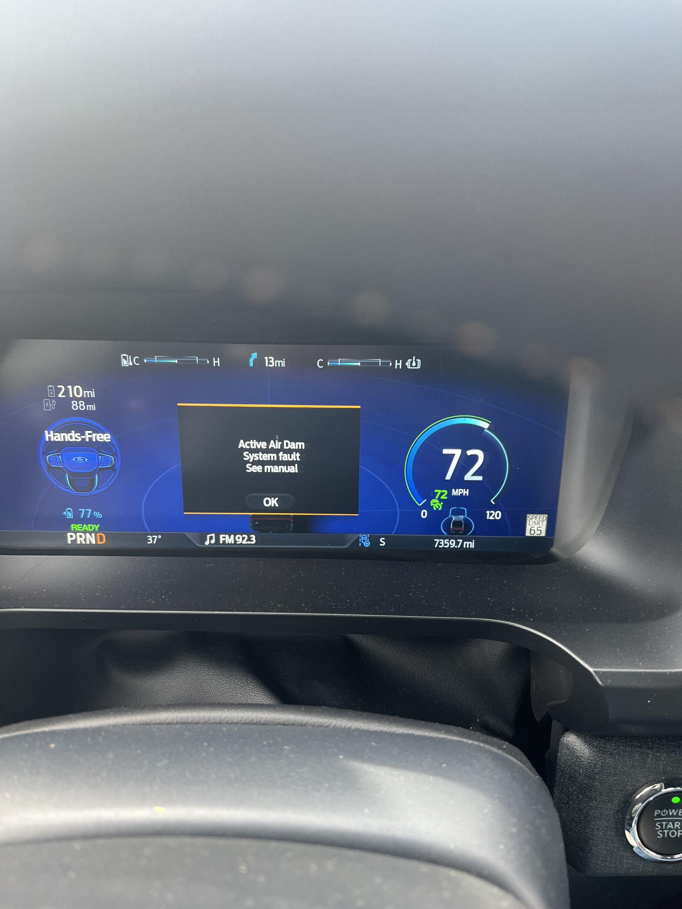

Just got it today, while accelerating on the Interstate in Tucson, 60 degrees outside.
...and I just got it out of the shop for the water-filled and ruind LED tailgate lights and anti-ting TSB.
This truck is starting to piss me off.

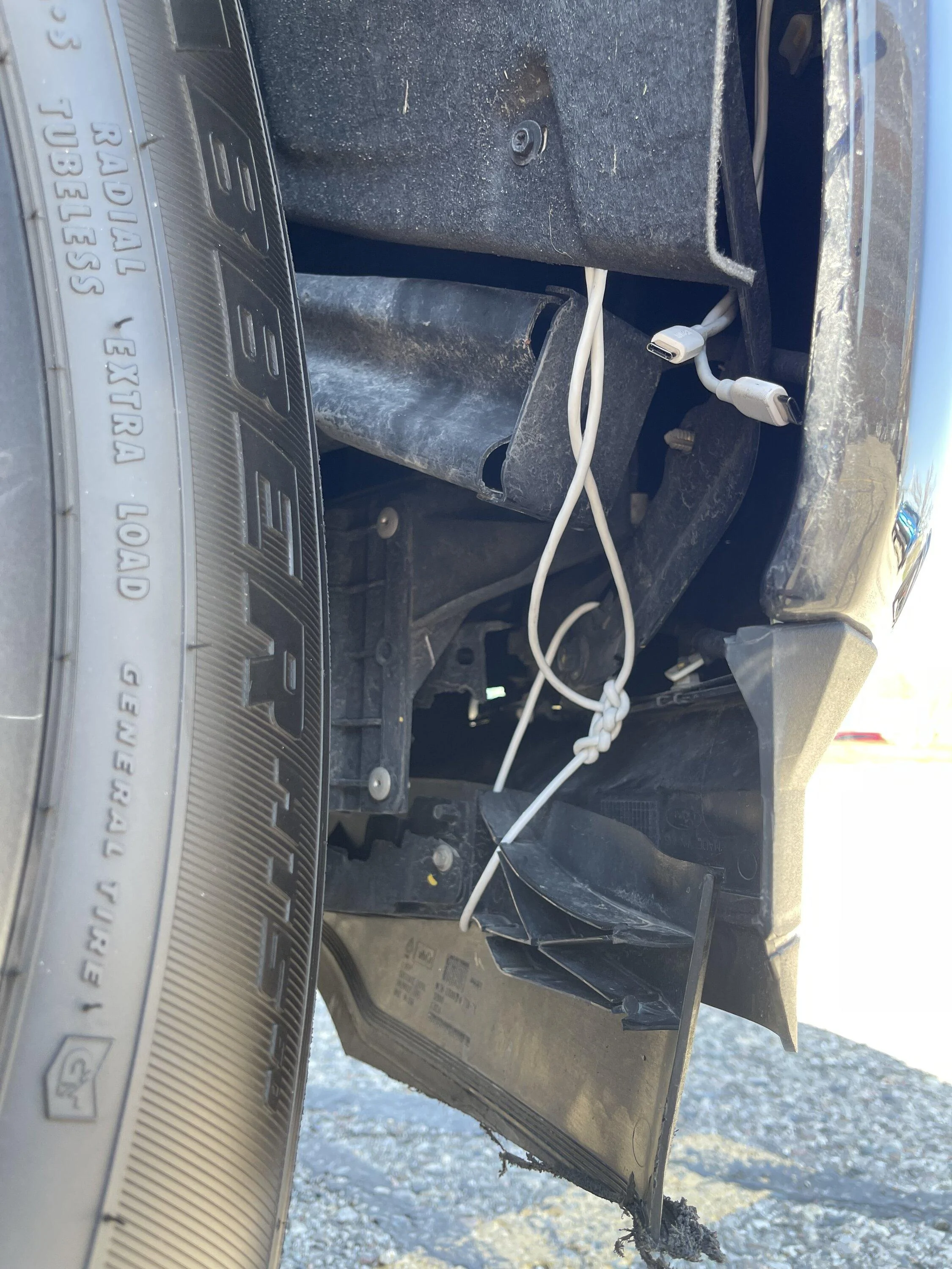

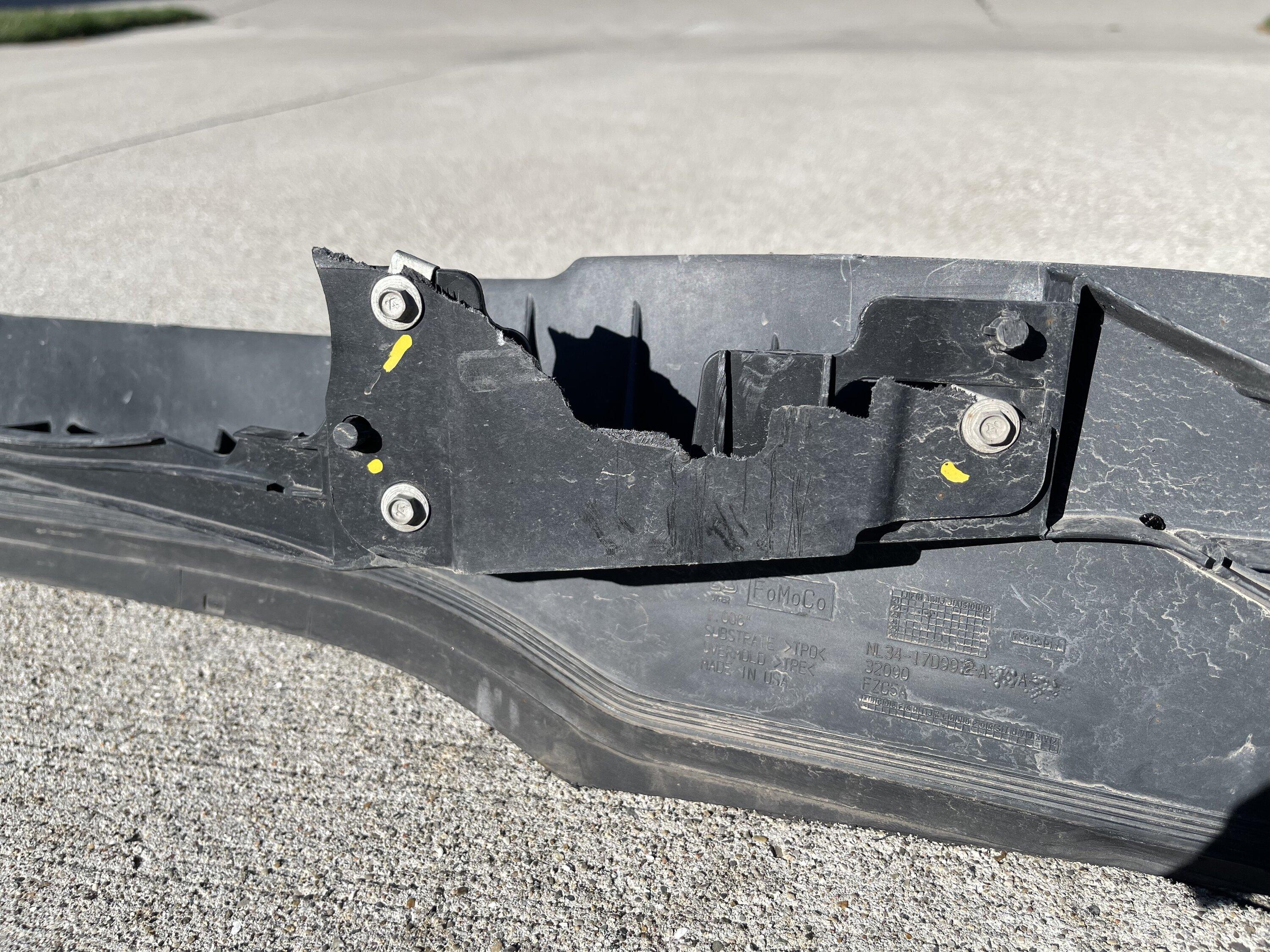

Well going down the freeway today and ran over part of a tire or piece of plastic or something and lo and behold tore the right side of the active air dam off the mount!
I was able to use a phone charging cable to hold it in place until I got to the dealer.
Dealer was able to order the part for about $200 and I’m guessing will be about the same for labor.
Thankfully no other damage to bumper or lower plastic piece. Would have been just fine probably if that hadn’t deployed!
This seems like the only legitimate time the warning should appear... When the front actually falls off.
Out of curiosity.... Did you get the active air system error message?
I'm going to guess you didn't. Because.... Ford software.
Not a thing! ?

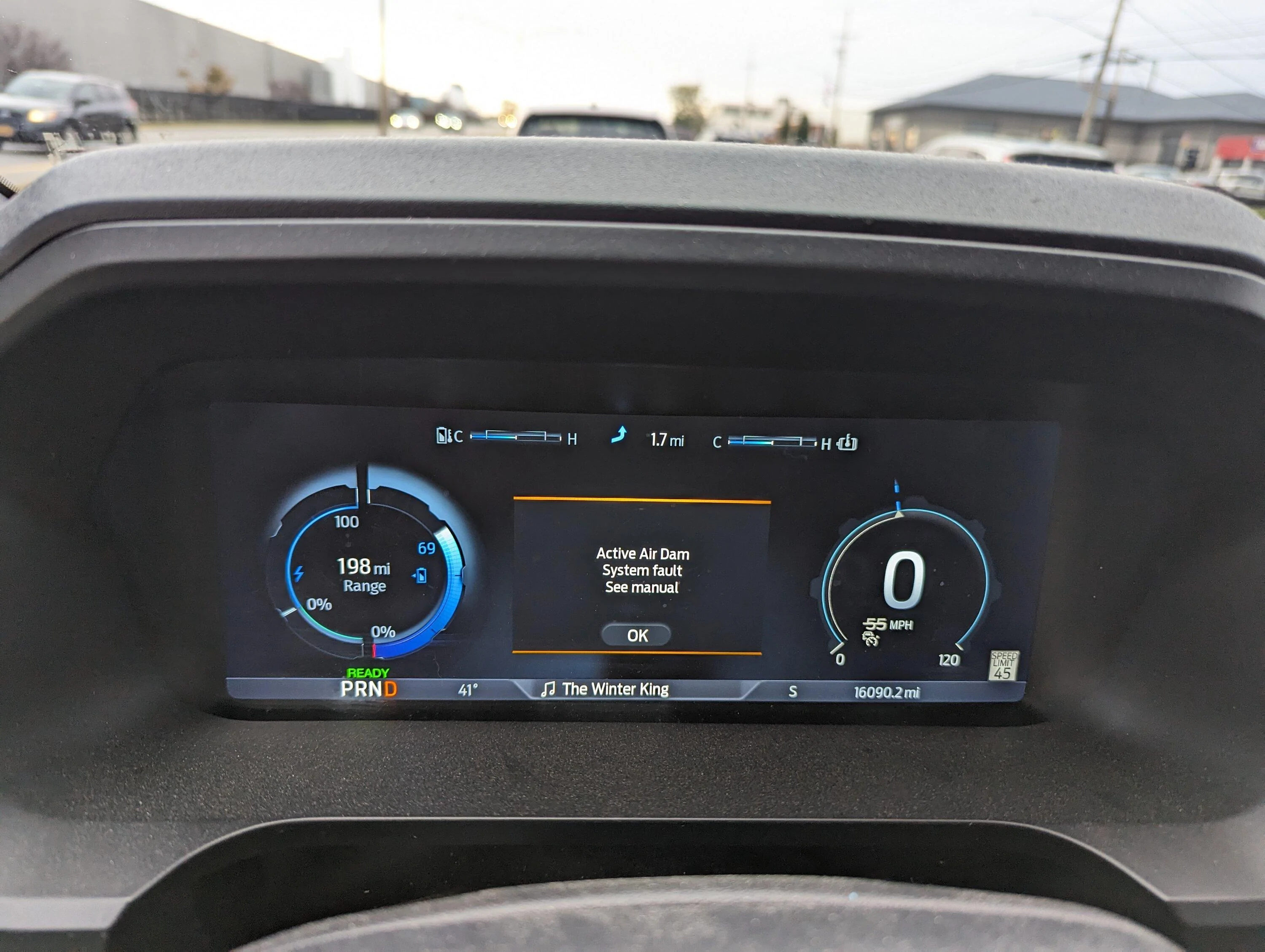

I too am getting the "Active Air Dam" error now. The newest one popped up as I was slowing to a stop, as seen in the pic with 0 mph as I waited to get to the red light to snap the pic. I dont think i was above 45 as it was city streets, but i honestly dont recall. Dealer visit scheduled along with some service bulletins / recalls that need attention.
