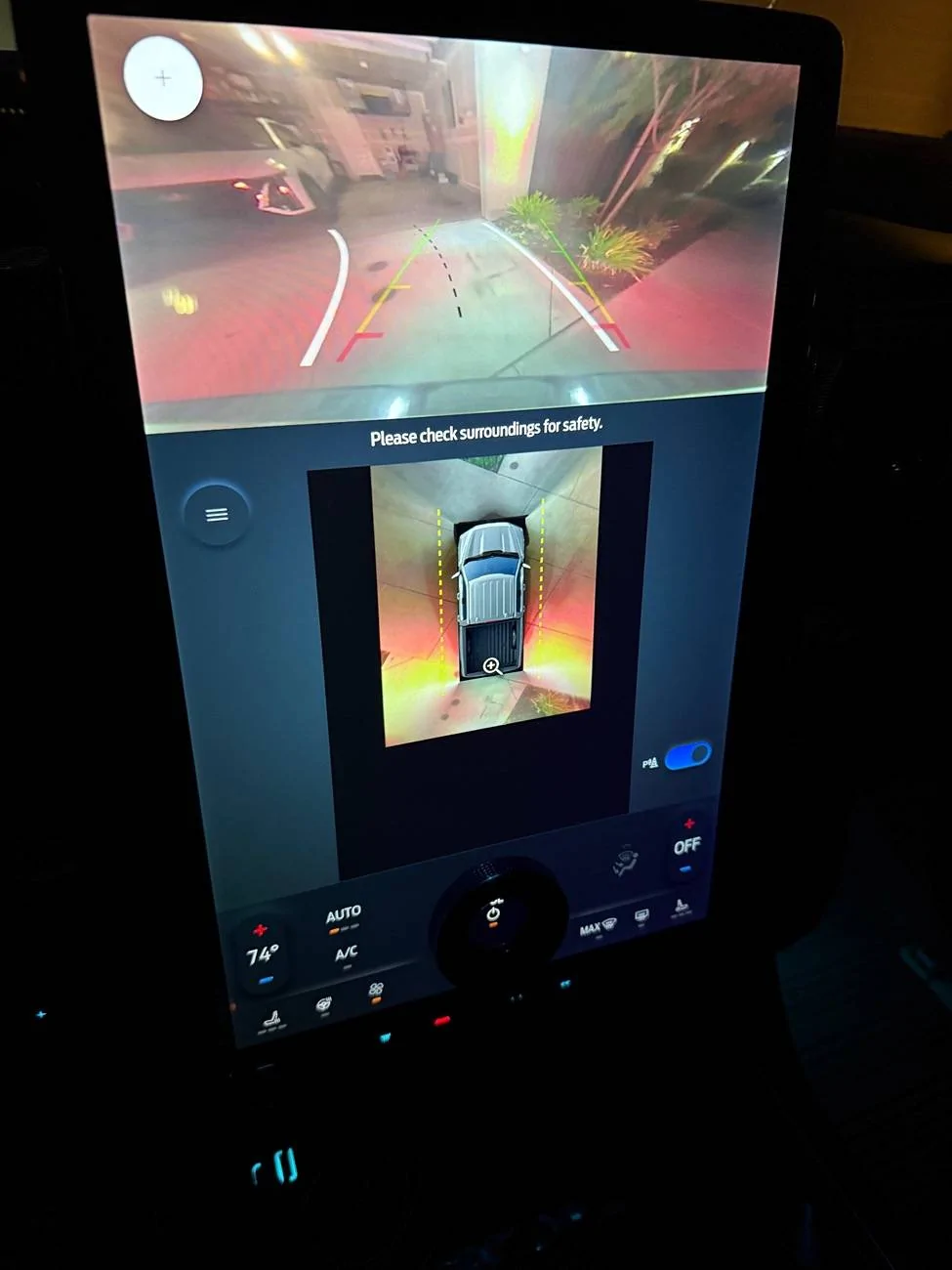

I recently had my 22’ lightning at the dealership for recalls and one was a software update. I noticed after I got my truck back that the surround camera view size has become tiny. Is this a bug in the update anyone has seen? You can see in he picture the area that’s blacked out where the view used to extend to. Called my service advisor and waiting to hear back.

This has been discussed in 24B56 thread. For '22s, the tech is supposed to run a configurator for the 360 camera. It's in the documentation for the CSP the tech uses.
I am having this problem right now. Can't seem to find the thread you're referring to. Can you point it out?
