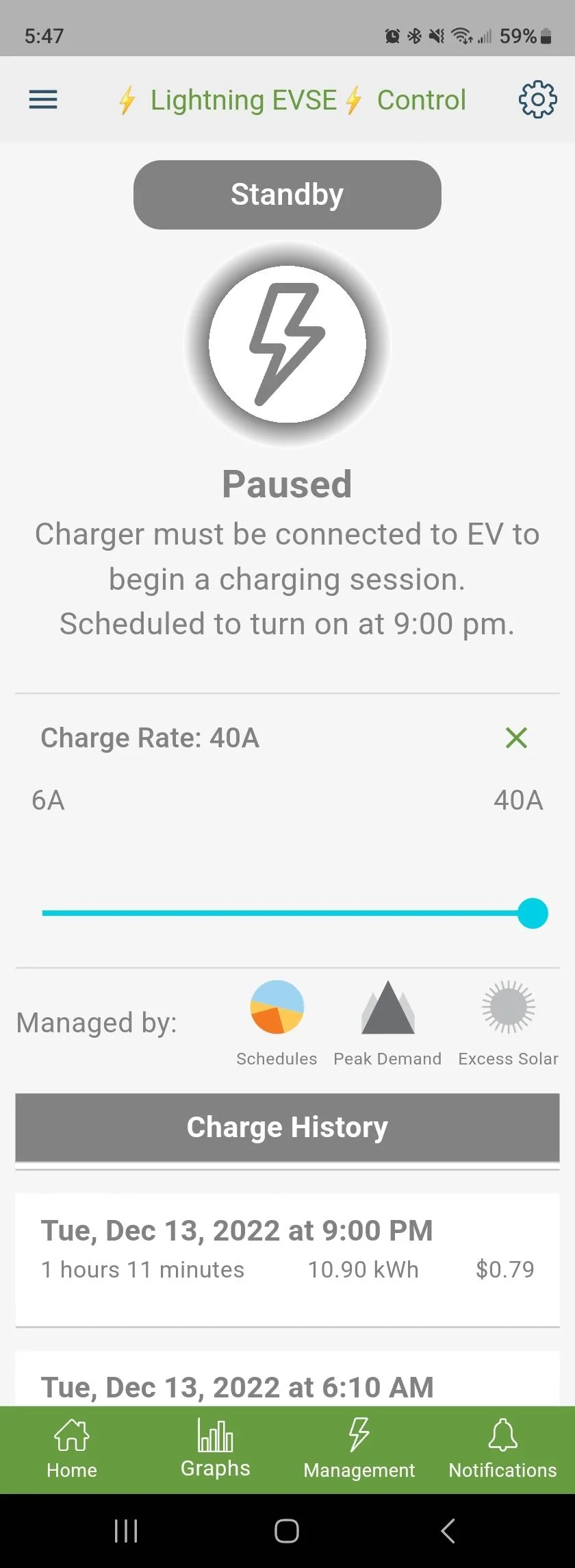

1. He was glad to see 60 amp wiring. He indicated that even though the emporia is adjustable, the adjustment is in the app and too easy for the user to just dial it up. He said only for models of chargers where the current limit is set by switches or jumpers inside the box would he pass a setup with wiring rated lower than the max setting on the charger.
When the Emporia is plugged into a 40a outlet it won't let you ramp it up to 48a (for what it's worth).

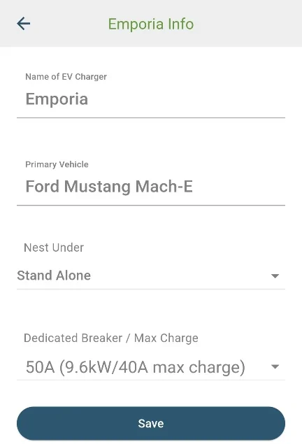

All you would have to do is go into Device Management and you can change it to a 60A circuit. You'd have to intentionally do it, so it's possible.
Yes, correct. I forgot the Emporia app had 2 sections to adjust Amperage. (Which is nice because it prevents us from accidently setting it too high)

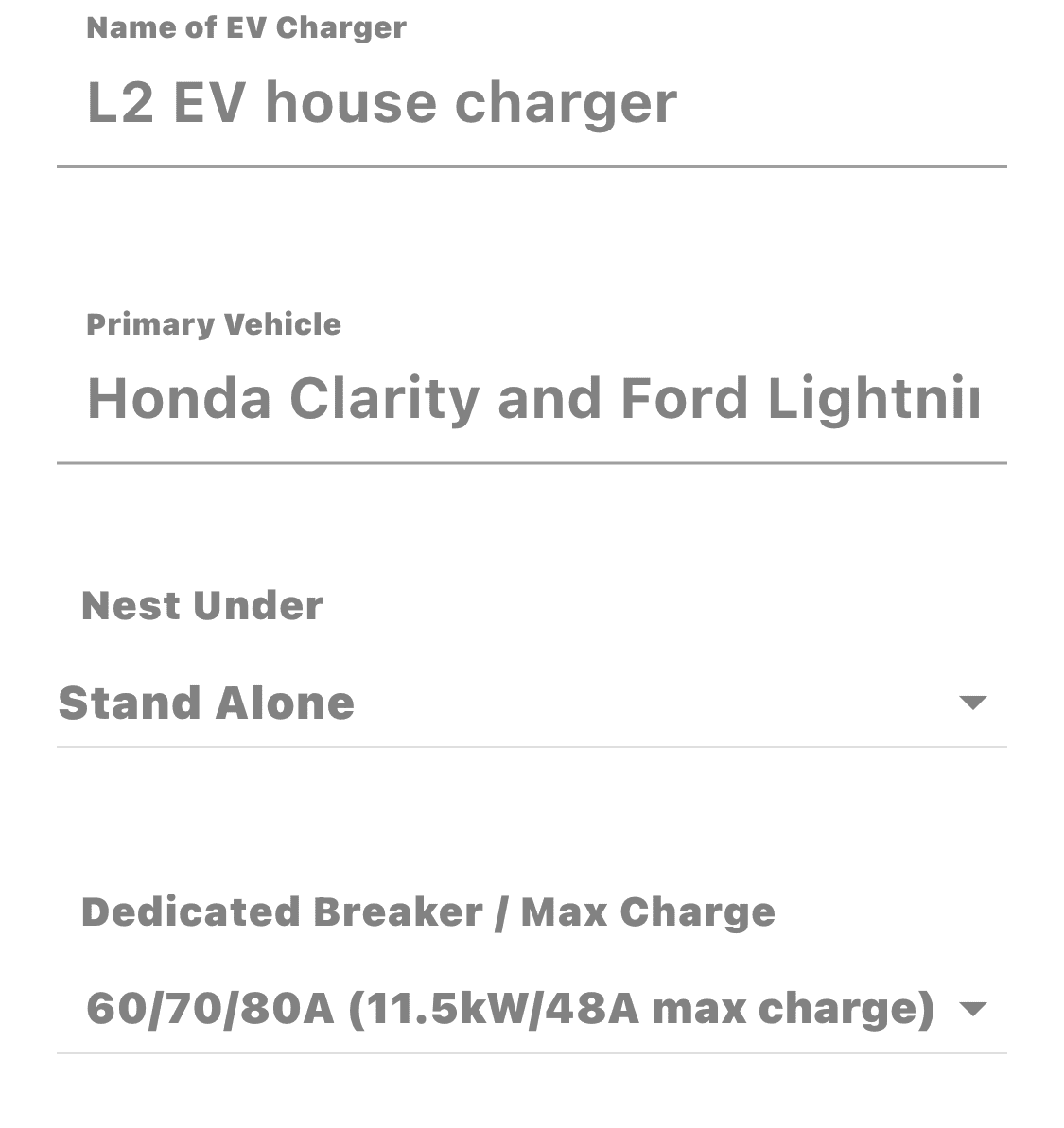

The holder on my Emporia is very solid - it's made from cast aluminum.
Mine is mounted on studs so it's very solid.
Mine is configured for 48A:
