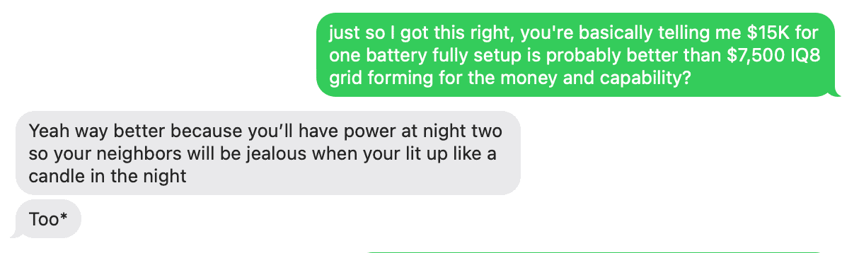

The current system that is being installed on my home doesn't have a battery in the plans. My installer texted me that in order to use the IQ8 grid forming tech I'd need to add the "empower smart switch, load controller, and critical load panel" for roughly $7,500. He followed that by saying the battery he was recommending wouldn't need any of it, which I believe was his earlier point of choosing a battery over the IQ8 grid-forming tech for the cost a few months ago during the design stage.

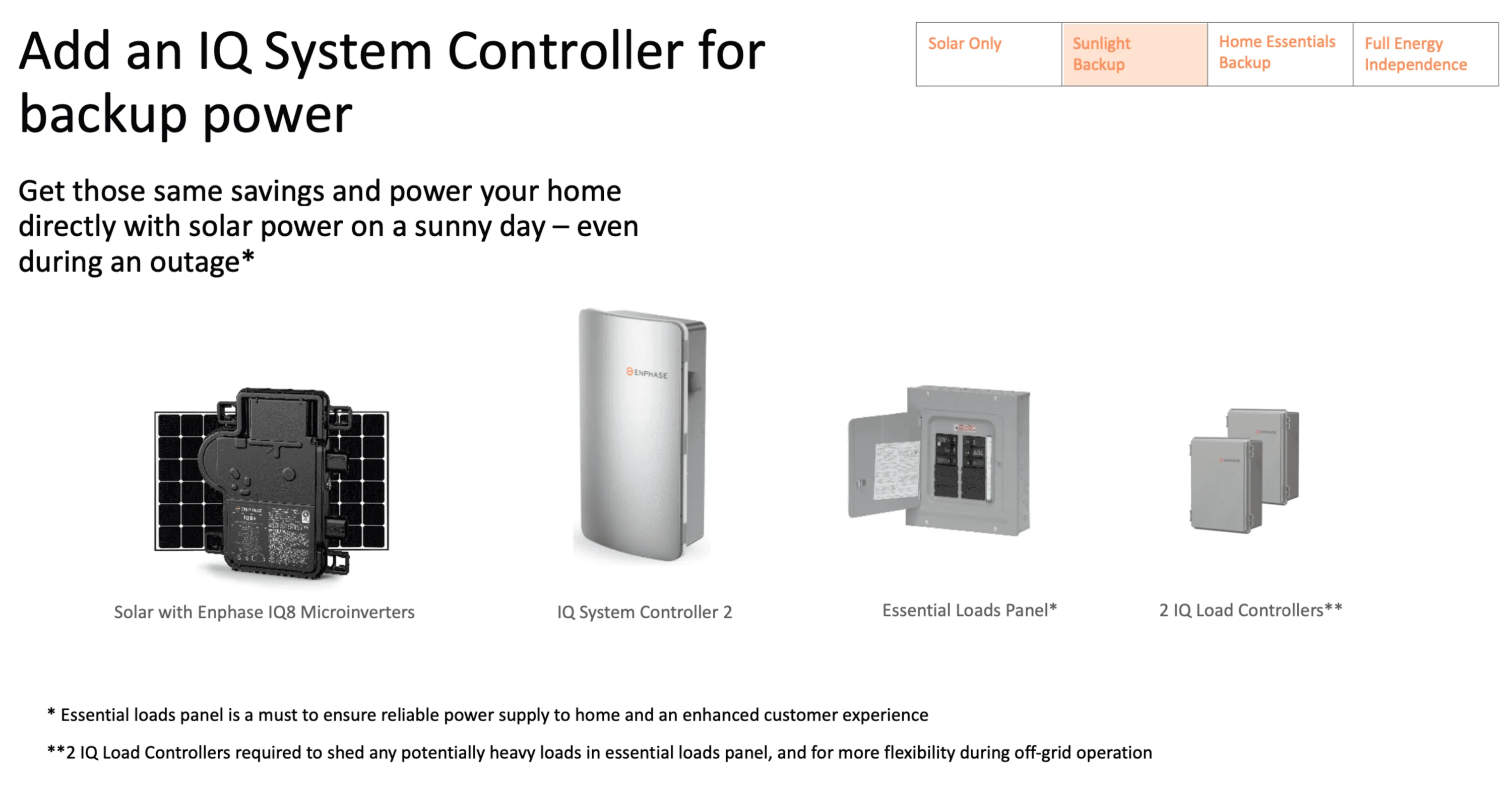

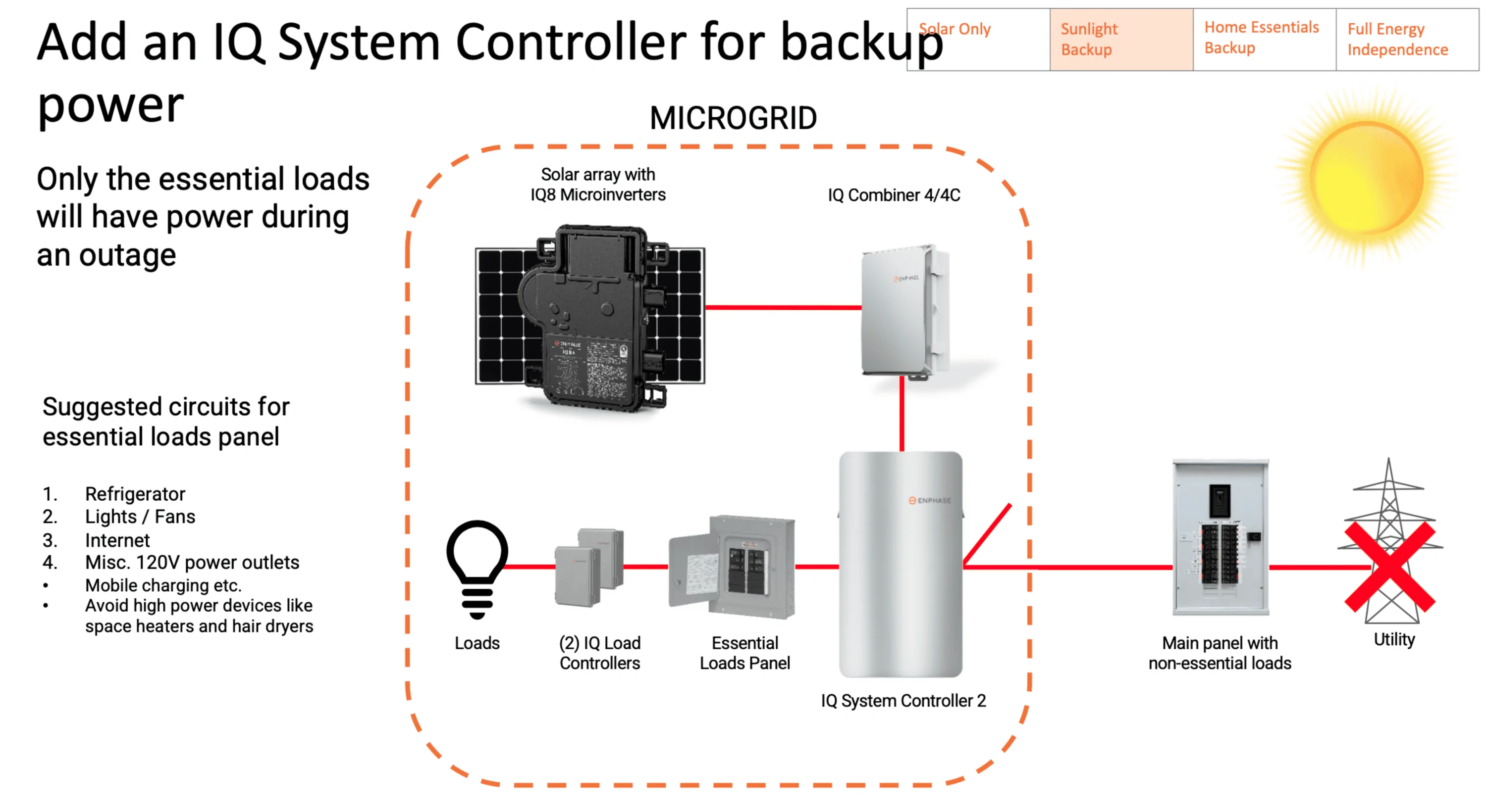

There are some other systems out there compatible with Enphase, Outback GD4048 and SMA sunny island that can also do this islanding. I have not looked into them all but I hear they work well. Perhaps that is what your installer initially referred to. I was looking from tech all from one company just for any warranty issues so no pointing fingers.
I think the generation shedding is done by simply turning off panels. For example, if you have a 16kW system with 40 panels it means you have 2.5% granular control of power generated. I assume you would see this real time in a maps of the individual microinverters. The smart switch is the system controller 2.
Here is what you need for sunlight backup. The IQ load controllers can be replace with a Lumin panel and do whole home backup and just pick the loads you want up to 16 circuits. Enphase has a 16 circuit upgrade coming early next year. Of course adding one small battery expandable with an EV battery at some point gives more flexibility while you drive to get a fast charge. The nice thing is with the system controller 2, a Distributed Energy Resourced (DER)/MID panel, you can add solar, batter, generator to the supplied inputs at any later time. All the power sources are additive, not either/or, a unique feature of the system since either the batter or the PV can form a grid and match phase and frequency to the utility grid or a attached generator. The only thing you can't do is run a generator and utility at same time ;)

His position is that installing all of the equipment necessary for the IQ8 grid-forming feature is an unnecessary expense compared to installing a battery that can power the house during inclement weather and darkness.

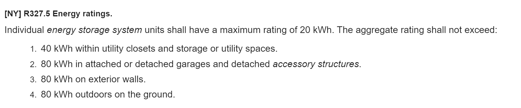

Finally got info back from the town of eastern long island and here is the issue for the HIS in NY at least
Ford F-150 Lightning Talk me out of a HIS by Sunrun 1663597640909
NY so far does not have a provision in their electrical code to allow for ER battery

I believe they are misreading the code. Or, actually, almost deceptively quoting it. Here is the preamble to R327, which exempts vehicles from 327.2 thru 327.11.
[NY]R327.1General.​
Energy storage systems installed in buildings or structures that are subject to the provisions of this code shall be installed and maintained in accordance with Sections R327.2 through R327.11. The temporary use of an owner’s or occupant's electric powered vehicle as an energy storage system shall be in accordance with Section R327.12.​
