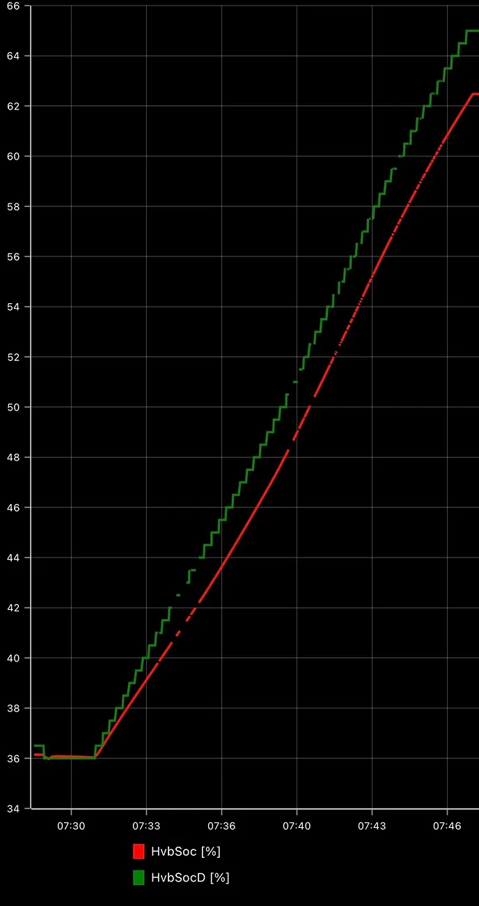

Today I noticed that my SoC displayed and the real SoC of the battery when it got down to 36-ish % where pretty much the same.
I went to a fast charging station (Tesla…BTW those short cables are the worst) and payed attention to these values and the displayed one started going back higher than the real SoC.
Here’s a graph of it.
Can anybody speak to it?
TIA!

Yes, there is a buffer on both the bottom and top end to protect the battery. So 100% displayed is less than 100% actual, and 0% displayed is more than 0% actual. (Though we cannot use the buffer... if you hit 0% displayed, you're done driving lol)
So it is a mathematical certainty that the actual and displayed values will be the same somewhere in the middle.
