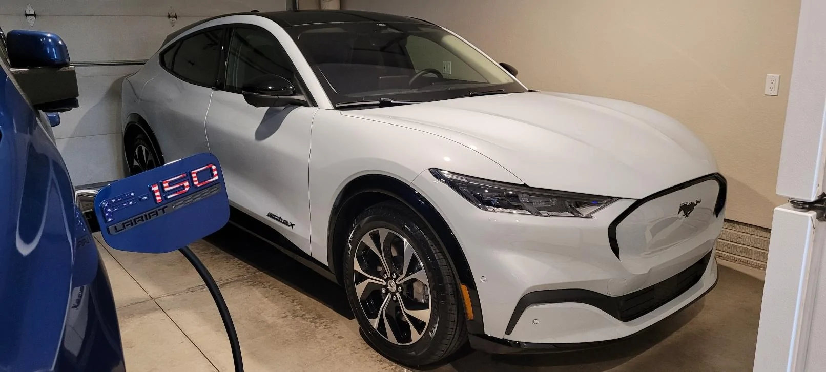

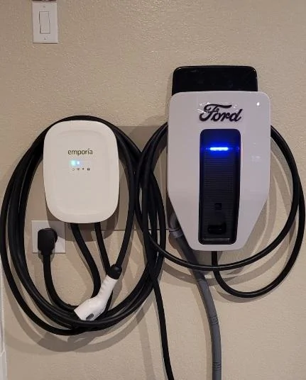

Besides, it seems a bit ridiculous to have 2 different chargers in one garage.
Doesn't seem ridiculous to me. 2 chargers means I don't have to worry about which vehicle is plugged in. They both are.
