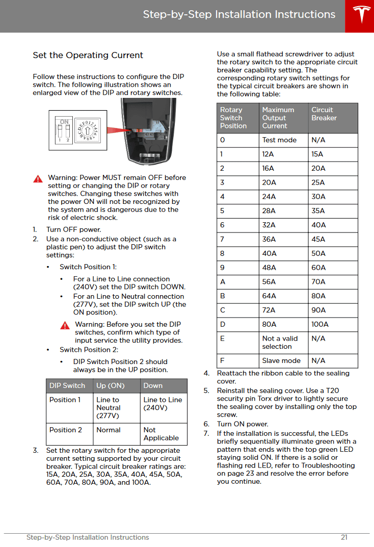

I have had this 48a compatible adapter connected to my Tesla wall charger to charge up my truck for nearly a year. Works absolutely perfect until an update to my Truck 3-4 weeks ago. Now my truck stops charging... and the Tesla wall charger seems to run hot (goes into overheat mode) after running for an hour or so. Tesla charger works 100% fine for the wife car... runs at full 48A charging rate with no issues at all.
Something definitely changed in the Lighting software. Trying to figure this out. The cable running hot, and eventually triggering "overheat" mode makes me think the truck is trying to pull more than 48a (60a breaker)? Is this a setting somewhere to set in the truck for home charging speed?
Truck works fine at Electrify America fast charger... just having issues at home now for some reason. Anyone else experienced this?
