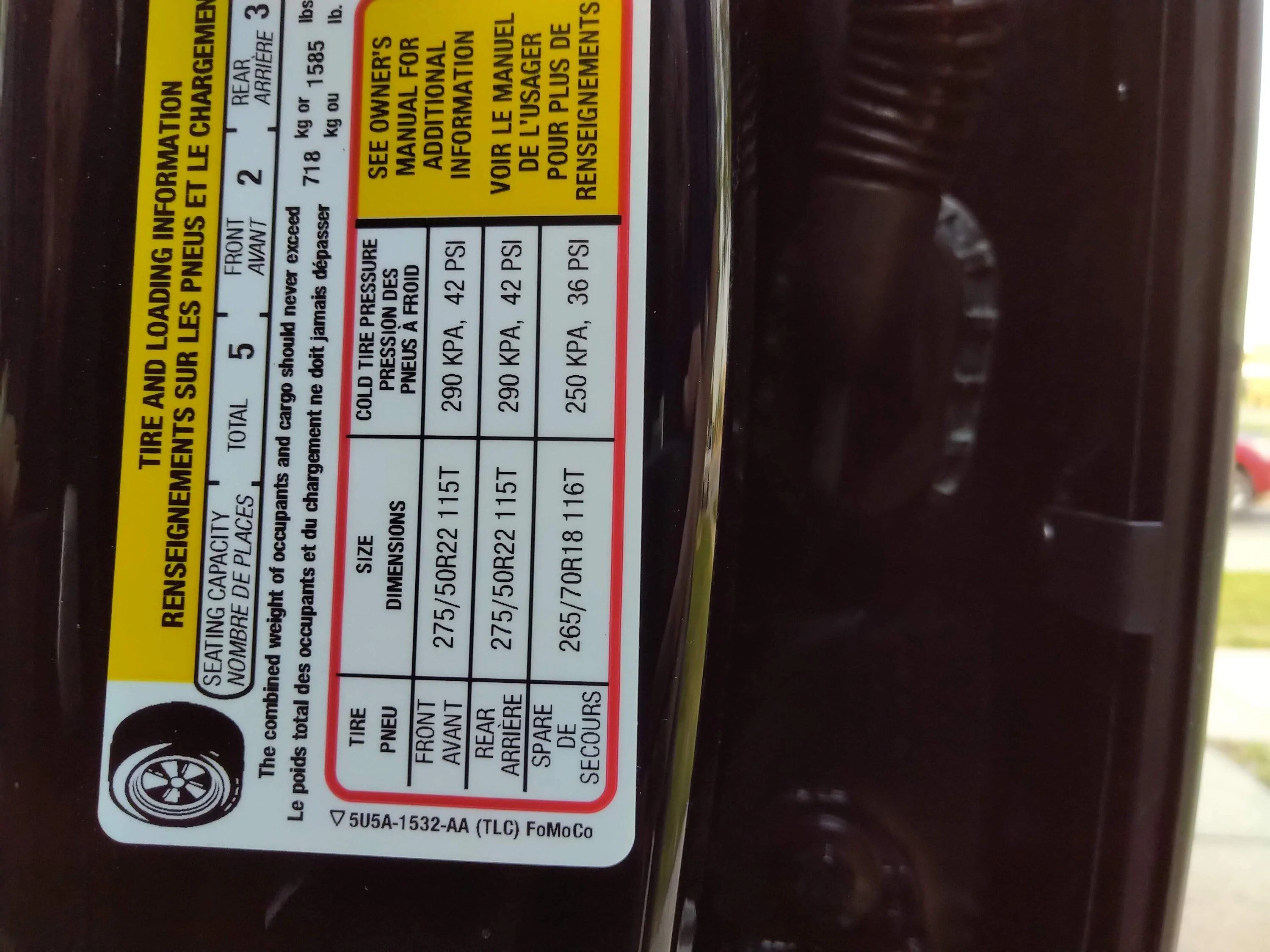

Can a platinum owner please post a picture of their door jamb sticker ?
I've been unable to find something somewhere that tells me what pressure the 22s should run.
(I have a Lariat)

From memory, 42 psi. I was under the impression it's the same for all wheel options. I have Lariat wheels that I run the same as the Platinums.?‍♂

Here is a picture of the tire pressure sticker off my platinum. The correct pressure is 42 psi.
