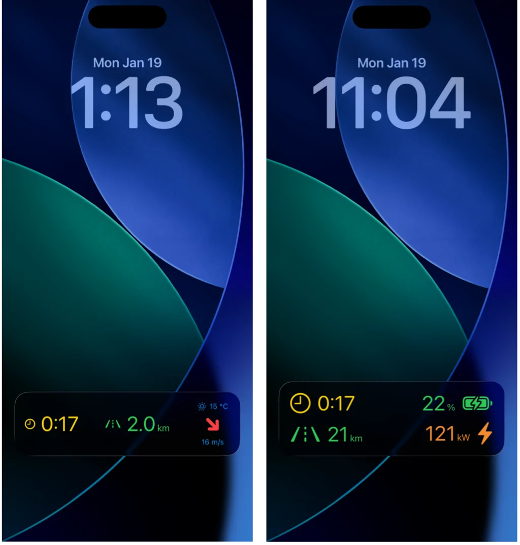

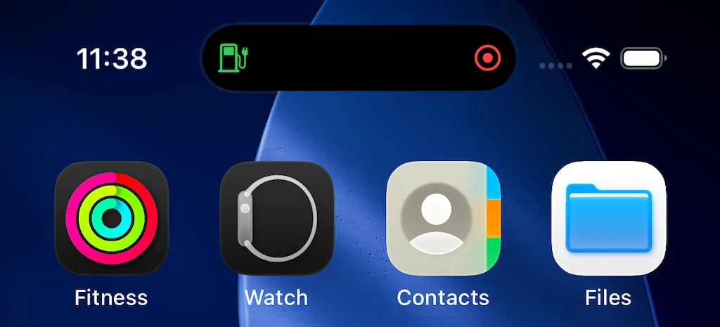

Detour this weekend into letting you know the app is recording in the background so it now has support for Notifications and Live Activities.
The optional notifications allow your Apple watch or phone has connected to the scan tool and when a trip or charge starts - no need to visually check the phone.
And if you keep your phone in some sort of holder, you can see what the app is doing in the Dynamic Island. These displays vary but you can count on the red recording indicator to let you know a trip or charge is being recorded in the background.

The lock screen shows even more detail, here are the trip and charge live activities rendered hion the simulator:
Ford F-150 Lightning Trip and charge logging iPhone app for the Lightning 1768846514494-ya
You can see the trip duration, distance travelled and weather conditions (left screenshot) where the arrow is your headwind indicator, here you are currently driving in a quartering strong headwind. The arrow rotates as your course changes where the size is an indication of the wind speed (light, moderate, string) and turns green when you have a tailwind.
On the right is the charing lock screen with elapsed time, SoC, and current power, Ford users won't see the range added since I don't know where it is in the Ford Can bus universe.😬

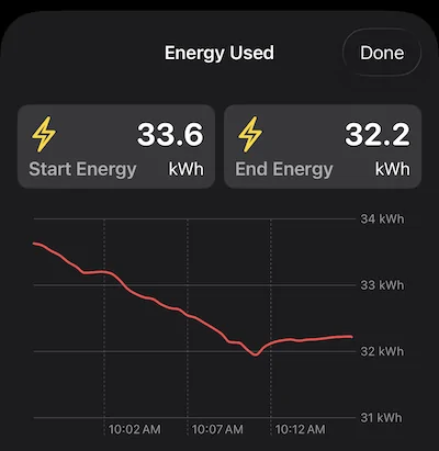

The bad news is that I have been using the Energy to Empty DID and it has been close to that reported by the Ford Trips applet on our 2022 Mach-E GT so didn't notice this. I have been wondering why my Lightning has been more efficient that my Mach-E and did a deep dive into the data.
For example, here is my morning commute today in 4℉ temps:
Ford F-150 Lightning Trip and charge logging iPhone app for the Lightning 1769788203063-m1

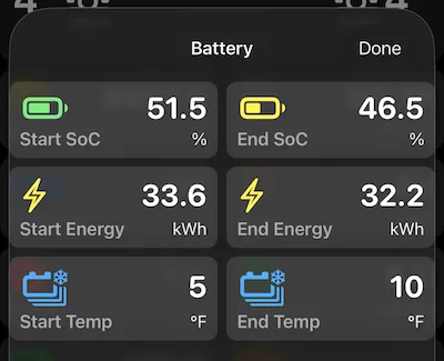

Only in my wildest dreams would I see 5.3 miles/kWh, maybe descending the Rockies with a tail wind, so I look to the HVB battery temperature for ideas and see:
Ford F-150 Lightning Trip and charge logging iPhone app for the Lightning 1769788498008-gn
SoC down 5% - check, EtE down 1.4kWh - impressive, battery temperature up 5℉ after an outdoor overnight soak - check.
What I did not realize is how much the reported Energy to Empty depends on the HVB battery temperature during this trip:
Ford F-150 Lightning Trip and charge logging iPhone app for the Lightning 1769789025752-6
which is leading to inaccurate efficiency calculations.
Ford is skimpy on reporting energy values, even the HVB power has to be calculated by reading the HVB voltage and current and multiplying to get the power. This leads me to think the proper solution is to do that and then integrate the power to calculate my own energy value.
The same holds true for charging, I charged to 100% overnight and the ending Energy to Empty was 124.8kWh at 57℉ and the next morning when I left Energy to Empty was 111.7kWh with the battery at 30℉. Maybe a silver lining in all of this, what if I could calculate a range estimate from Energy to Empty?
