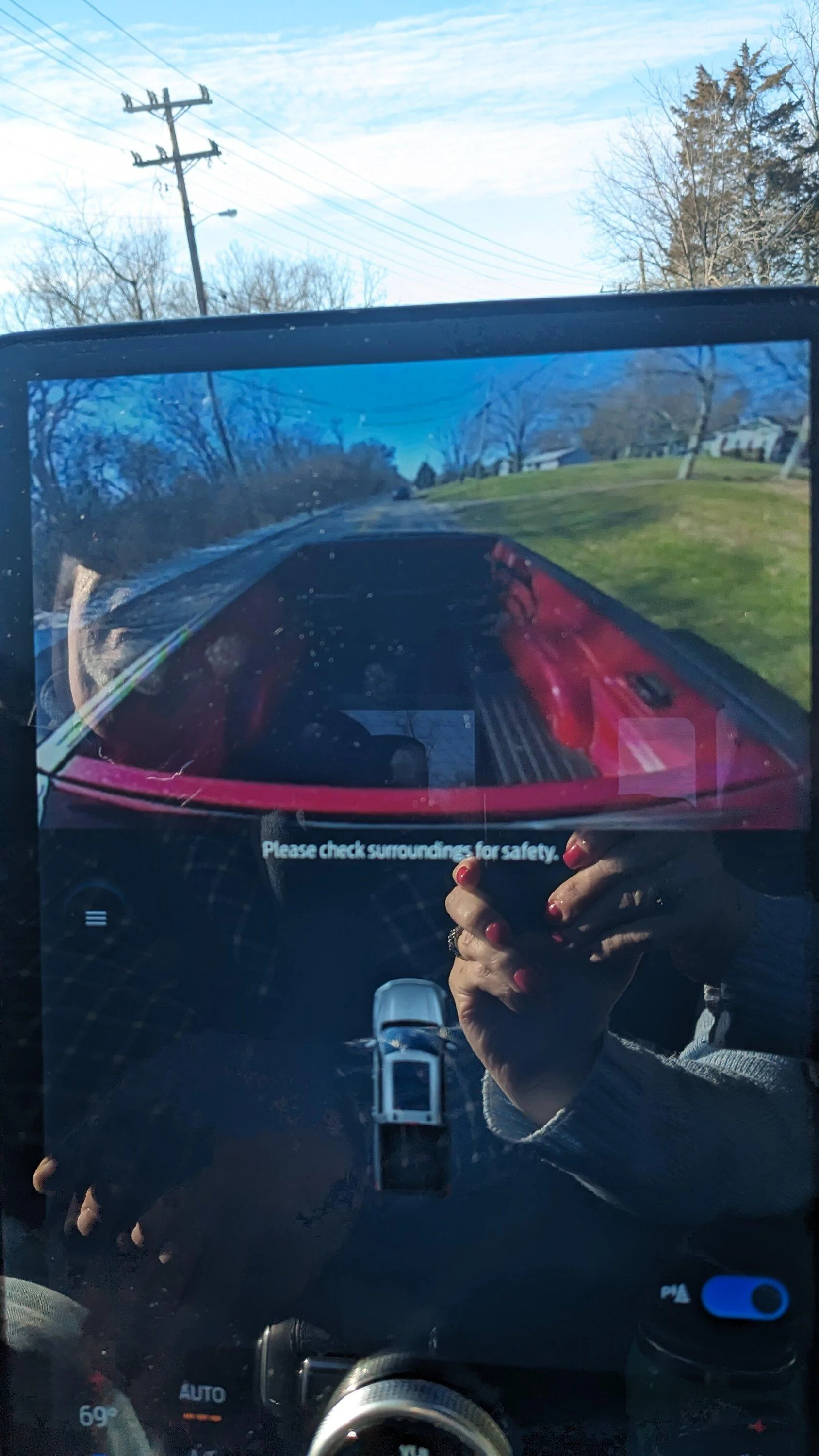

@Ford Motor Company I don't know if this was on 6.5 or 6.8 update, but I have lost the camera close button when at speed. The climate control is also greyed out. The close button is there when stopped. Attached is a pic that my wife took while I was driving. No X button on the upper right.

Ya, it was 6.3 or even earlier that they messed this up
The close button pops up at exactly 10kmh. Their programmers botched the code.
It's stupid and annoying, especially if you hit the button on the highway. Recently, all these updates coming in fast and then redone shows how poorly managed their development team is.
Ideally, I would roll back mine a few versions to get these bugs gone and live with it.
I'll say it again, but I'd love to know what the problems are with bluecruise and all these updates they've been botching. I'm at the point of just guessing what could be wrong but the only thing I can think of right now is that the hardware can't keep up with the software and they're trying to skirt it by hacking away functionality.
I still love the truck and it is still functional, just a giant pita figuring out these new bugs and how to deal with them. I know better than to turn my cameras on at speed now.

Yep. 6.1 for me back in October. It’s a pain because I use the cargo camera often at speed. I reset sync to get back, but kind of a pain of a work around.

I have the same issue. You can't hit anything on the screen to leave the camera view. What you can do is press the physical parking button under the display. This gets you off the camera screen, so you can close it out.
Great suggestion, I hadn't thought of that. On the highway I fold my mirrors and use the rear bed camera if changing lanes. Thank You for the work around. Hopefully @Ford Motor Company will get a fix out soon!

I have had this same issue. Another work around is if you choose a different camera, the X will return and you can close it out. I didn't even try and bring this up to my dealer because it would be a waste of time. My bed camera goes in and out intermittently because of an apparent electrical issue, but my dealer seems to be convinced that an OTA removed the bed camera functionality. If would be great if these service departments were a little more informed than the customer when it comes to these types of issue.

The park assist method works, but if you switch from the bed camera to the rear camera, the exit button reappears.
