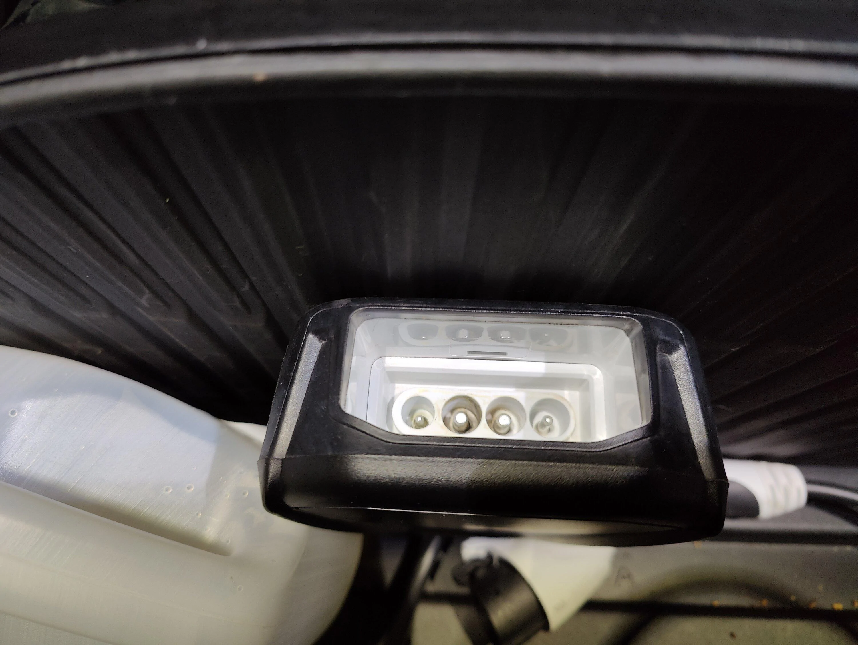

Hello All - I recently had many faults with my mobile charger (yellow/amber light). When I unplugged the 240v attachment, water came out of the main charger (maybe 2 teaspoons). As you can see from the picture, there is definitely some scorch marks around the pins. I believe this charger is suited for outdoor use (IP67), so I never really thought twice about leaving it out in the rain. The attachment was secured tightly into the charger, so I know that wasn't the issue. This is more of a heads up for users who rely on the mobile charger as their primary source for charging.

Doesn't look like scorch marks looks like grease or dirty or both. The metal contacts good pretty good no arcing. I'm glad I removed that from my order and got a better quality charge for less than $500.

I thought the same, but these do not wipe clean. It also wouldn't explain the faulting charger. I think it was a good decision on your part to select a different charger.

When you charger was out in the rain, was it mounted to a wall?

Just a quick update. Ford replaced the mobile charger under warranty. Unfortunately, they did not send the dealership the attachment plugs. So the waiting will continue. The dealership has been great throughout this.
