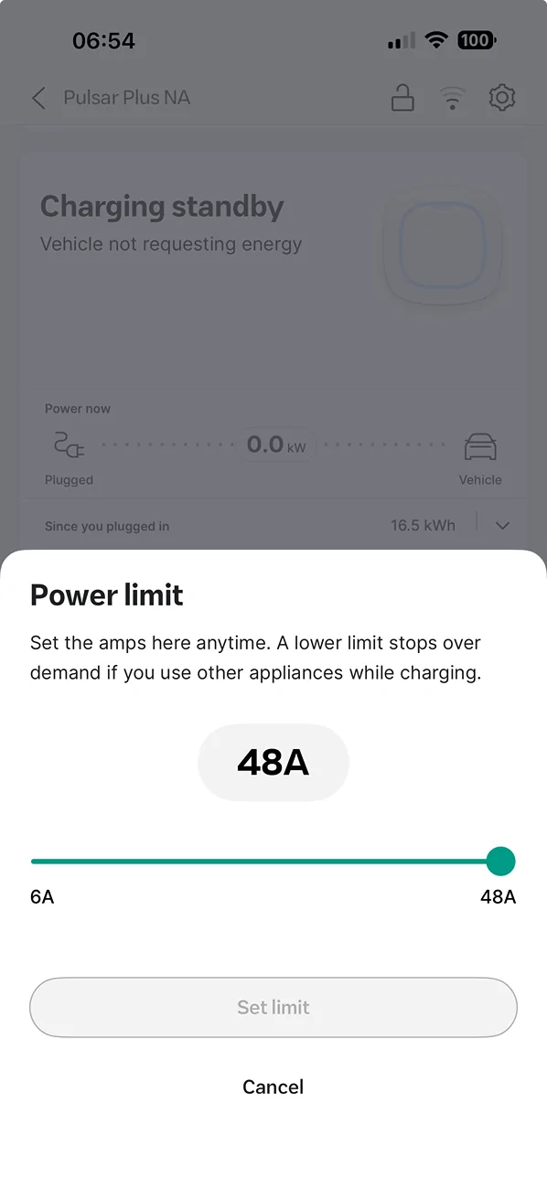

I have a Wallbox Pulsar Plus that I use occasionally for the truck, but I haven't run into your issue. You might try downloading the Wallbox app and see if you can log into the charger. It should show up in your blue tooth list. The Pulsar plus is software adjustable but I haven't had it derate on its own

It's possible that whoever is the owner of the circuit it's connected to intentionally dialed it down from the app thinking they were going to save money on their electric bill.
Ford F-150 Lightning Wallbox vs Lightning Wallbox_Power
Or it could have been limited due to the wiring or the length of the run.
Mine is set to the max for a 60A circuit with the correct gage wire.

I have been using a Wallbox to charge lighting and Mache for a year and a half. No issue. There is a hardware limiter that can be set )overrides what is in the app). I think the lowest setting is 16 amps, which maybe is equal to L1.
it may have been set that way by mistake or because they rightfully limited it to match the limitations of the circuit.
