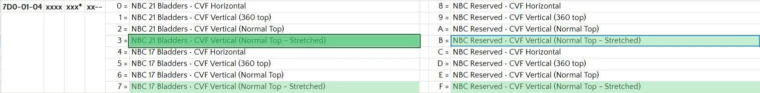

I understand the FDRS APIM 360 Configuration button is not working but it is literally a one digit change in FORScan

Could you sent the forscan address? I want to ensure I was using the correct one.
Jasin
Jasin
Jul 7, 2022
65
2022 Lightning ER Lariat
APIM (as built)
7D0-01-04
xxxx xxx3 xx--
Change this character from a 2 to a 3
I don't have my truck pulled up so I can't give you the Checksum (the new last 2 characters) but it will fix it after the warning or they can pull it up on any truck in the lot

APIM (as built)
7D0-09-04
xxxx xxx3 xx--
that the same one I used. Thanks.

I took my 22 lariat er in today for the front parking sensor and frunk csp’s. I now have the small 360 camera issue. The service manager informed me that they can’t get the camera back to its original size even after loading the apim and doing step 11. He took me into the service area and the tech showed that me it wouldn’t take. It was throwing a “configuration not applicable to this vehicle” fault. They escalated the problem to a field service tech. Has anyone seen this before? Tia!

APIM (as built)
7D0-01-04
xxxx xxx3 xx--
FORScan will correct the checksum on its own.
Wait, you are saying you did this and it didn't fix the issue? This would be a first.
Edit: Your truck has the 12" screen. What value was there before you changed it to a 3? If there was a 2, you change it to 3. If there was a 6, you change it to 7. It there was an A, you change it to B and it there was an E, you change it to F.

I just picked up the truck. They say it’s fixed but I’m not sure. Are there supposed to be buttons on the left side of the screen now? Also the forscan value I changed was 7D0-09-04-xxxx-xxx3-xxxx
Not sure about the buttons on the side. The OS on the Lightning is different from my truck.
09-04 is not the right location to fix the camera view.

Did I post that publicly somewhere? If so, link me to where you got that so I can correct it asap please.

Correct the location in your posts please to avoid confusion to anyone that comes across this. I fixed it in mine already. Sorry for the mix up.
Edit: 7D0-09-04
xxxx xxx1 xx--
A 1 there is what it should be. The 3 added a button to your touchscreen somewhere for a power liftgate which is for SUV's. No big deal, but if you guys changed this to a 3, change it back to a 1 just so everything is how it should be.

@awilli1010 @Jasin Sorry for the multiple posts, but I edited my prior post with the correct value for the 09-04 location and wanted to make sure you guys saw it after I edited it.
