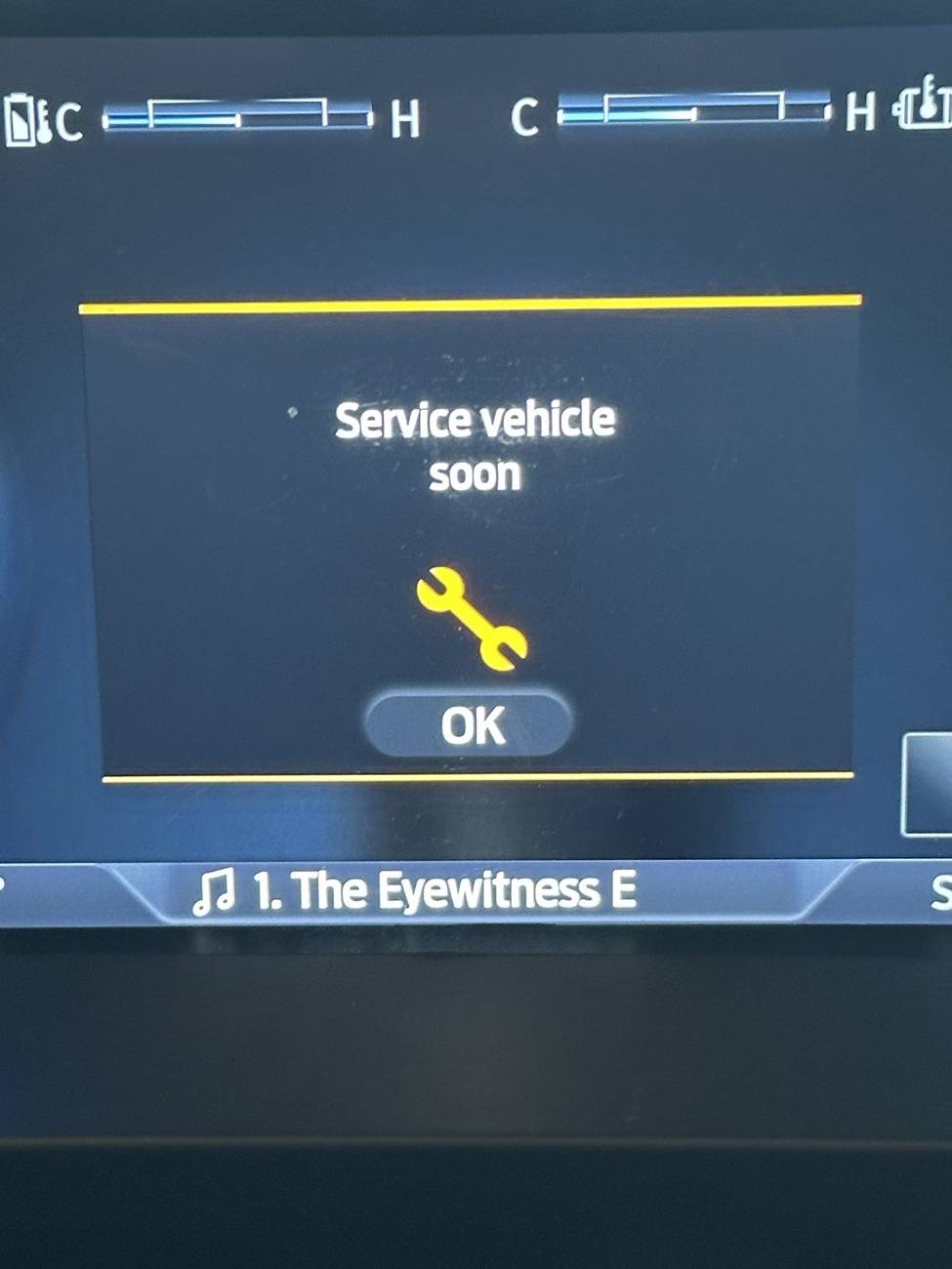

I’m at 43,111 miles and received the service soon. Battery won’t charge above 63%. Appointment with dealership scheduled. ?‍♂

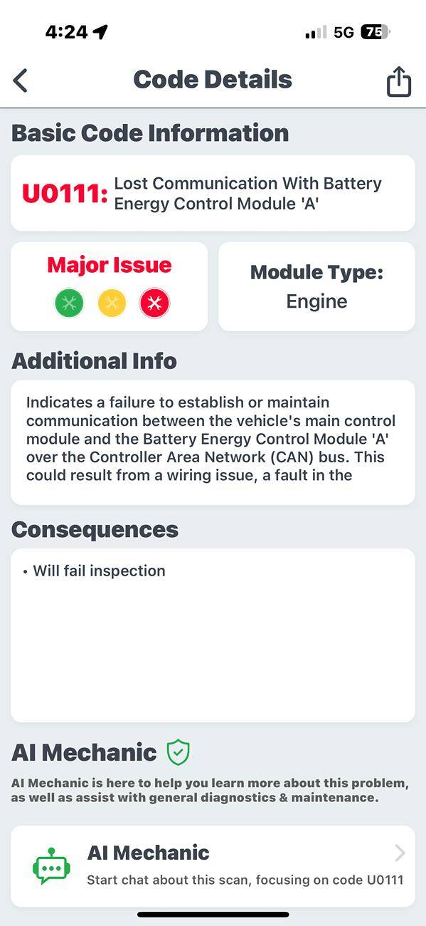

I noticed a few posts here with codes being read, is that using an off the shelf OBD2 reader? Phone app? Is there a forum favorite?
I trust my local dealer, but I'd like to be able to verify what they say and if think a code ready is a good first step...
