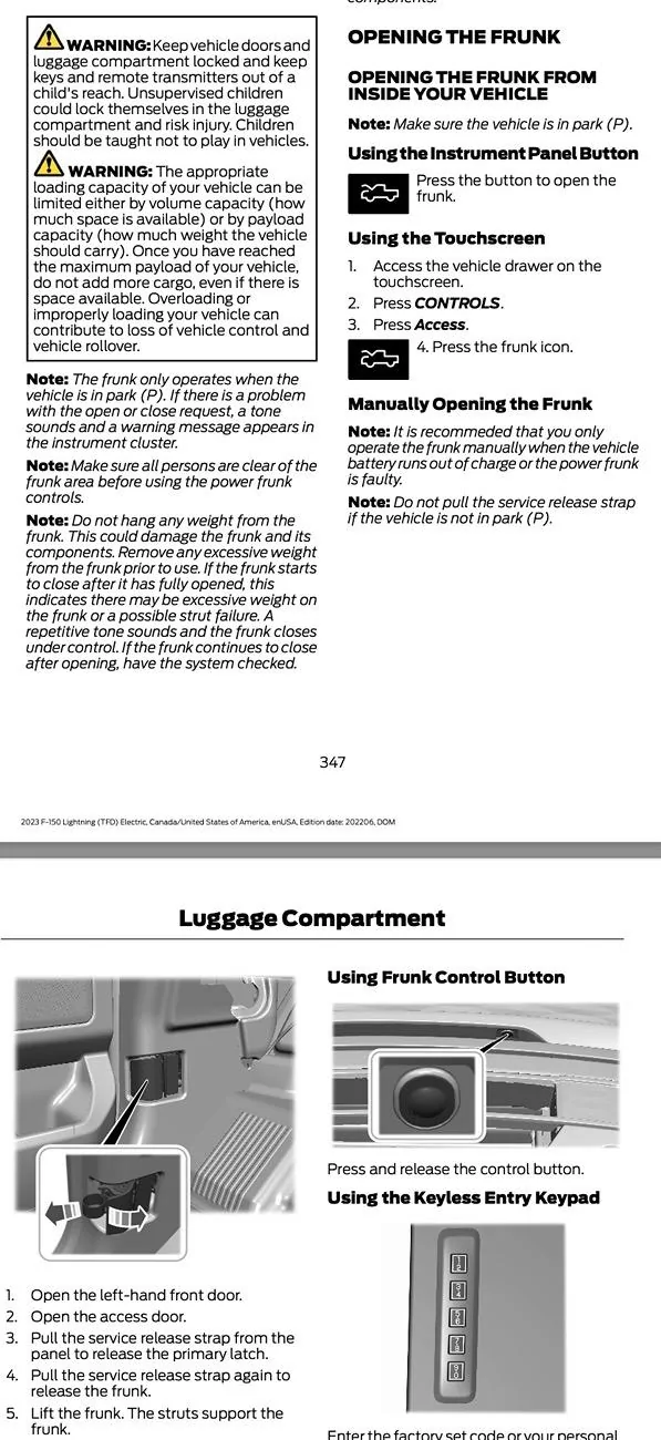

Just thinking, since the 12 volt battery is in the back of the frunk, and the frunk opens electrically. How would you access the 12 volt battery if it was dead or drained?

Red ribbon release on driver's side left near floor.

2023 Owner' manual p.347
Ford F-150 Lightning What if Screenshot 2024-07-31 at 10.18.17 AM

Thanks for posting. The owners manual is useless if the battery is dead and you can't access it through the big screen. So I print some pages like this to keep in the truck.

Just download the manual to your phone, it's searchable and takes no paper. Search here for the pdf.

The manual is also available via the fordpass app, it's a PIA to drill through.
