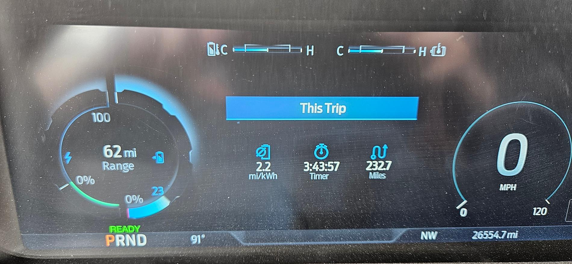

The range of the Lariat with a 131 KWH battery pack is approximately 240 miles, at 100 percent, and on cruise set at 70 mph. This range will be lower when you get to some of the hills you will encounter. You should only charge at 100 percent when absolutely necessary because it will reduce your battery life but if you plan on trading it in every 2 to 3 years than don't worry about the life of the battery. The heat at my ranch didn't affect the range to much but it was only 100 degrees when I had my truck there so there might be a greater loss while it is 122 degrees in the places you will be driving. When you drive over 200 miles and charge on a fast charger, you will find the range at 70 mph will be a few miles shorter in range and each time you charge that day you will lose a few more miles of range on the same terrain, going the same speed. I have owned many trucks in my lifetime Chevy, Dodge, and Ford and while they were great vehicles for towing and all around fun, they were not as comfortable as the Ford Lightning. So for comfort, I say yes go ahead and take the leap but for range, you might want to take a moment to think about it. To charge to 80 percent takes 44 minutes or more and to charge to 90 percent it takes 66 minutes or more. If you want a 100 percent charge, you are looking at over 2.5 hours to charge it. When you go to a rural area you should probably buy yourself an inverter generator that is at least 9 KW with a minimum of 7.5 KW of continous to put in your truck bed to ensure that you can make it to a charging station because you not only have to figure in the distance to the site, you have to be able to get back if there isn't a charging station nearby. I hope that you have answered a few of your questions.
The range is better than you claim. Here's a straight shot from north Tucson, AZ to Deming, NM from July 3rd. We had to make a quick stop at the pharmacy before we left. I followed semi trucks going between 70-75mph where possible. AC was on high the whole way plus the seat warmer (wife needs the cold air to not get car stick but then got too cold ?)

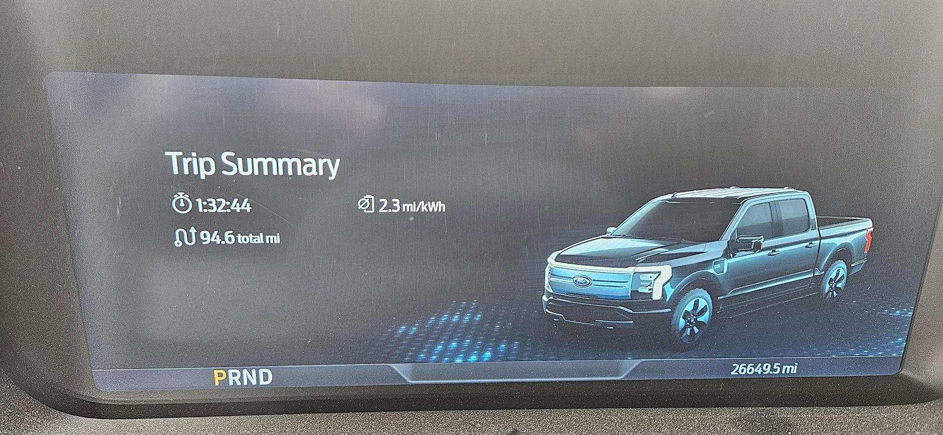

Here's Deming to El Paso, forgot to takea pic before shutting off. We charged to 65% and arrived with 32%. Oops, forgot to add the pic.
Ford F-150 Lightning Will it fit me? 1000005716

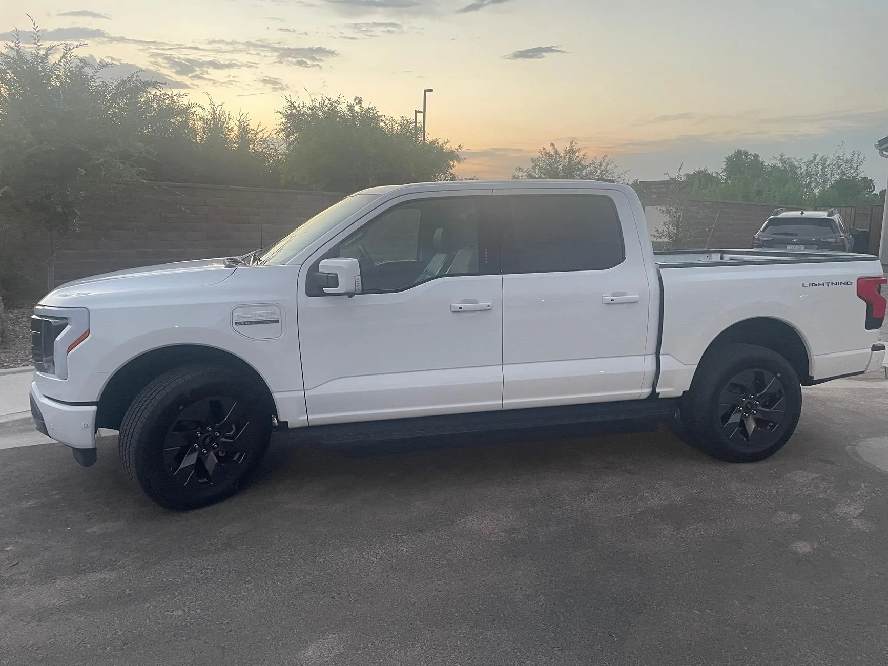

Appreciate everyone's comments. After much deliberation I pulled the trigger on a '23 Lariat ER yesterday.
Im in love with the truck, and knew I would be, and hope that it will serve me well. Looking forward to seeing how I can integrate it into my day-to-day. Now time to accessorize!
Don't even bother dude, he's not interested in reason or logic, he will not entertain any ideas that break with his preconceived notions that the truck is trash and we're all delusional. You will get nothing but wall-of-text rants in response from him. Save your own sanity.
Ford F-150 Lightning Will it fit me? F1A83226-93CE-4AED-A1A4-DDFF56DEED1B

Congratulations! Hope you enjoy yours as much as I do mine.
