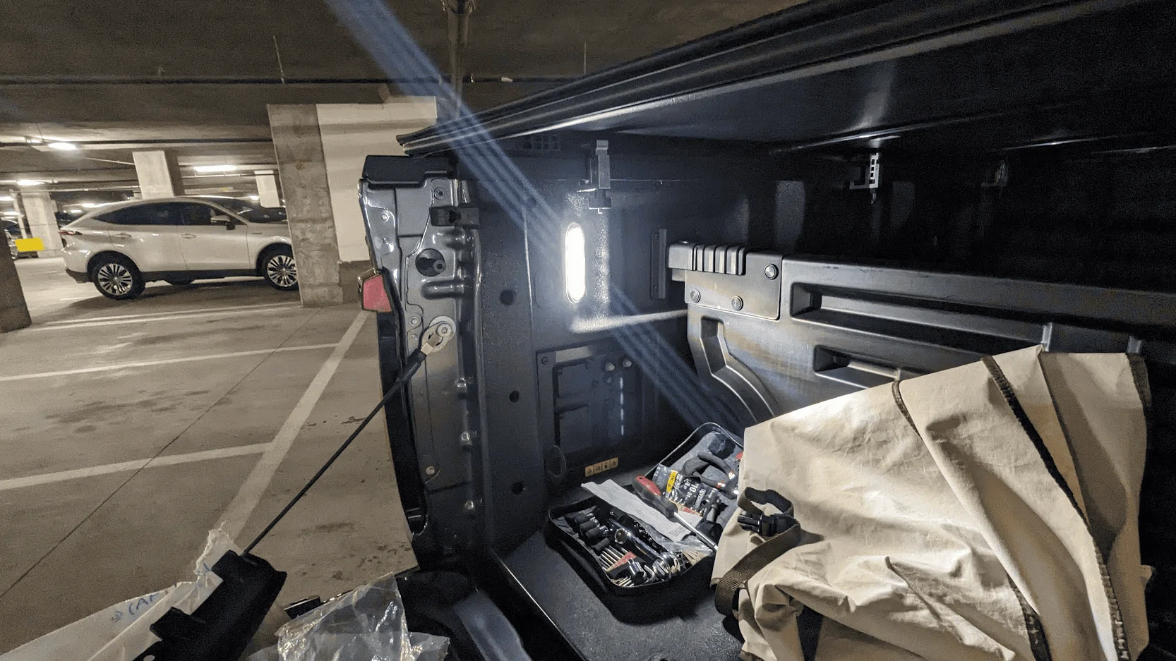

Update on my 22 Pro. It is working no problems. Installed the lights and enabled the options from FORscan.

Never used the Ford harness plugs before so I messed up the driver's side a bit, including one of the black pieces that holds the wire to the truck for my pro power. I'd suggest if you are like me, do the passenger side first so you know how you should get the dummy plug out easier.
Now on to learn about forscan.

Passenger side was really easy. I also struggled with the driver's side. It was also blocked by another cable but eventually figured it out.

I’m in the same camp of the mod not working. I have a 23 Pro with all of the options available so maybe that is it? I checked the connections but everything looks good. @BennyTheBeaver it may be the FORScan version? Mine is 2.3.51 test 20230203. All of the success seems to be from the first people trying it. I see it in zone lighting but the button doesn’t toggle it on/off and neither does zone lighting.
It was user error as I only enabled the bed lamp and not the other two options. Once done it all works (well other than the switch which I broke trying to reconfirm all my plugs. ).
