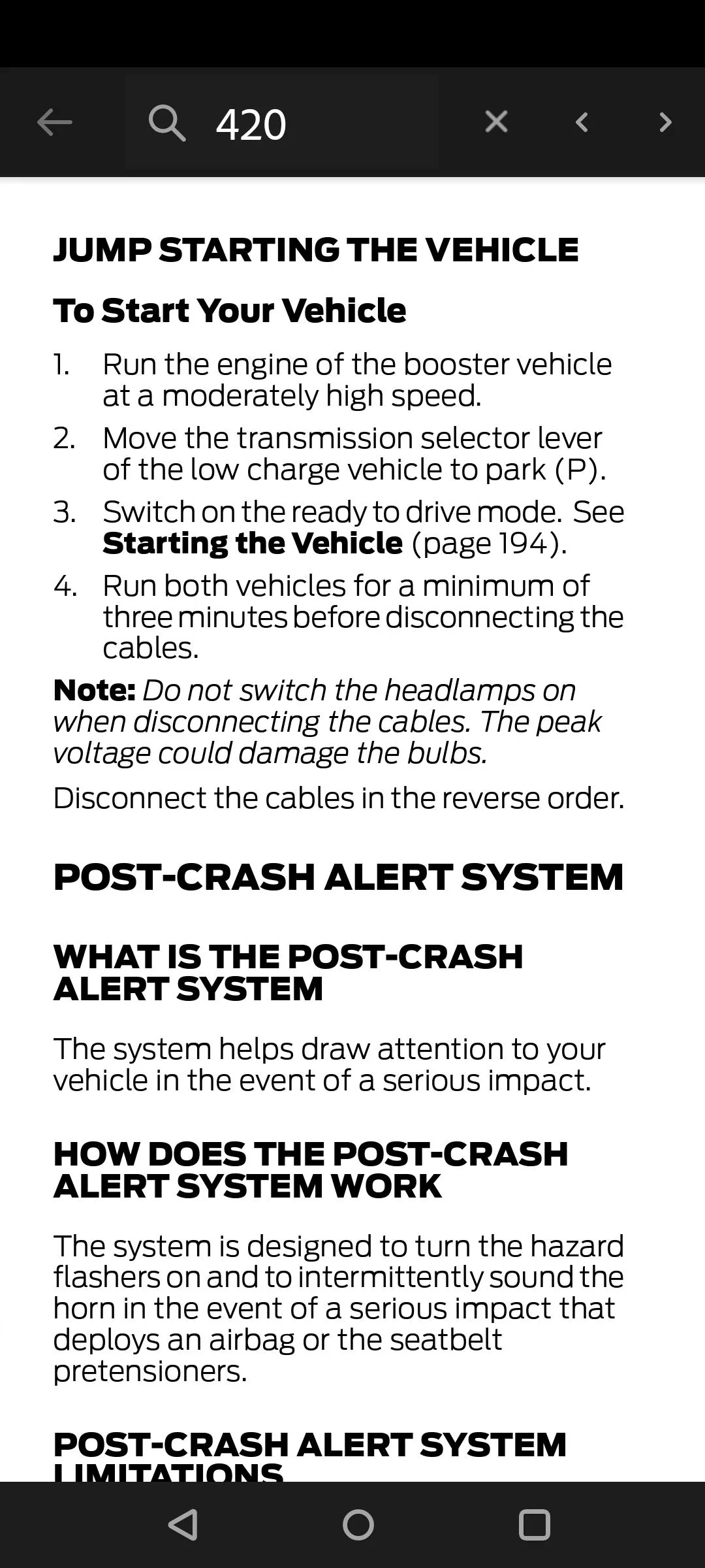

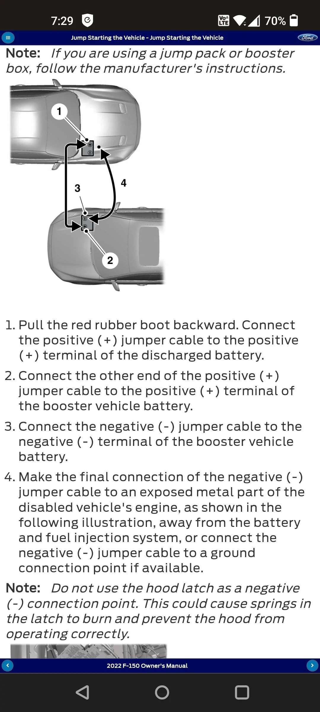

Looks like Lightning Manual doesn't even mention using it to Jump another vehicle. The ICE, Hybrid Manual mentions specifically " Jumping other vehicle, Lightning only mentions "to start Your Lightning. One capability that is lost on our Lightning. I know you can use numerous Jump Box options, but the cable to Cable via the battery isn't happening. Owners need to stay quiet when someone needs a jump from their BEV 150.
