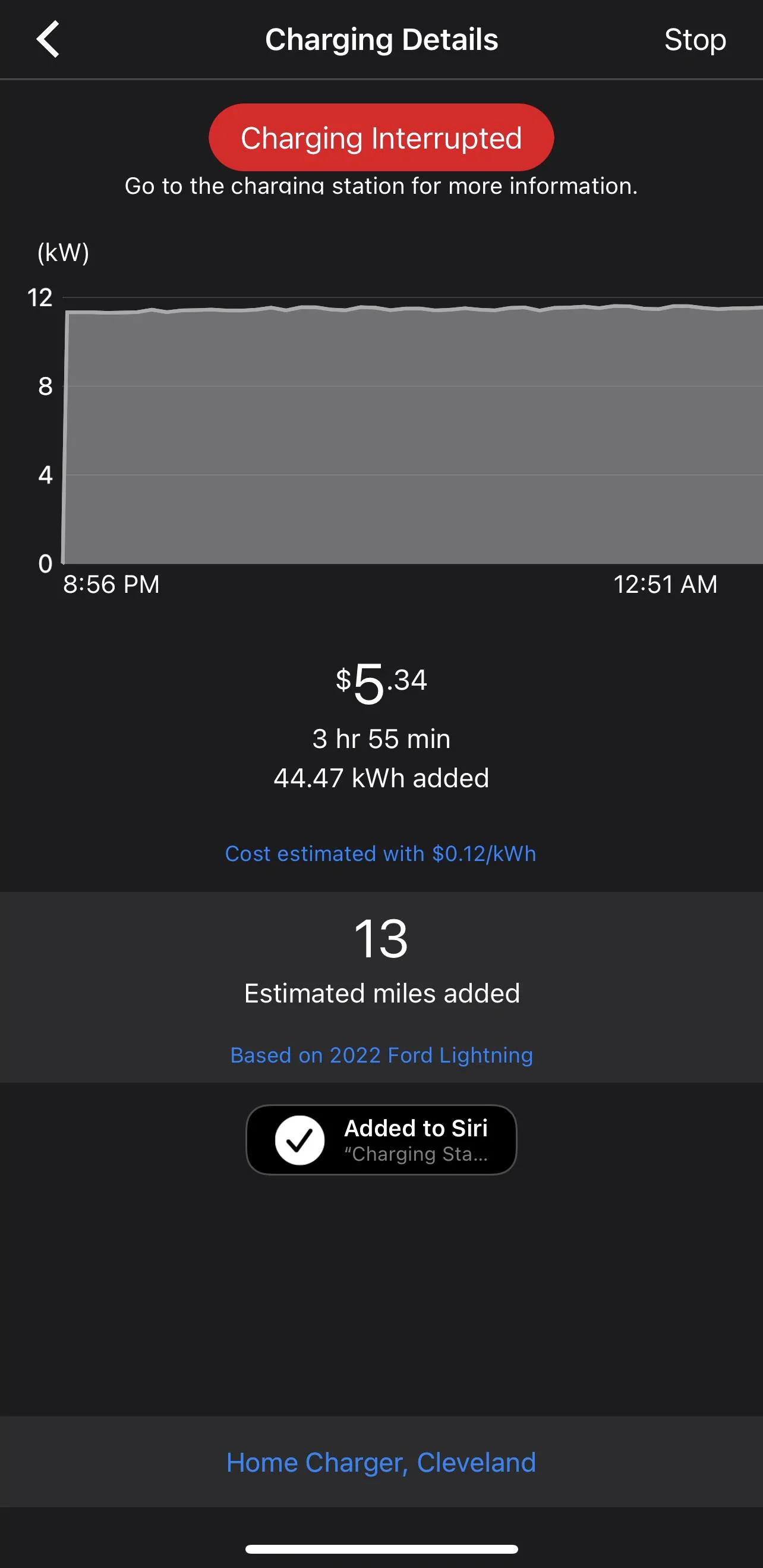

Just took delivery of my 2022 F-150 lightning ER a little bit ago. But I’ve been having some issues with my home charging that I’m not sure if anyone else is having.
So I have had a ChargePoint home flex that is hardwired to a dedicated 60 amp circuit. I have been using this charger for a year without any issues. It charges my Kia Sorento PHEV with no issues as well as my Ioniq 5. But every time I plug in the lightning it stops charging during the middle of the charge. Sometimes it goes for an hour and a half sometimes for 3 or 4 hours. But then I always get a charging interrupted (red light) and have to unplug and replug. I have reached out to ChargePoint but have not gotten any response as of it.
here’s what I’ve done to try and resolve the issues.
reboot the charger from ChargePoint app.
reset it to factory settings.
Then I tried setting the amperage to a 50 amp breaker vs what it should be set as a 60 ampbreaker.
Ive tried turning off charging locations in the F-150 lightning.
My thinking is it’s a communication issue between the truck and the charger. It charges from the included mobile charger with no problem. Any suggestions would be great! Thanks so much!

Just an update in case any others are experiencing this problem.
ChargePoint customer service identified the fault codes in my charger as “Virtual breaker detected by current coil”
They said that error code happens when you have your ChargePoint home flex installed on a GFCI breaker. However my ChargePoint is NOT installed on a GFCI breaker. The truck is tripping the ChargePoint for some reason.
After setting the amperage on the ChargePoint to a 30 amp breaker it’s working fine with no problems. I can still charge to 80% overnight so it’s not a big deal. However it is frustrating to me.
Again this same charger works fine with my Ioniq 5 at full 60 amp setting.
Also I scanned the truck with my Veepeak OBD and car scanner and there were no error codes.
Obviously charging is critical to BEVs and ford needs to make these issues a priority.
Looking forward to getting my FCSP installed to see how that goes.
Hopefully a software update will fix this soon.
