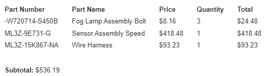

What did the modules and parts cost you for the retrofit? Were you able to source used parts?
I ordered everything new from TascaParts.com
The only used part was the steering wheel buttons which I bought from eBay.
