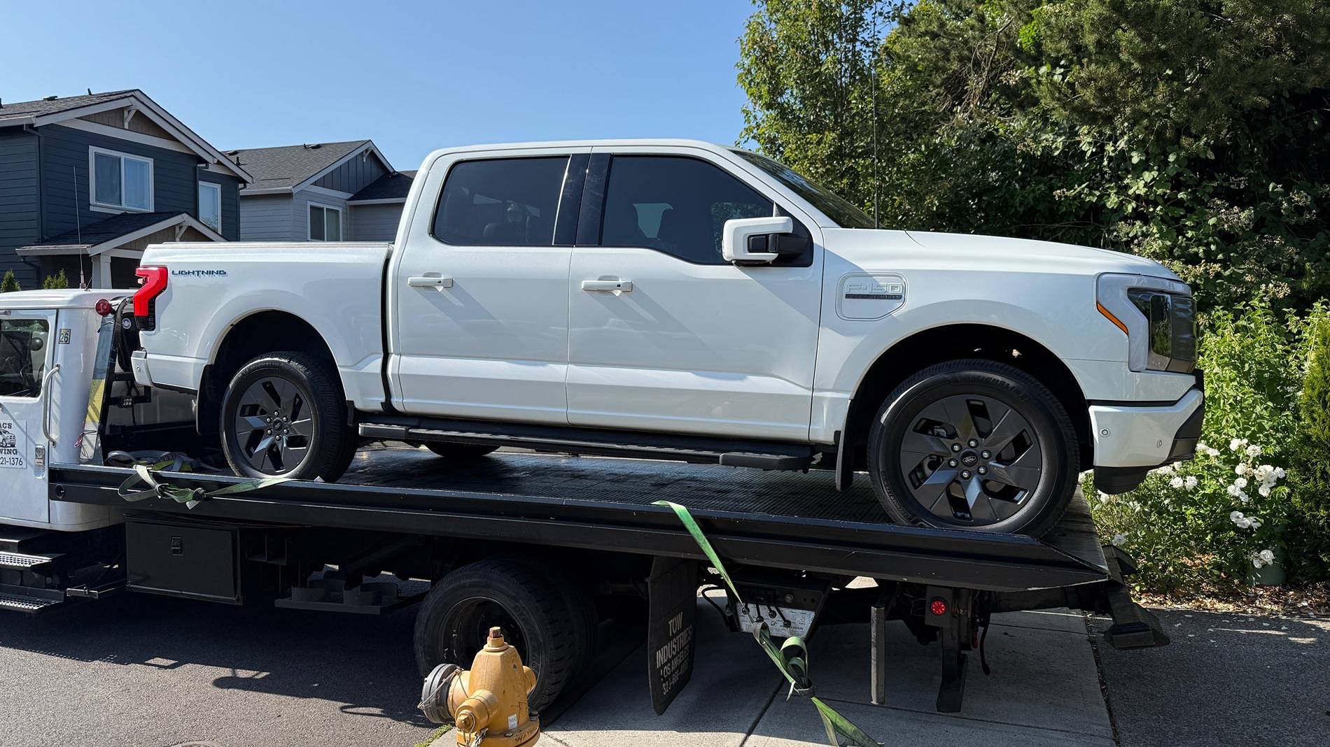

Ford F-150 Lightning Fuse/Circuit Breaker fault in traction battery IMG_5768
My 22’ lariat SR threw the orange stop safely message and wouldn’t start minutes after driving it all day and going to move the truck. My dealer tells me that a fuse or circuit breaker needs replaced in the battery. They have to drop the battery to do this once the part arrives, estimating two weeks till I’ll get it back ☹ Anyone else had this issue?
