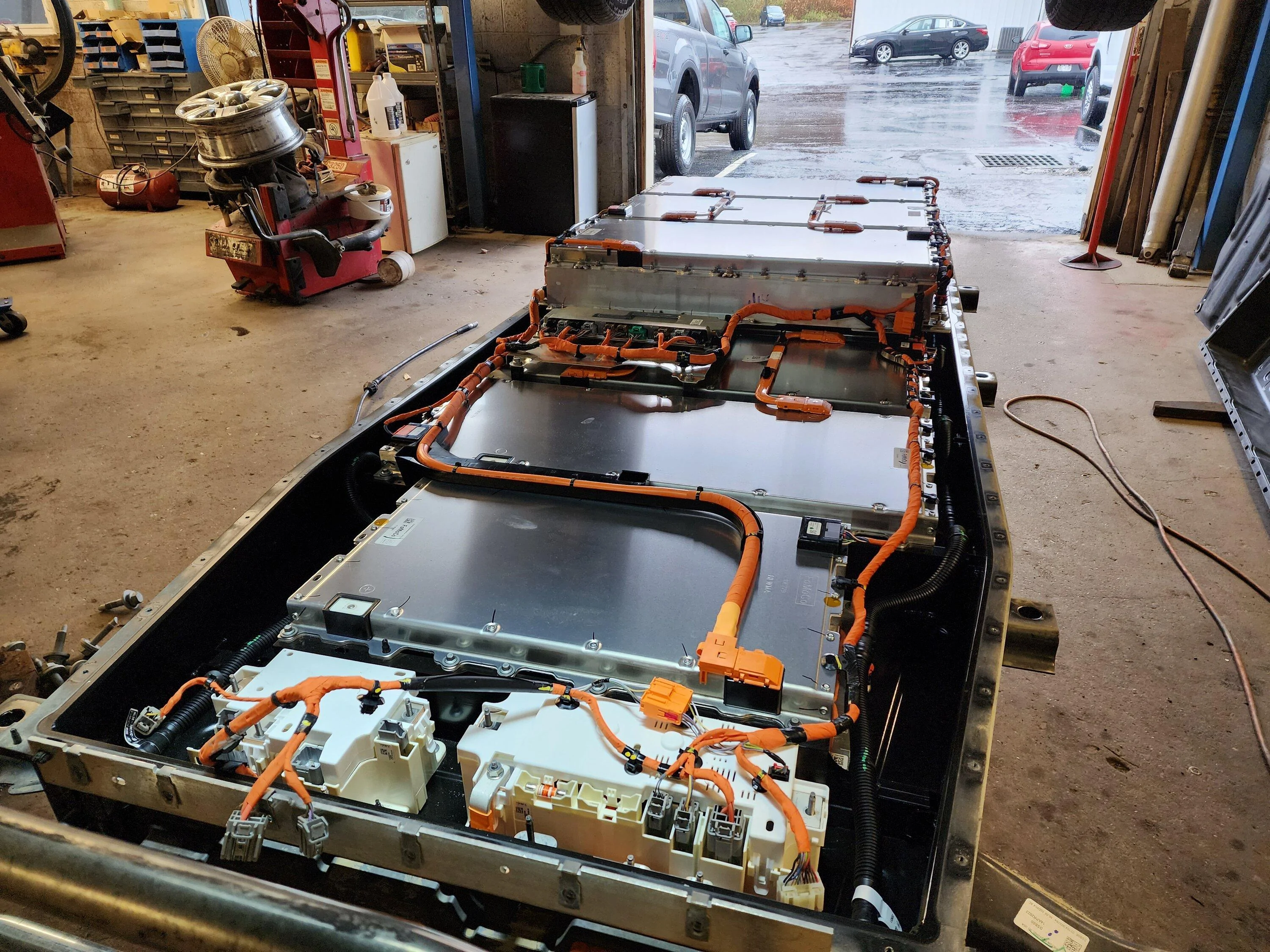

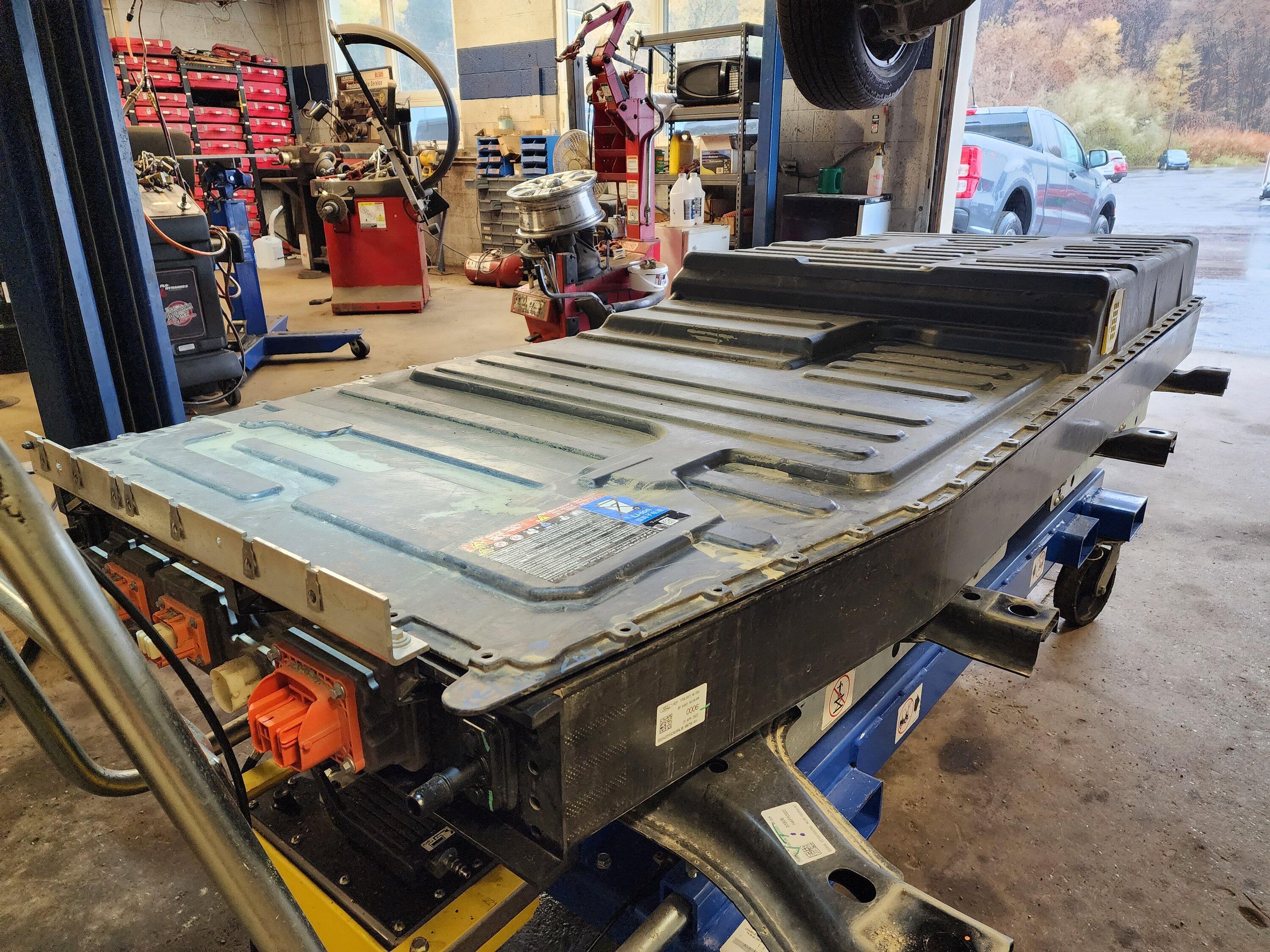

Got the truck to the dealer. They put it on the computer and it states the positive high voltage contactor is stuck. The truck went into protect mode because of this. They removed the battery from the truck and sure enough the contactor needed to be replaced. Ford emergency shipped the part to the dealer and they are currently installing the new module.

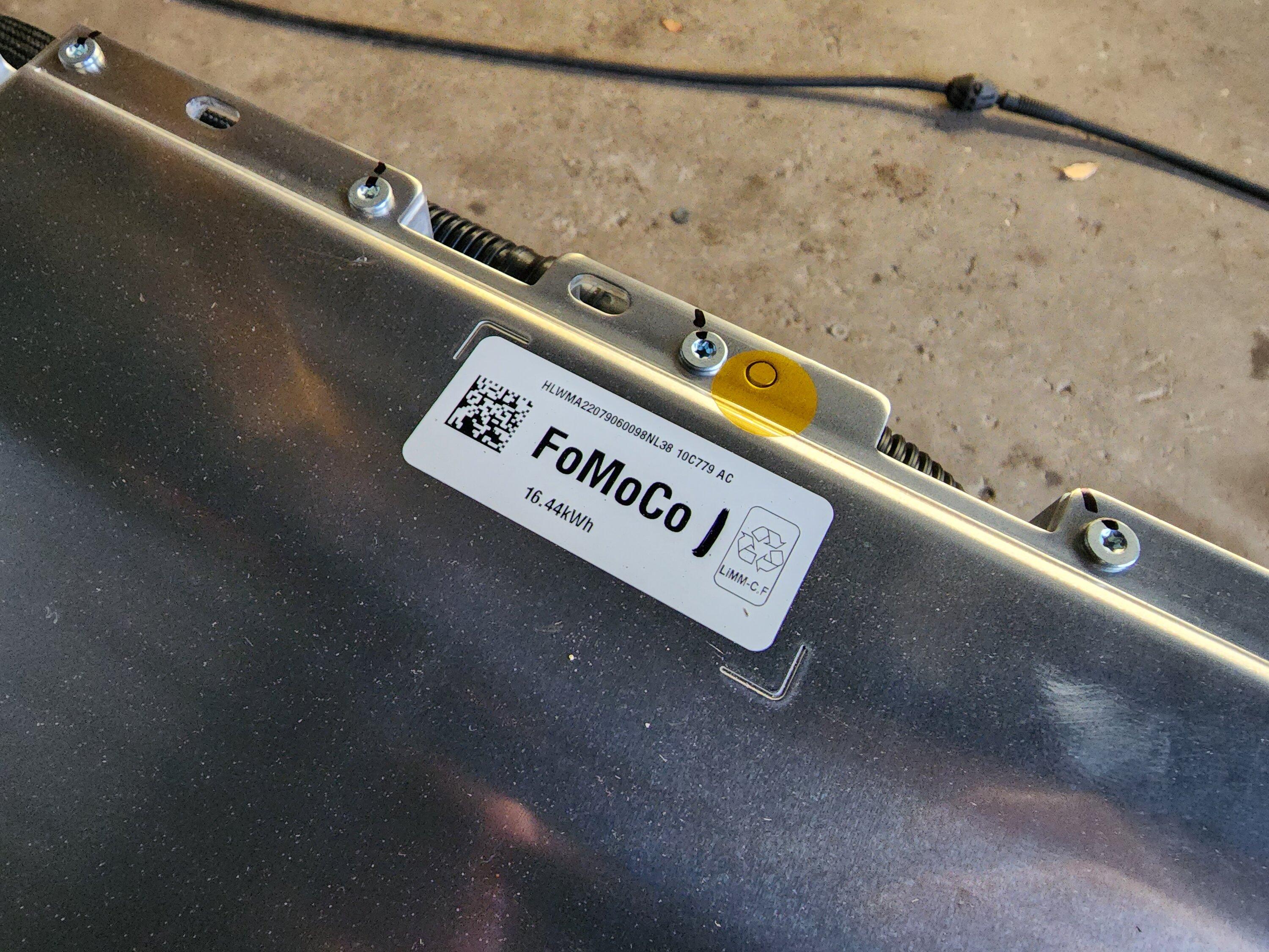

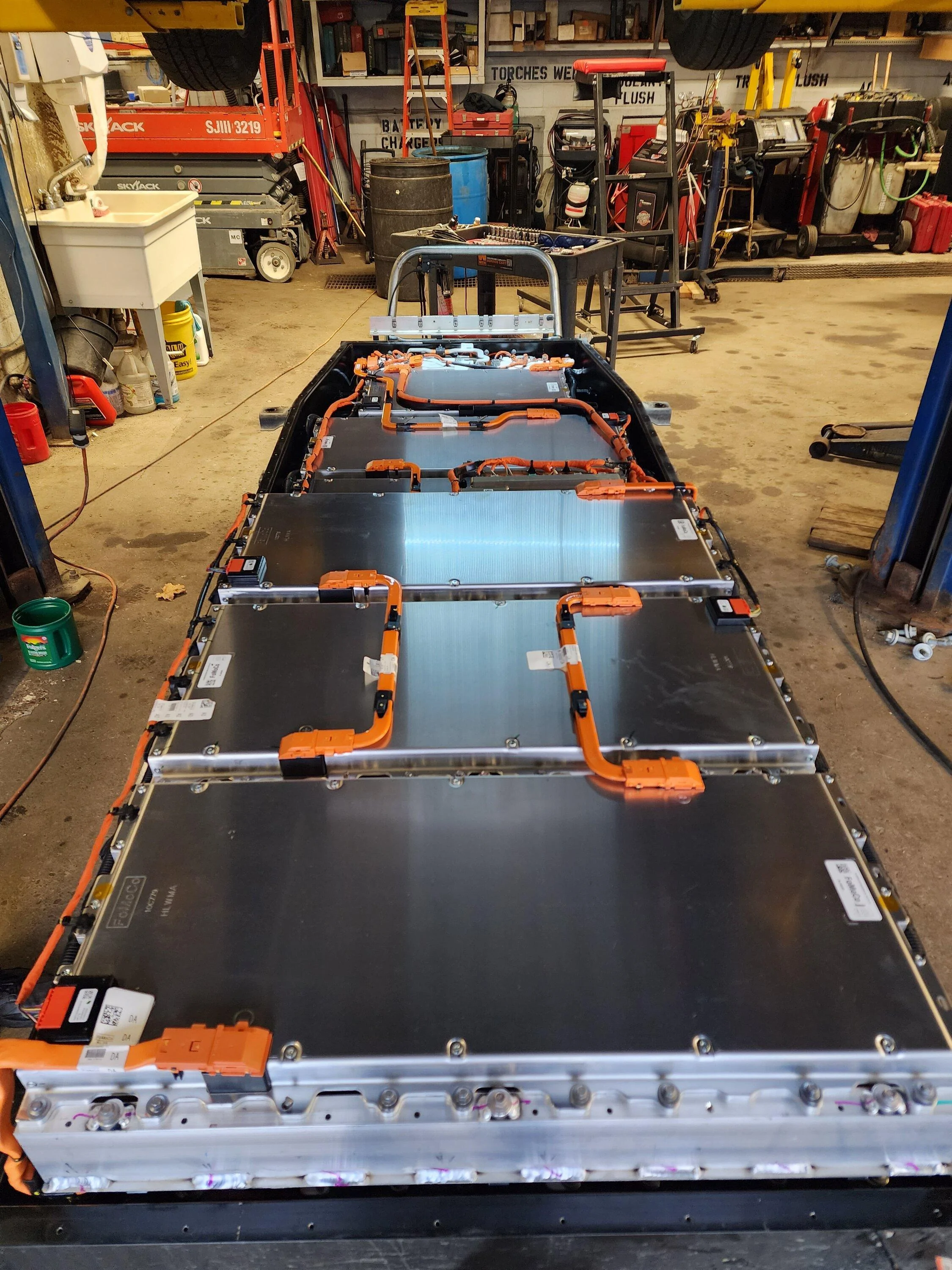

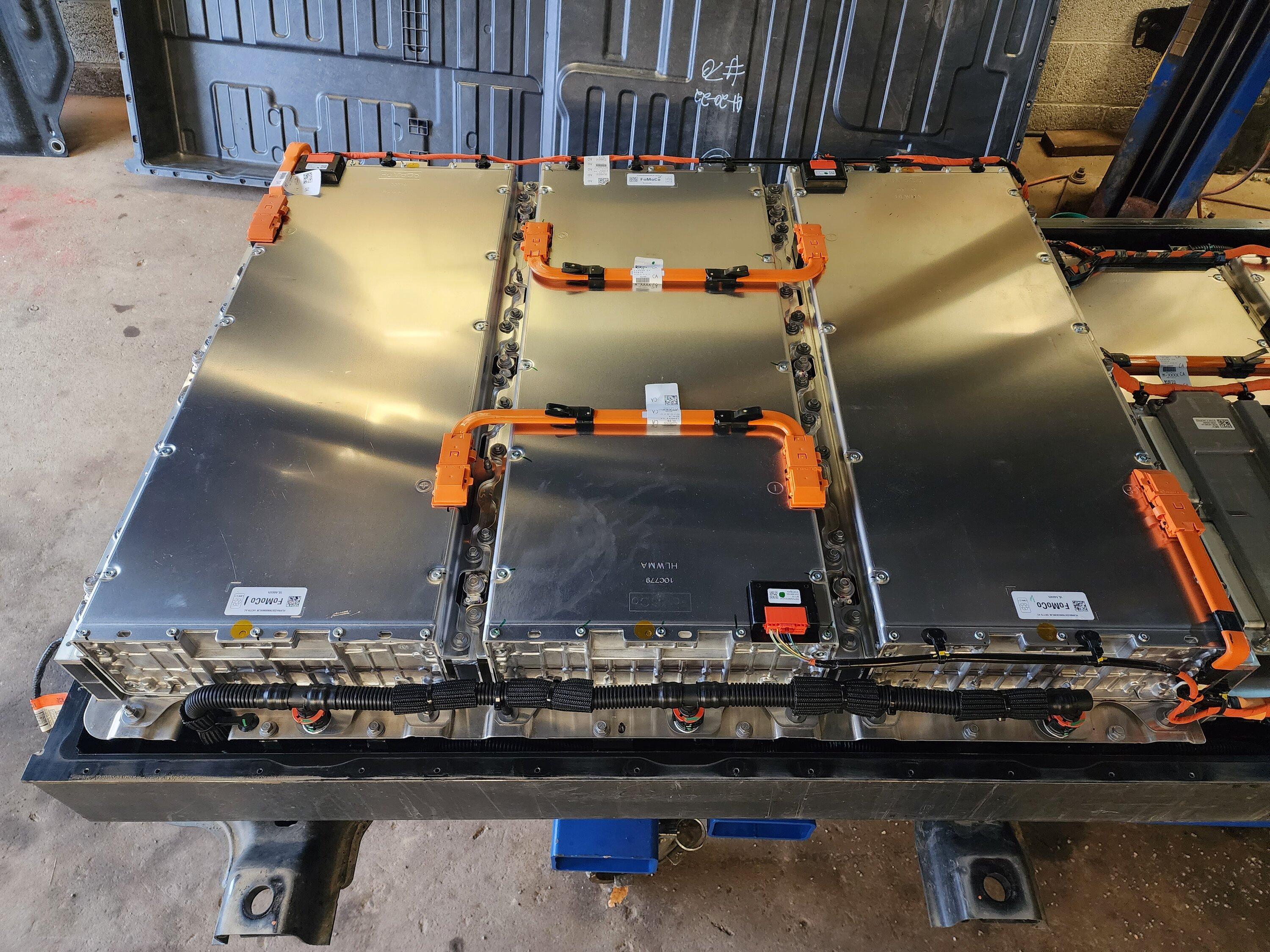

I was able to get a few pictures of the battery without the cover on. There are 8 modules that show 16.44kWh on the sticker and there is an additional battery module that shows 12.xxkWh. I have read from previous posts that the battery is larger than the stated 131kWh capacity and this confirms it!!
