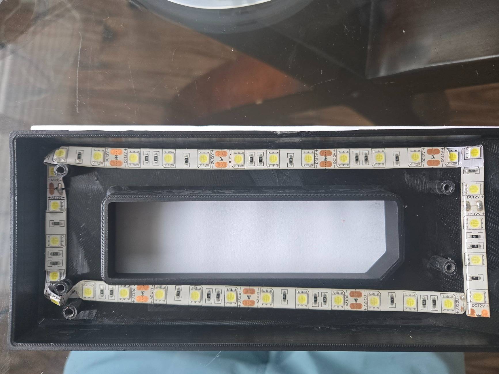

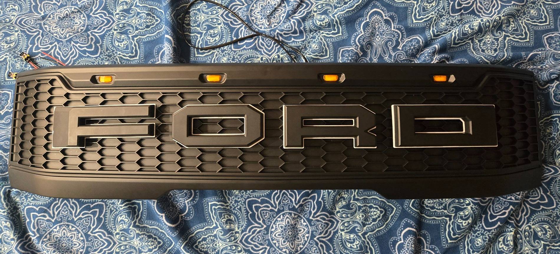

After an unfortunate incident with my original grill, I couldn't pass on the price point of this one. I wanted some subtle lighting behind the big Ford letters, so I cut some pieces of acrylic and put LED strip lights facing backwards inside the letters.
That is clever! Looks rad! Nice work??

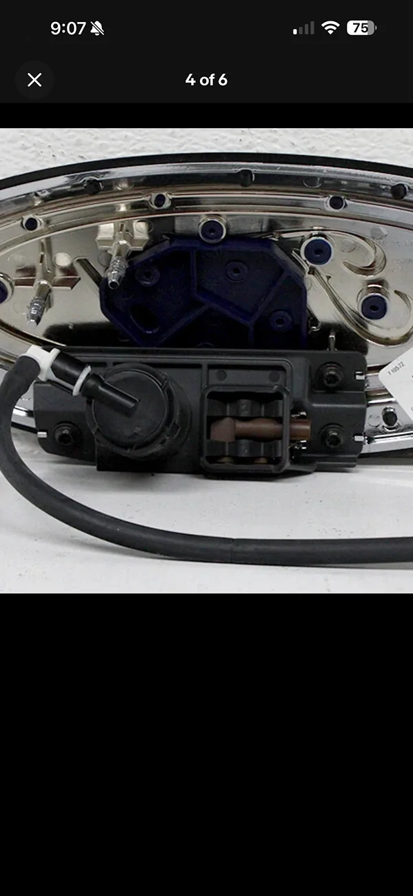

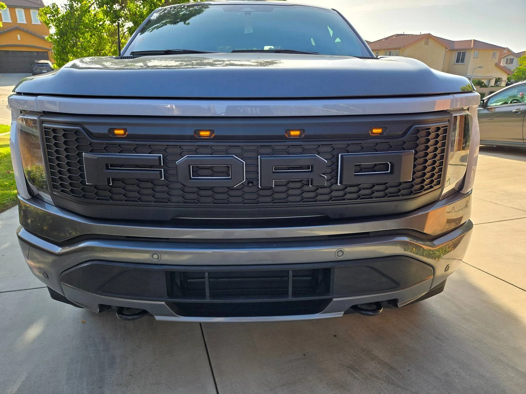

It’s not everyone’s cup of tea. But it’s different. Took a bit of modification for the camera and sprayer but I think it came out alright. My stock one is getting repainted after 40k miles of rock chips so it will be good as new when I decide to swap back. For now. I’m happy with being “different”
Where did you buy the raptor grill?

The only thing stopping me from a grille swap is an easier camera solution. I'm really looking forward to what you guys come up with. I've got the 3D printer all warmed up... ;-)
i designed and 3D printed a bracket, but I ended up having to modify everything so that it wasn't really useful. Hot glue was my friend.
