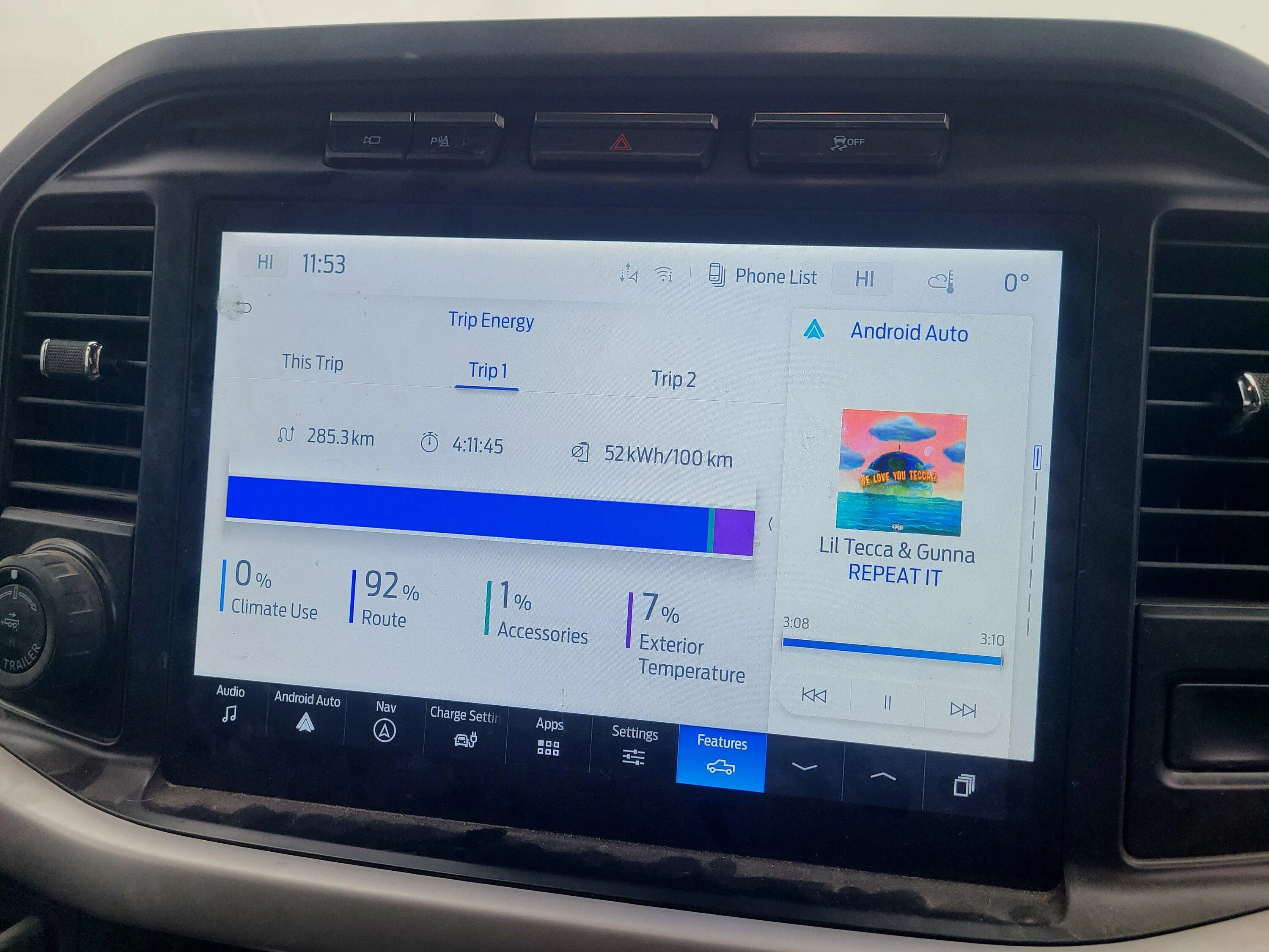

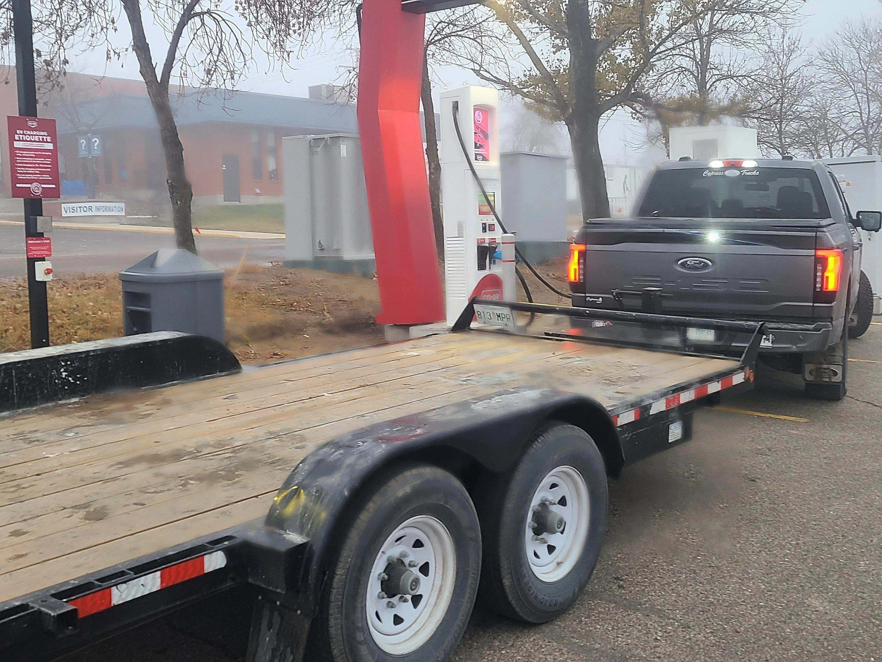

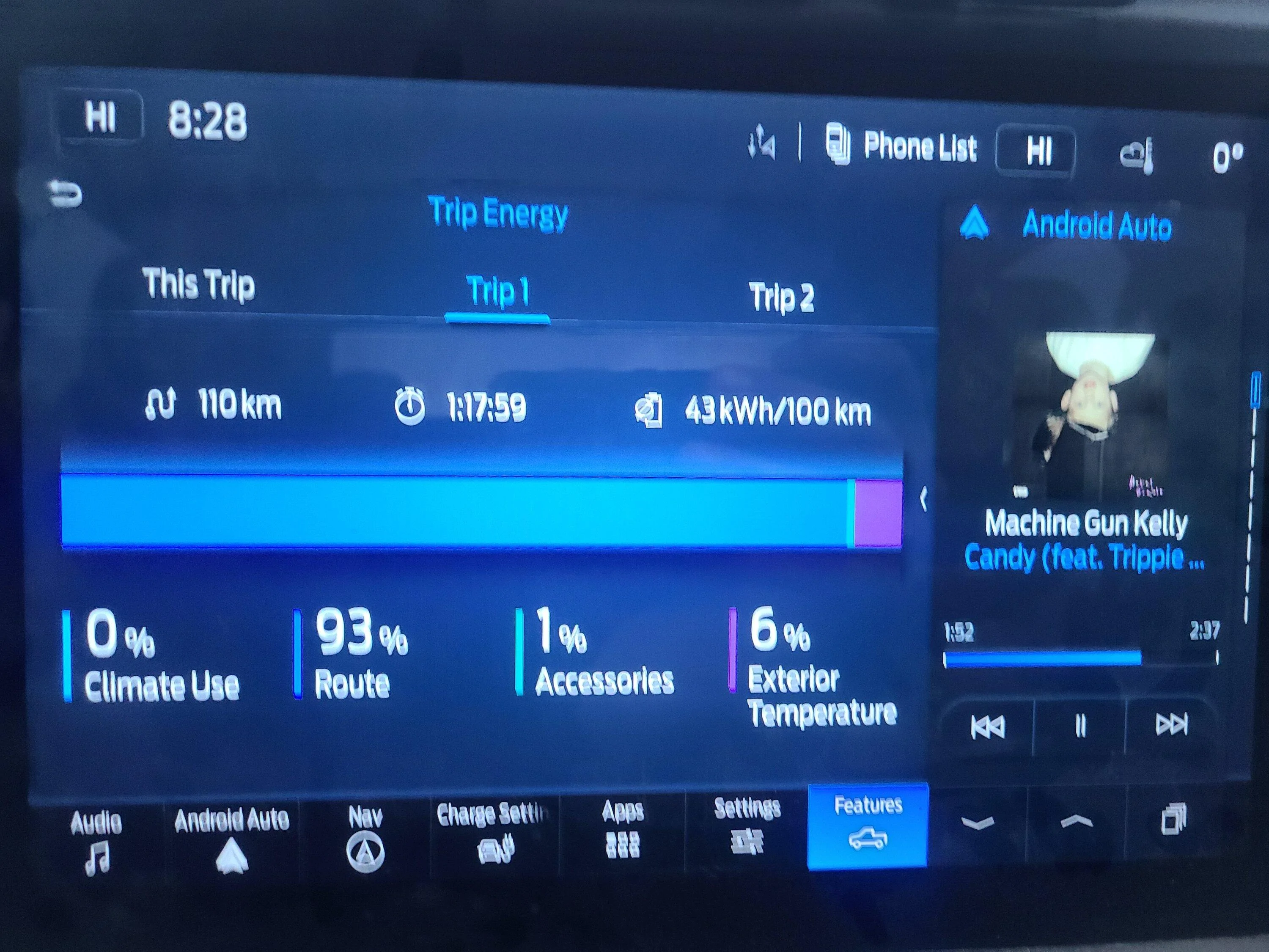

Drove 300km today in -1 used 0% of the battery using heat. But I was able to keep the cab at 25-27

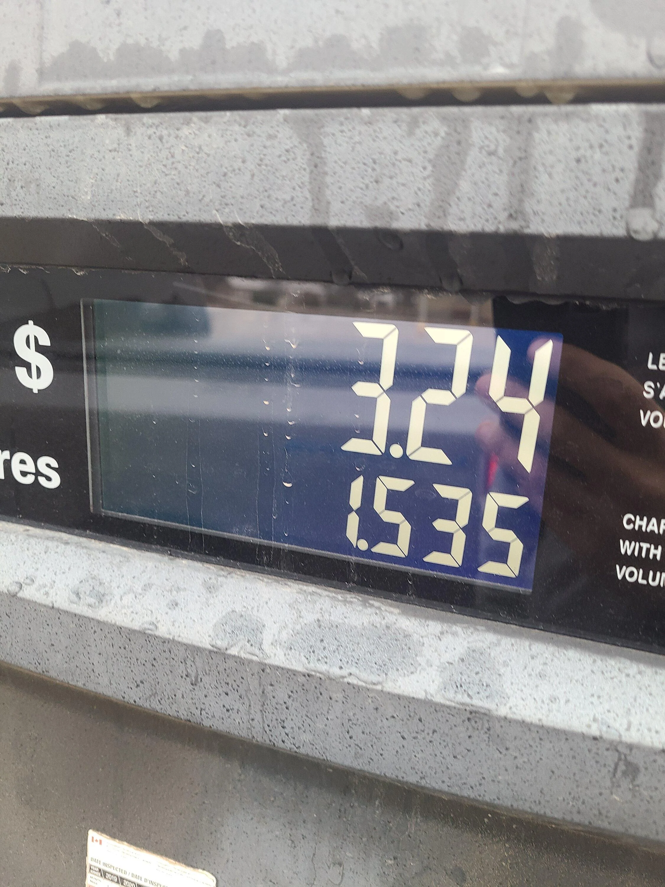

Was sure amazing in 4 hours of travel I used 3$ of diesel
Was hauling empty trailer half way then a sxs home
Still uses battery for exterior temp but it wasnt for heating the battery so not sure.

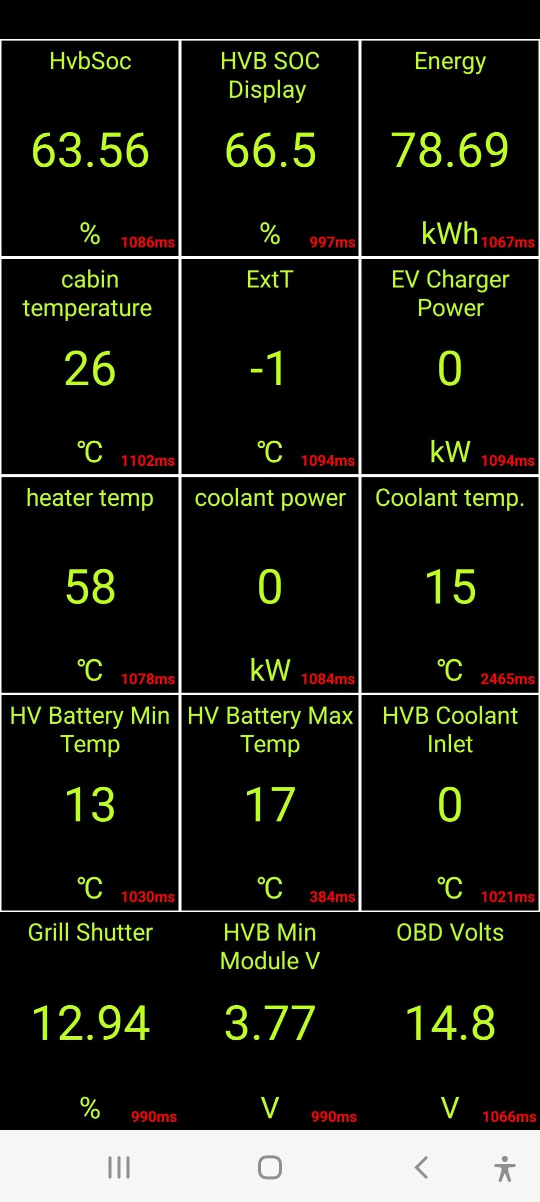

If you look at the car scanner you will se the heat at 50 ish deg but using 0kwh
