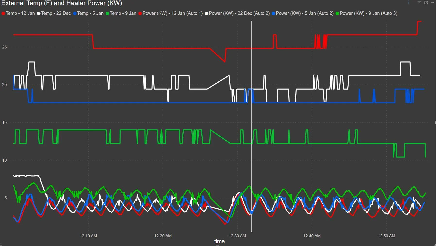

Short drive testing Auto 1 vs Auto 3 in 7 degrees F.
Ford F-150 Lightning Cold Weather, Hot Data: Heater Power Usage and Exterior Temp Screenshot_20250114_165635
Beginning is warmup as I left my house.
The second bit, 735-745, was Auto 3 at 70mph (ish).
The beginning of the third bit (747-75) was Auto 1, also at 70mph (ish). The last bit was Auto 3 again.
Thanks this is useful data.

Yeah
What is unusual to me is that Auto 1 appears to use more energy than Auto 3.
Of note, today when leaving work with cold soaked battery the heating system did not warm the battery, even though power was even limited due to temp.

Outside was high 20s (F), battery temp min was 28, max was 35, and reported "temp" was 30. Truck had been outside for 8 hours. Power was limited to 92% for my entire 20 minute drive home. Coolant Inlet temp stayed at ambient, heater power usage was only for hvac (turning hvac off had power usage go to zero). Battery temp mode was "Eq" through car scanner.
Edit. Even more fun. Just fired up the charger to see how the temp changes just charging, turned the truck on so I could monitor with the obd port. With HVAC off the heater kicked up to 8kw, even with the battery at 50 degrees F.
Not going to see much increase in SOC with the heater sucking up 8 or my 11kw...
Edit2. Temp went up to about 65f and the heater is off now

Ford F-150 Lightning Cold Weather, Hot Data: Heater Power Usage and Exterior Temp Screenshot_20250116_172009
Had a 40 minute highway drive so tracked heater usage again.
I used some portion of the drive on Auto 3, and some portion on Auto 1, switching at the halfway point. Care to guess which section is which?
I think we can see that which Auto setting you choose doesn't matter. Which makes sense, the truck is losing BTUs and needs to make up for that, how much it loses isn't determined by which setting you choose.

Did the 1 hour drive again today and the heater was a bit different. This time it started off alternating between off and max, then at the halfway point switched to what we have seen before.
Test was 70mph in 21-23 F exterior temps. Hvac on Auto 1.
Oddly enough, today there was a short burst of heating directed towards the battery.
Ford F-150 Lightning Cold Weather, Hot Data: Heater Power Usage and Exterior Temp Screenshot_20250119_101319
Coolant inlet temp vs battery min and max temp. Spike in temp directly correlates to me restarting the truck after getting setup at the local park, prior to that was me leaving my garage and driving to the park.
Ford F-150 Lightning Cold Weather, Hot Data: Heater Power Usage and Exterior Temp Screenshot_20250119_102036
