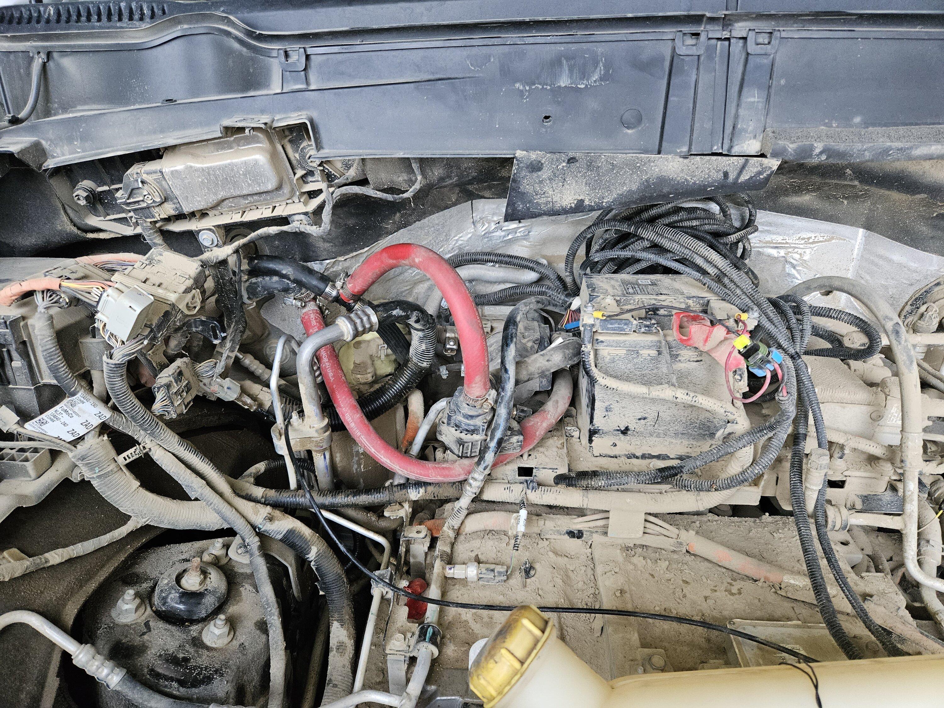

Im reviving this thread, interested in your plan for the heater this winter.
it would be really interesting to see a youtube video or much more detailed write up or schematic of what you’ve rigged here and exactly where everything is plumbed and how you have all the pipes and wiring connected.
Do you have an on/off switch in the cabin? Is the cabin heat still adjustable with the regular climate control or is it all or none?
My lack of understanding of the system, still don’t get how this heats the battery if it is on the climate control loop and not the battery loop.
If you have a long time at a destination with the truck off, can you use the heater to still keep the battery warm for a few hours?
Frankly I think this is ingenious. Well done. The previous critics on this thread haven’t lived through a Canada winter. If it works as well as you say, and your truck hasn’t caught fire yet, Ford could sell this as an aftermarket add-on and it would have huge appeal.
I took it out in the spring so I can permanently install it this fall, I can make a small video installing it. Yes you still use the heat controlls In the cab. And the webasto heater has Bluetooth so no display just on my phone

Small video of the new install leaving front off till I run it and confident I won't melt anything. So temp install diesel tank and should be fine

Heater running not sure why videos not working
Oh wow, you certainly use your Lightning in the dirt! But I'd still love to see how everything is all wired up and connected.

Sure did it's plummed into the heater core. So I just use the fan like normal and out comes hot air
Where did you end up installing the heater and tank in your final/permanent install?

It can help heat the battery if the truck calls for it. But it won't heat them driving down the road
There's been a few issues but other than that has been great honestly the biggest issue is I can turn it down. Gets pretty hot inside the truck. There has been 0 holes cut or anything done to the truck minus cutting 1 coolant hose.

Can't put a thermostat if the pump fluid goes to slow it throws errors and shuts off
