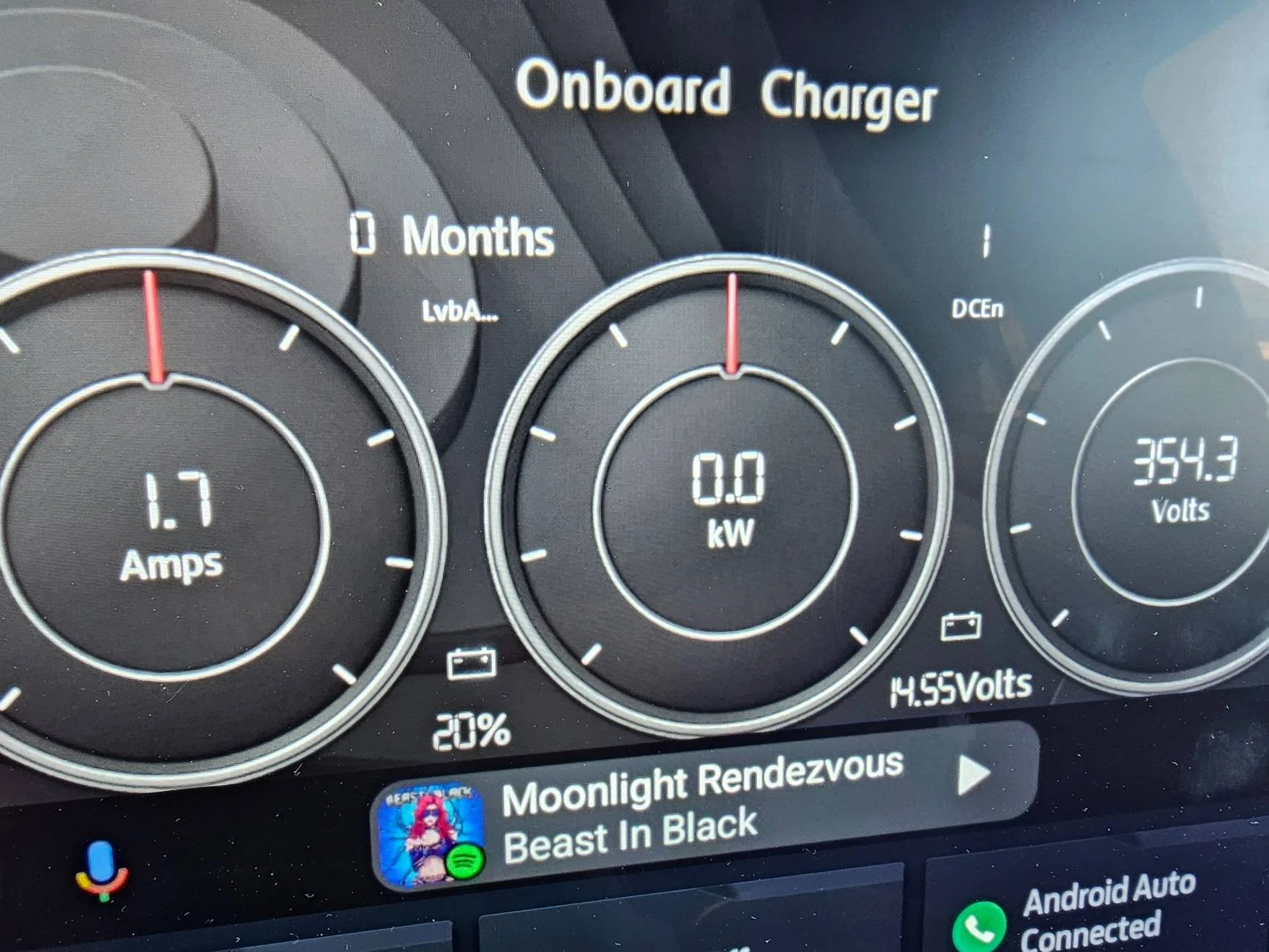

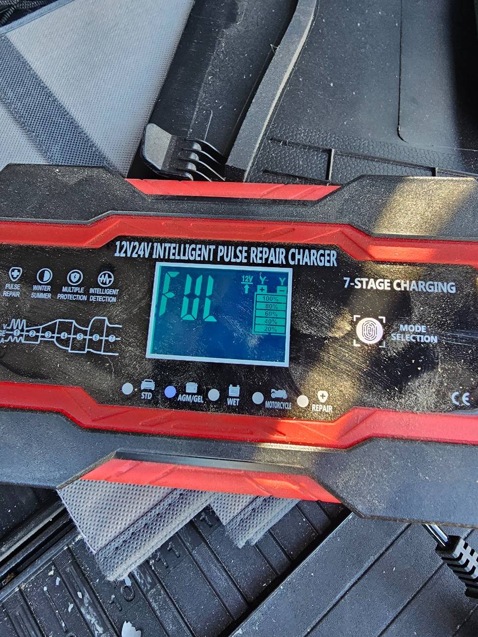

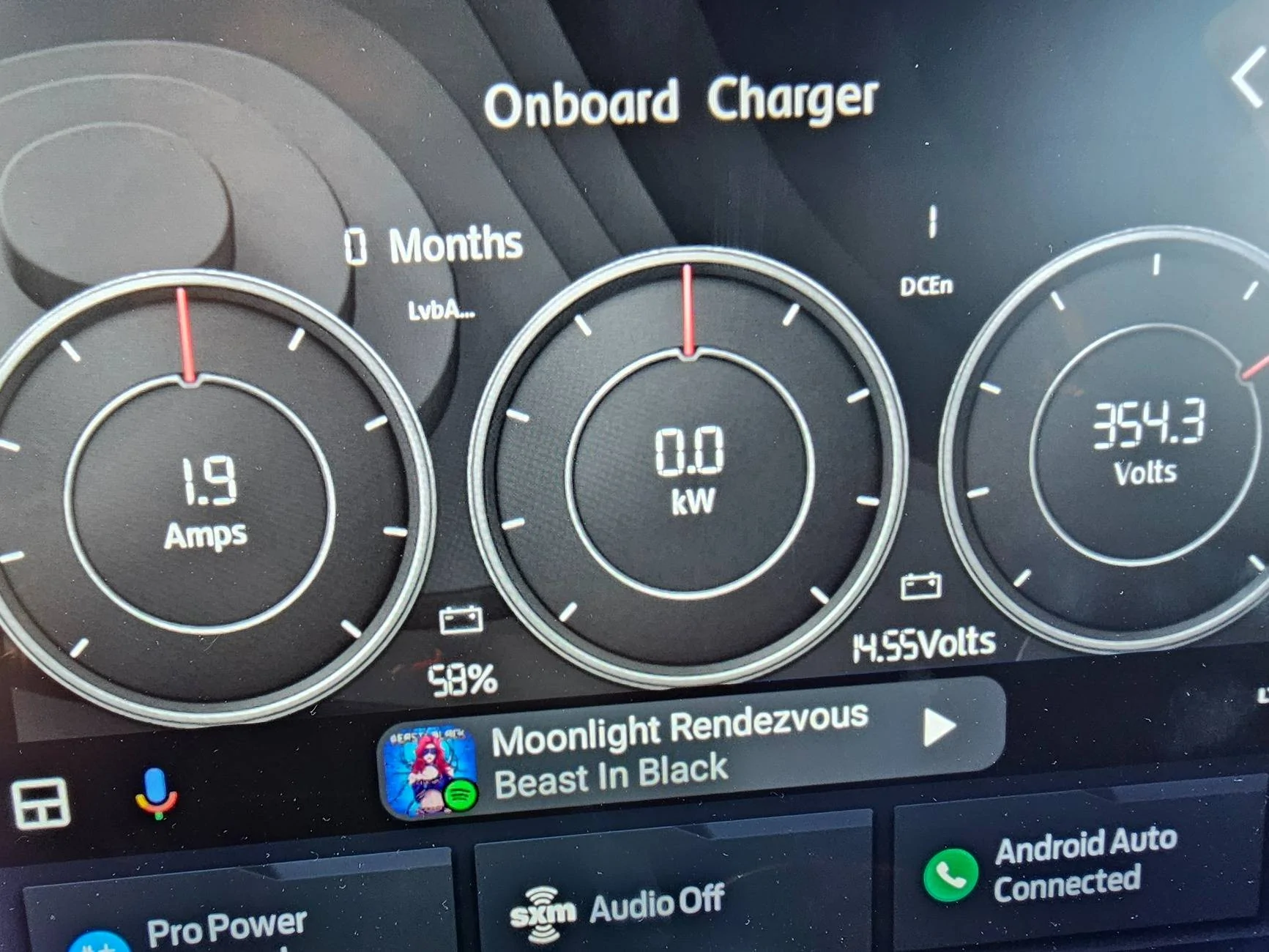

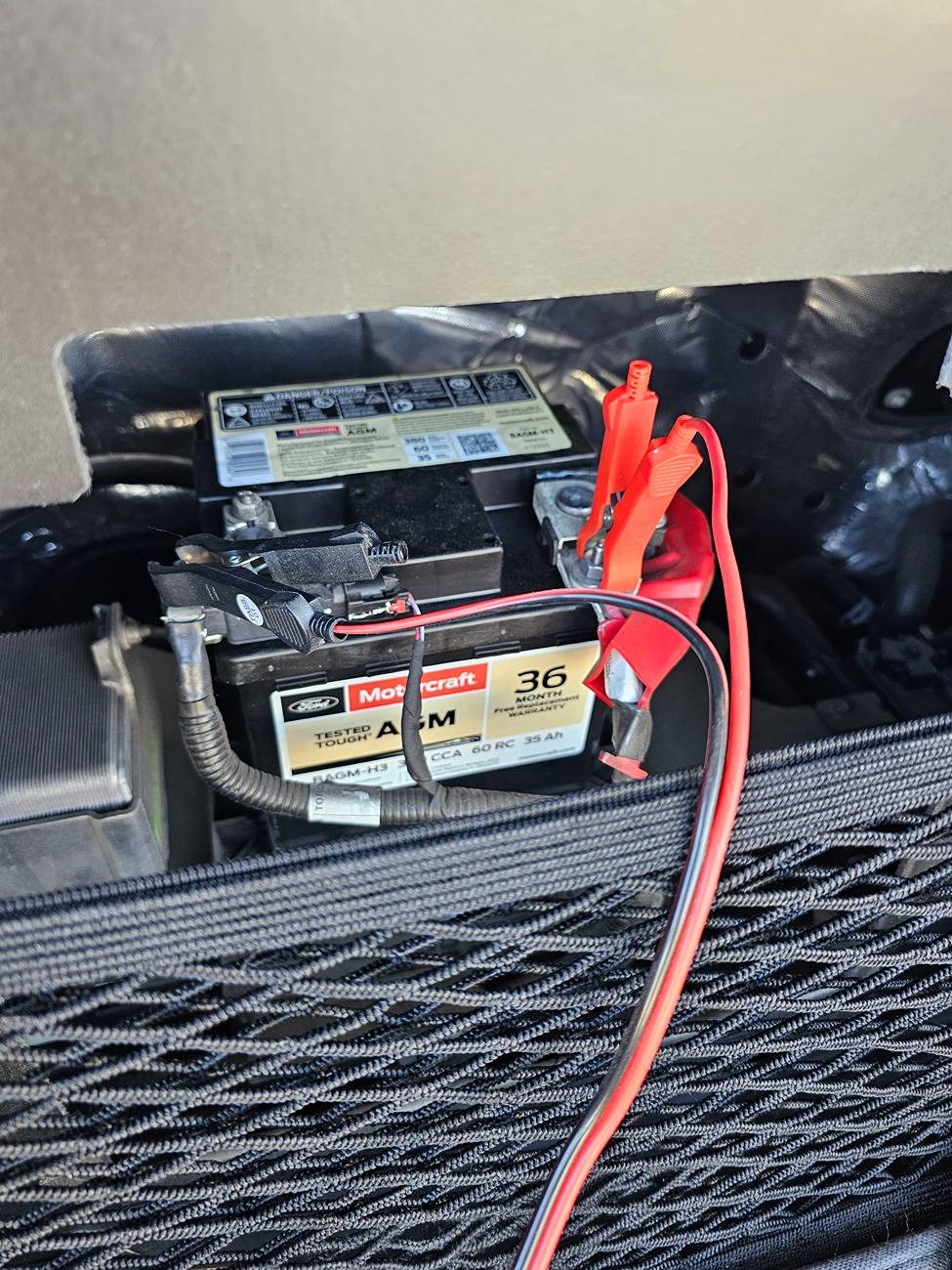

Today I plugged my OBDII scanner back in and it was displaying only 20% for the 12V battery level. I decided to hook up my charger but it would not charge and said the battery was full. I performed the BMS reset I found on the forum and now the level shows 58%. Surprisingly enough now the radio will stay on until I open the door and touching the passenger handle will unlock the truck.

Many dealers don't know they have to hookup the 12v to a power supply to apply updates. Even the ones that do know return the vehicle with a depleted 12v.
Charge the 12v using the posts under the passenger side panel, not the battery. Let it sit at least overnight. Then, reset the BMS.
14.55 volts is the charging level, not the battery. Once the vehicle wakes up, you can't get a true battery reading anyway.
Tires should be rotated every 7,500 - 10,000 miles. You should not have excess wear at 10,000 miles. I use Discount Tire.
After I reset the BMS I tried connecting my charger again and this time it did start charging so I left it for a little while, maybe an hour, and when I checked it again the charger said full. I will give it a few days and see how it goes. At least the 14.55 volts tells me that the DC-DC converter is working to charge the battery.

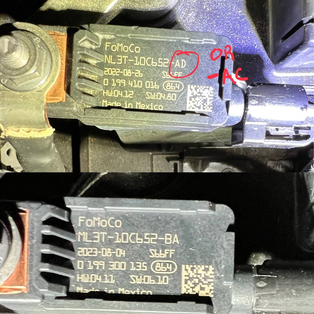

The BMS replacement CSP expired in January, that may be why it did not show up for your truck. If you still have the faulty BMS I would recommend that you spend the money to get it replaced. The part is only around $30 and it is a simple install. If you keep going with the faulty one you will have 12V problems forever. If yours matches the top picture then order the part number in the bottom.
Thank you I will do that. I checked before and I had a faulty one.
