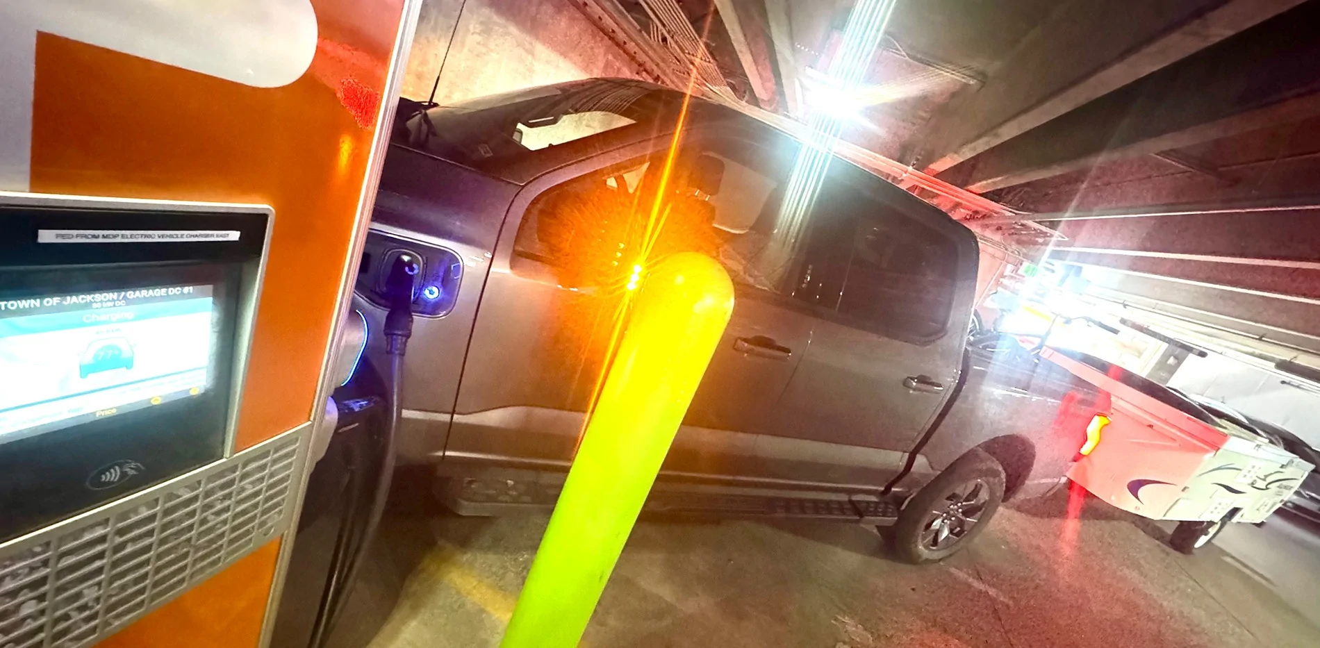

I got my truck in May 2023. It was one of the ones with the bad 12V BMS sensor module, so I suspect that it wasn't accurately monitoring the 12V for the first 18 months or so. By fall 2025, I was getting symptoms that the 12V battery was getting marginal. I would get the "old school" warning chimes if the truck had been sitting (not driving or not charging) for more than a couple of days, and I occasionally got the "system off to save battery" notice on the center console.
In October, this was happening often enough that I ran the truck (parked and locked, with climate control off and the power-down timer disabled) in my driveway for 6 hours to make sure that the 12V was fully charged. This mostly addressed the issue. However, as I was getting ready for a Christmas trip from Atlanta to just shy of Detroit to visit my wife's sister and her family, I got another warning: The truck went into Deep Sleep mode while sitting in the driveway, waiting to charge to 100% for the next day's departure. I went outside and was successful in waking it up and starting the charge.
However, midway through the trip, temperatures had dropped considerably compared to Atlanta, and I was getting low 12V symptoms even with the truck was on. Finally, I had trouble starting a fast charger (one of the new Mercedes-Benz ones at a Buc-Ees). The truck wouldn't start the fast charger, and threw a whole sequence of errors, including locking the transmission in Park. I was able to get it reset, started, and when I plugged in with the truck "running" I was able to start the fast charge.
I left the truck running for fast charges for the rest of the day, and that was successful: I was able to fast charge, and had no problems plugging in to the L2 charger at our en-route hotel that night. I carry a NOCO jump box under the back seat so I was confident I could jump-start the truck if necessary, but my wife was worried about getting stuck with a dead 12V because her sister lives out in the boonies.
I was able to locate an Advance Auto Parts on our route that had the correct 12V in stock. Then I had to locate a second one, because the salesperson dropped only battery at the first one. It cracked badly and was leaking (unusable). Swapping the battery was easy and straightforward, and we finished the drive. I reset the truck's 12V BMS at the hotel that night, and didn't have any trouble for the rest of the trip.
